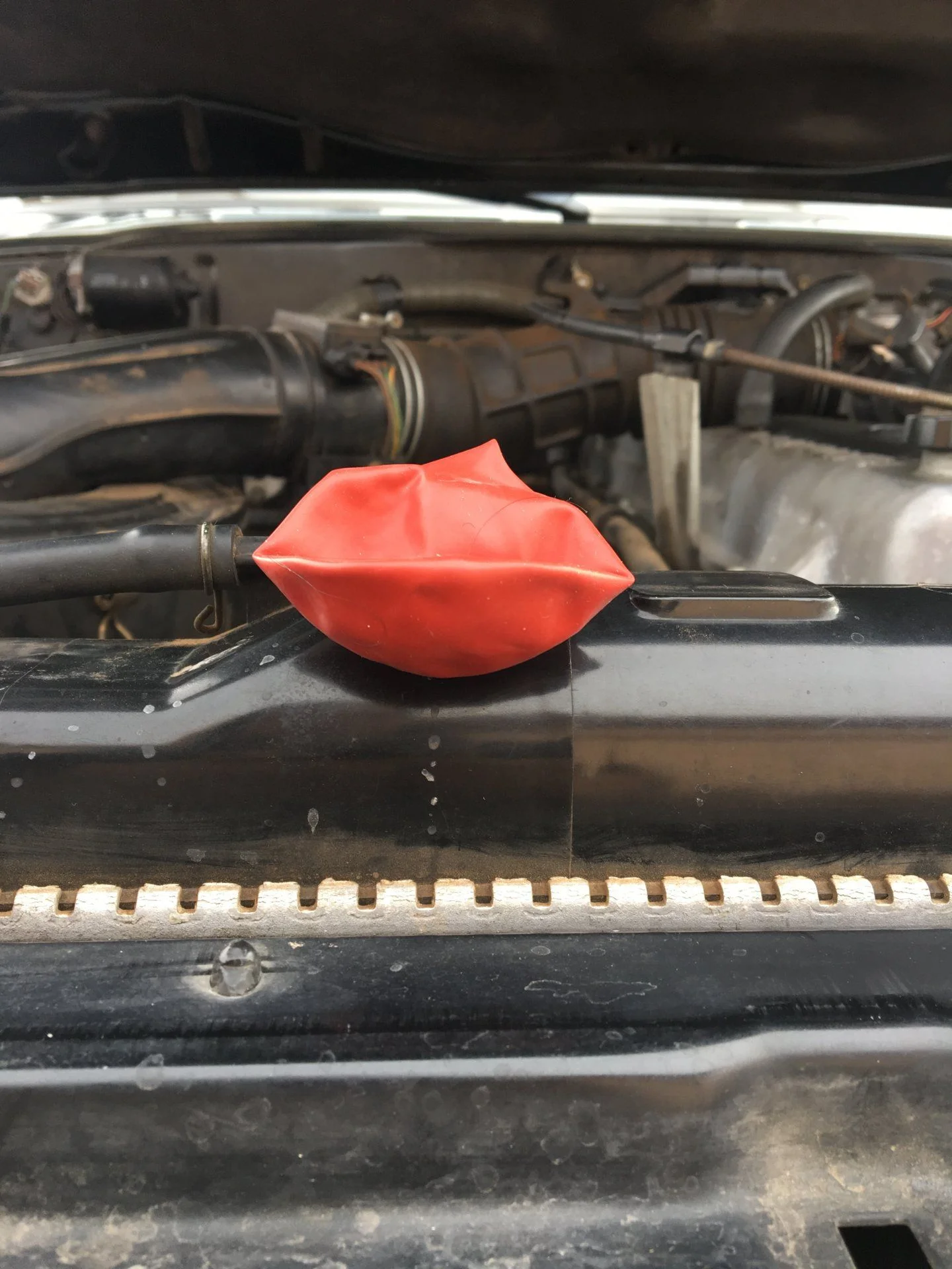

When the mechanic says the motor is blown, what exactly do they mean? If head gasket is a concern, you can check by starting truck and removing the radiator cap. With the cap removed put a balloon over the hole. If the head gasket is going out the balloon will fill with exhaust gas that is coming in to the cooling system. What do you mean by stinky start up? More info please. As far as rough idle, could be vacuum leak somewhere.

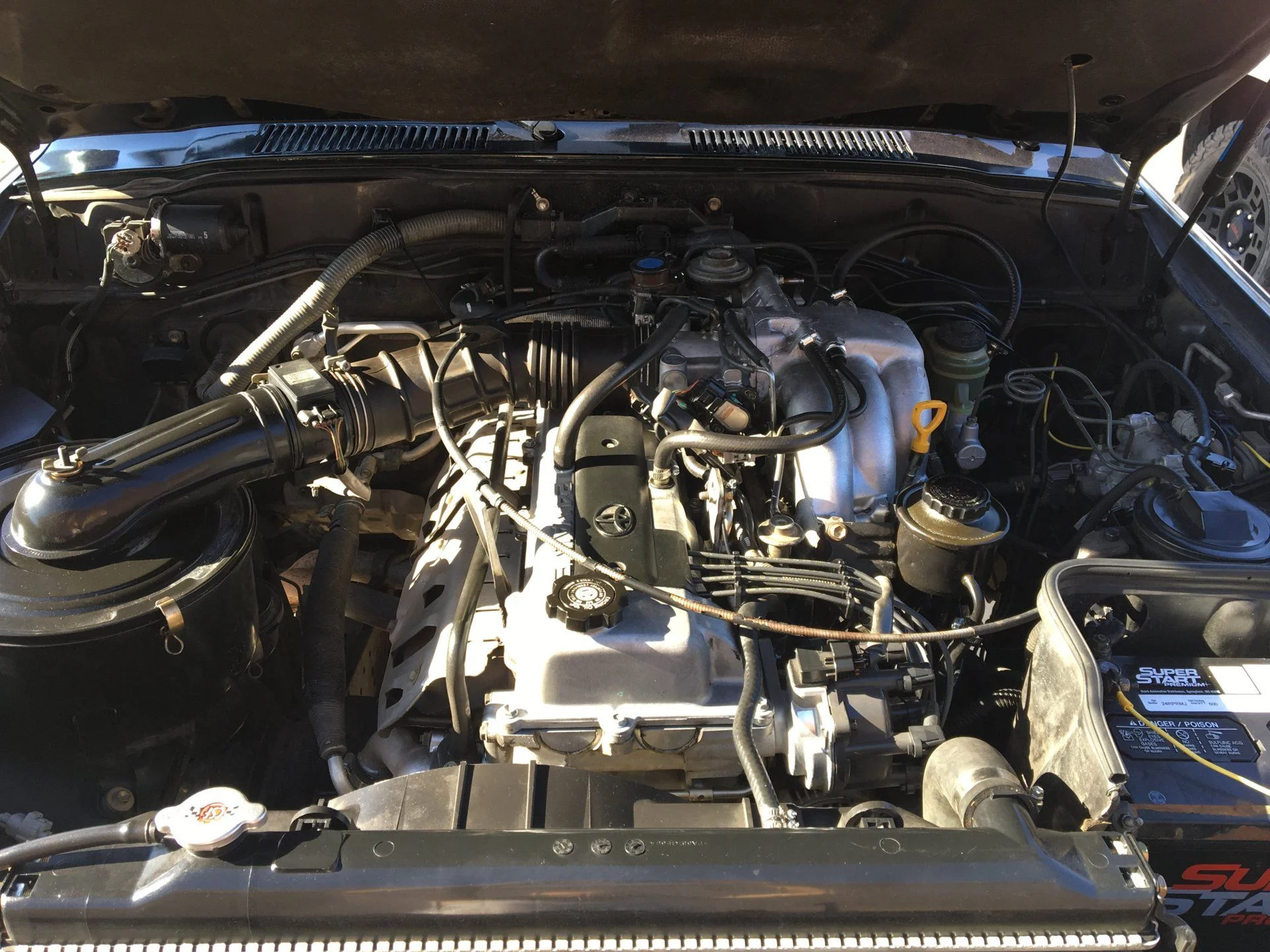

The condition of that engine bay and evidence of a new radiator makes me believe someone took decent care of this before you got it, so I would hope the motor wasn't blown.

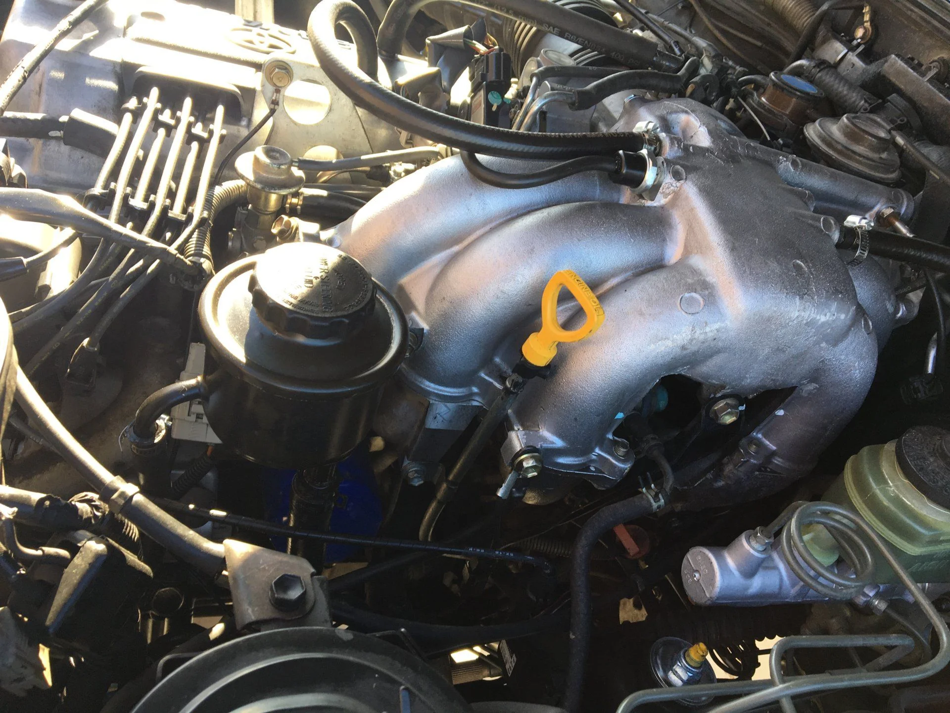

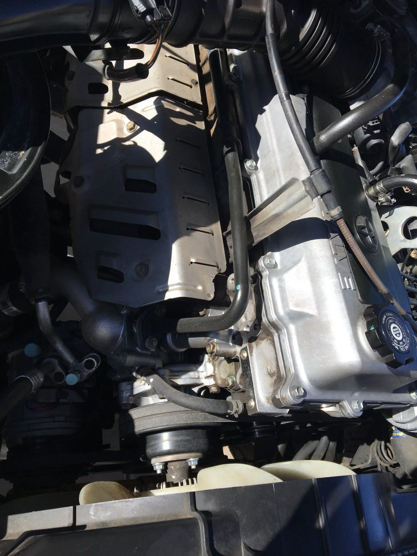

The pictures of the engine bay really do not provide any info. Just shows an absolutely normal engine. While it might have shown a particularly dirty or oily one, that would not have really given any info to offer opinion either.
EDIT: how many miles are on the truck?
Like the idea, never knew that about the balloon! Going try right now. Theee are 257,000 mi

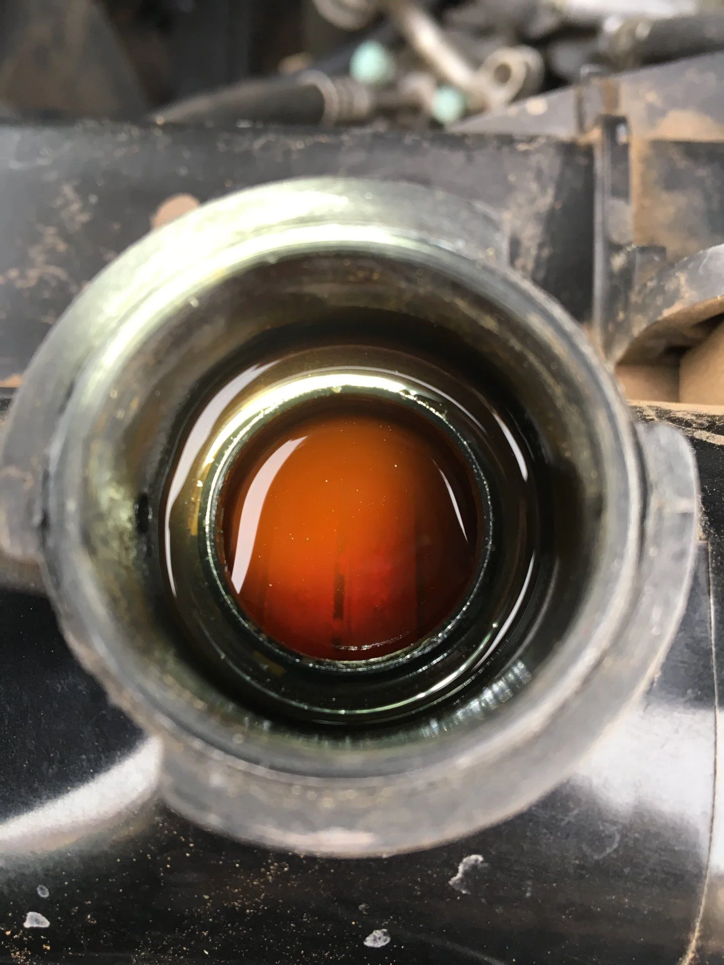

Check the radiator (make sure it's cool to tart with!) and that will be the first, cheapest round of tests.

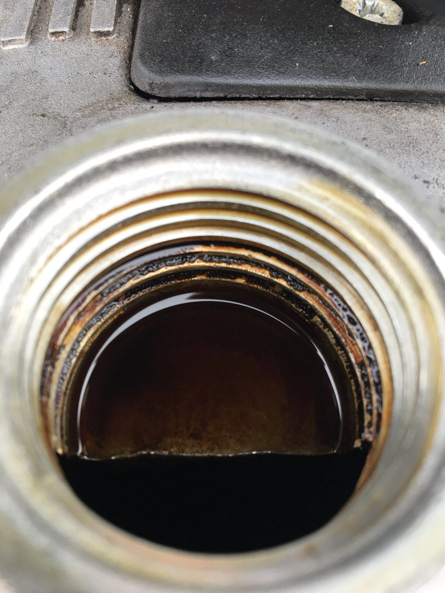

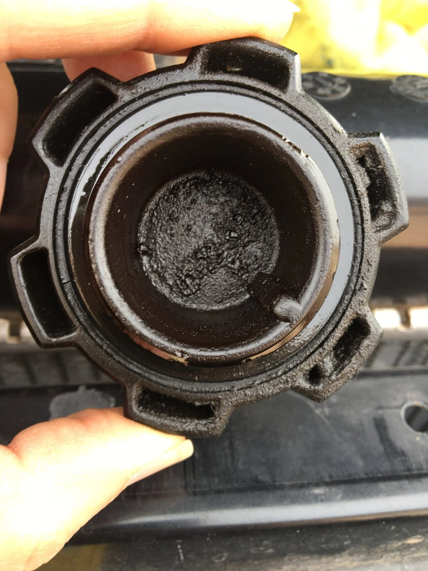

Ooh yuck! I opened the oil cap to replenish some oil, and it smells like fuel.
If it smells like fuel, you may need an oil change.
You also need to buy a new oil cap gasket (or oil cap) because the seal is cracked and will allow in some air and may cause a slight stumble at idle.
While you're at it, buy a new gas cap and power steering reservoir cap. Those will help stem other leaks as well.

Balloon test proved no air. Whew. I did not let it get up to operating temps though.

Smells like fuel? Or smells like exhaust/burnt fuel. Exhaust/burnt fuel smell is normal. Just combustion gases that get by the rings.

Oct 20, 2010
72
I would get another mechanic to take a look at your cruiser, I would do an oil change, a radiator flush, pcv valve, spark plugs/wire replacedd and make sure your cat converters are not clogged up!
By looking at your beautiful stock 4.5 liter 1fzfe engine, it looks very healthy from pics!!!
Your rough idle could be as simple as your spark plugs and wires to the distributor!
Those items I’ve mentioned are common maintenance alongs with driveshaft u joints lubrication.
The pics of coolant and oil cap are normal, fuel smell in the oil cap is normal as well don’t be disturbed my those things, your Fj80 is built like a tank!!!!
