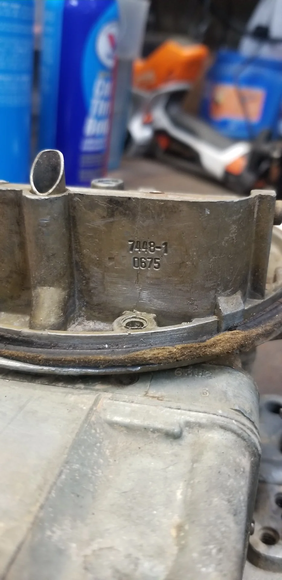

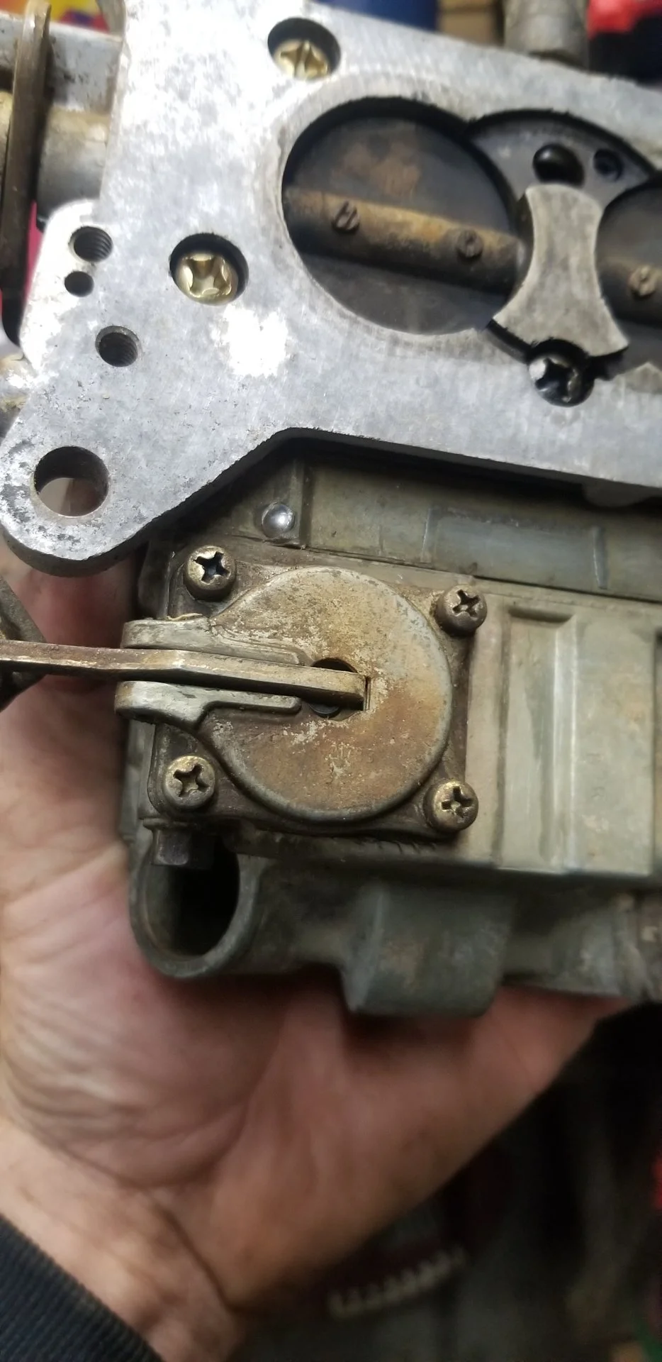

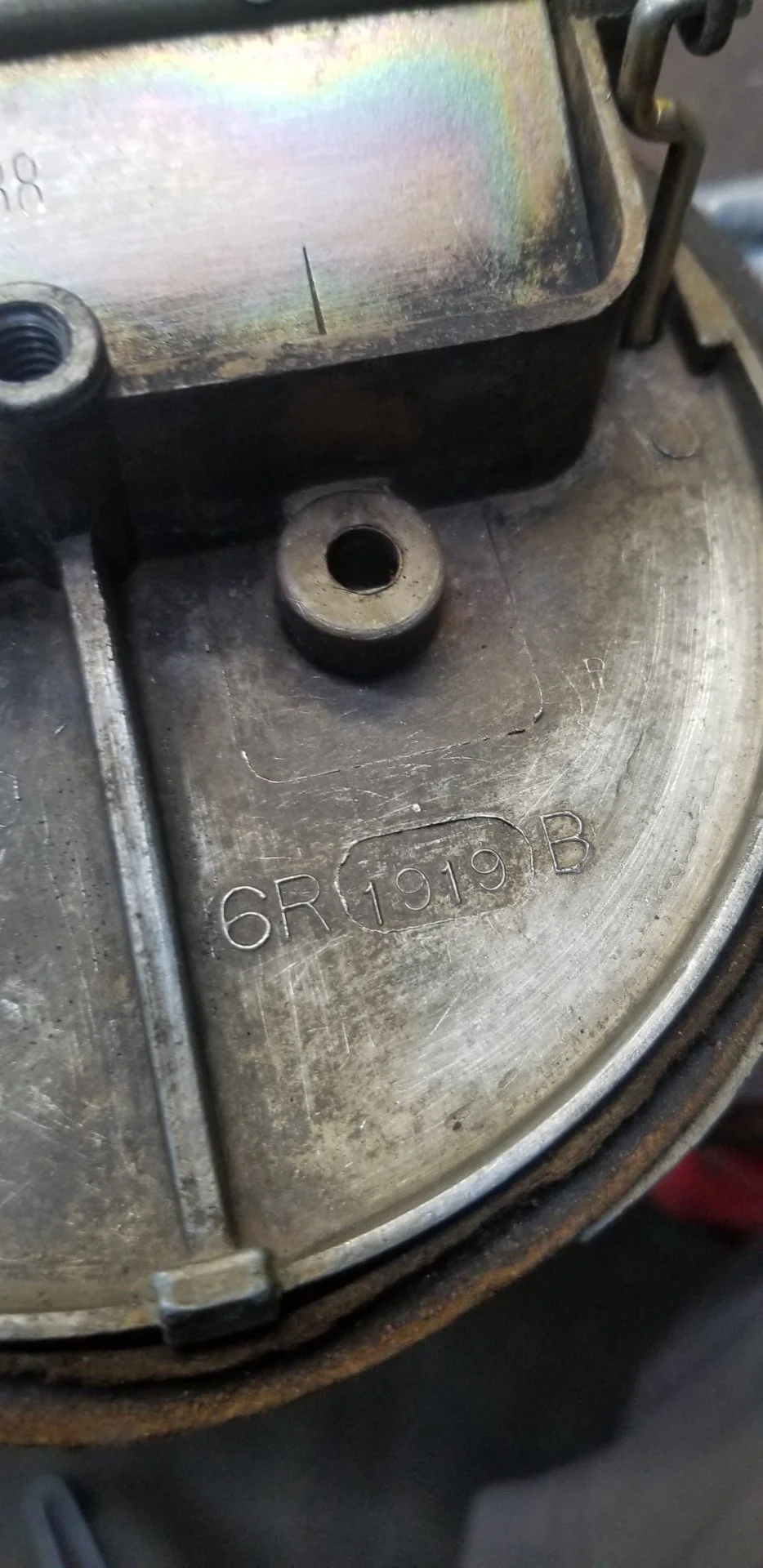

Having the hardest time tracking down a re build kit for this carb. Want to make sure the parts are correct, all of the serching i have done has been wishy washy at best. There is two that come up the 350cfm, and 500 cfm. And another consistency is the 2300 number. Carb Was on the vehicle when i bought it. Engine has been de smoged, and this carb has been running fine, but is leaking fuel from the throttle pump. Any help is greatly appreciated.

I think it’s a Holley 7448-1.
It’s doubtful anyone here has that carb on their 60. It’s a 1975 model carb.

Oss, i am dumb lol. They had all the stuff at the local o'rileys. Problem solved, new accelerator pump diaphragm installed no more leak. And to boot the truck is running great! Thanks for the gentle reply 🤣
