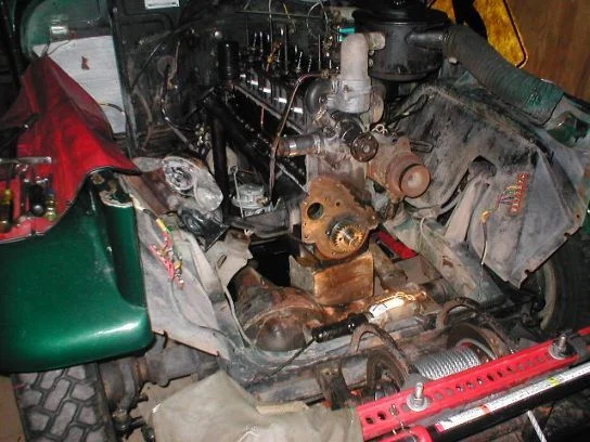

Maybe I'll fix that annoying little leak......

coming from behind the timing plate. :idea: One week to go before we hit the trail at CMCC. :eek: I was moving right along until I went to pull the cam........dang PTO winches. :doh:

You sure are a glutton for punishment! ;p Not that I've ever done anything like that... :D
BTW: I don't recall seeing a PN for those terminal strips on the fenders. That some 25 specific part or a PO specific part? ;) Or is that how you know someone pulls the bib off their 25 far too often?! :D

Nick, the terminal strip number is actually an early 40 part......it's on my list. A real purist wouldn't use them though because they're philips head screws instead of the original flat screw heads. ;p
I was really bummed when I had the cam half out...thought I was going to have to pull the winch.....until I jacked the motor up. :idea:
