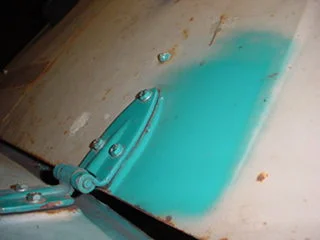

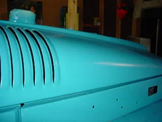

Ace Hardware Safety Blue is the dead on Match to Smurf Blue. I did my whole truck for 40 bucks.
I bought A case of it online. Still had 2 full cans left over for touch ups
the hood hinge is OEM for comparison.
Cheers
