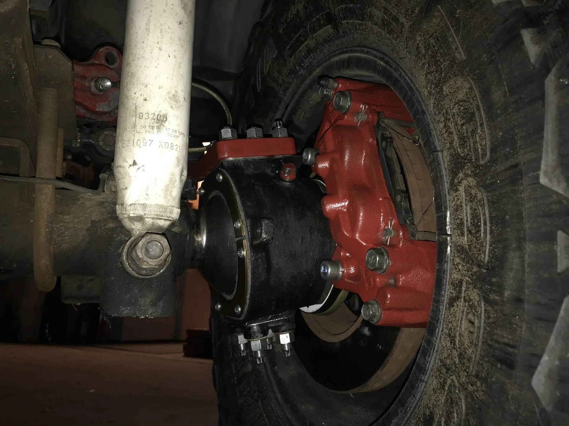

How do I verify the distance between the master cylinder and the booster? I think it is one of the last things I need to check.
Brake Specs:
FJ62 front axle with IFS hubs and rebuilt Tundra Calipers (stainless lines at the calipers).
FZJ80 stock rear axle with oem stock rubber brake lines
Inline Adjustable LSPV (stock LSPV deleted).
T100 booster from the parts yard used
T100 master cylinder bought new (advics / aisin)
Years back I had TLC aluminum front calipers with the T100 booster and cylinder and the braking was good. Then I scrapped em out since I snapped a bleeder screw and the aluminum threads were toast even after trying to fix em. Ever since I've upgraded the brakes since then I am unhappy with the performance. I assumed that the tundra calipers up front and the rear 80 stock calipers would finally match the master cylinder bore and volume.
I did a quick bleed of the front after pulling the old calipers off and installing the tundra calipers. When I do this do I need to bleed the entire system again or just the front. (I did not bleed the back.)
I think I will replace the old rear lines since I'll probably bleed the system again. Currently the brakes are ok but cannot lock up the brakes from 15mph. The tires are 35" BFG KM3's E class and heavy!
