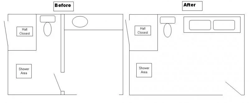

Here's the plan...
1. Take down the wall that divides the crapper/shower and sink and open the area up.
2. Put in a double sink.
3. take out the shower pan and build a tile pan.
4. Put in a heated floor.
5. Repair the floor due to water damage.
6. Run RJ45/HDTV cable up the wall for placement on the other side. This will give me the ability to put a flat screen on the wall in the bedroom and not have cords running up the wall.
Here's the plan.

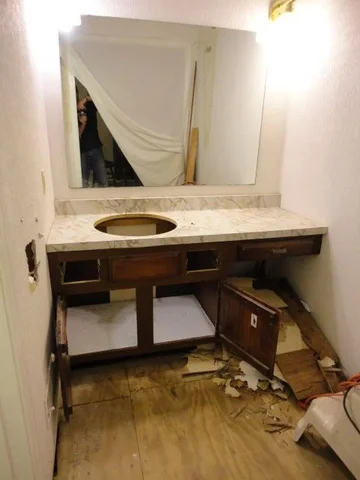

Sink/vanity.

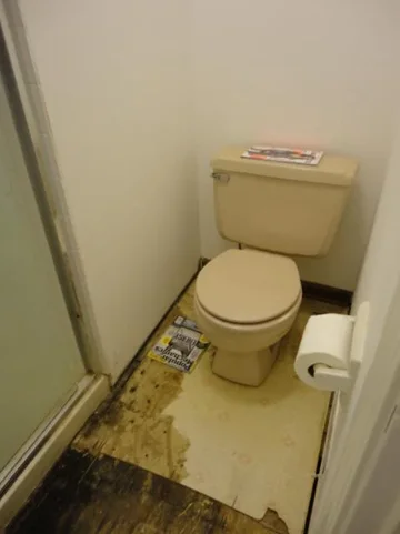

Crapper and shower area.

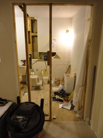

Some more pics.
Door Frame.

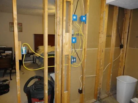

Junction box hell. Needed to extent the wiring.

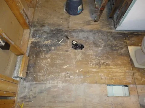

Relocating the duct work from former location and main floor water damage.

I seriously considered 86'ing the closet and being a man I thought value added if I installed a corner jacuzzi tub. But of the women I spoke to about the remodel they all said keep the closet for linen and towels. For the MB towels I plan on getting an Ikea closet. If I really want to enjoy a warm soak then I can get a Jacuzzi on the back porch.
if the hall closet is big enough you could do built in shelves off the shower end for all your soaps and a small linen closet next to the toilet and toss the ikea and still have enough room for the hall closet...find a good tile guy and do a walk in shower with a bench built in...Steve has the right idea...good luck.
Well apparently the junction boxes INSIDE a closed wall is not code. The Junction boxes have to be accessible. Therefore I'm putting the boxes in the ceiling. I'm going to have it inspected before I put the walls up.
I'm pausing to consider the walk-in shower with multiple heads....The bathroom box space is 7' X 10.5'. The closet is 2.5'X2.75' within that box space...if that gives you a better understanding.
yeah, nix-a on junction boxes, you don't want your house to look like a bonfire. Google the large showers, I've seen some really neat ones here with two open ends and a glass wall with two or three heads, it's really not hard to plumb or do. A shower pan by a plumber isn't that much and it'll be right, the rest you could figure out.

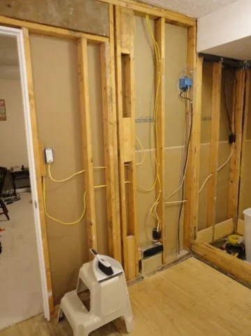

Finally got the substrate, ducting, electrical and sink plumbing finished. Rewired so the junction boxes are up in the attic and moved the crapper light/blower switch over so it's right next to the shower and crapper area. Prior area where it was would have divided the wall due to the light being right in the middle.

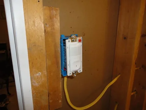

Upgraded the main lighting switch to a motion sensor switch from Pass & Seymour. (Menards: 'bout $25) Incandescent lighting only. Depending on how fast and where you walk into the room the switch has a > 1 sec delay or a < 1 sec delay. We'll see how I like it. I know there are florescent switches that you can get from Grainger.

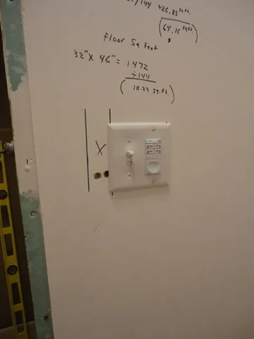

Upgraded the exhaust fan to a time delay switch from Menard also (bout $25 also). 1,5,10,20,30,60 minute delays. This is a really nice feature.
Relocated the toilet light and exhaust fan. Freed on the wall for whatever.
Motion Sensor Light Switch.
Fan time delay.

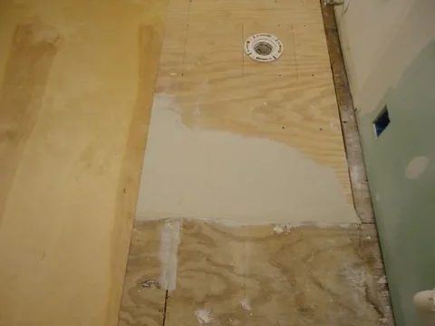

I'm now working on the flooring and the radiant heat. Needed to do some leveling of the floor before I put the sub-floor down.

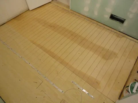

I did a lot of research on the types of heated flooring systems that are on the market. Home Depot has one vendor that has two types of heating for floors. A system that you customize based on the area and another system that tucks up under the flooring in between the joyces, it's exactly 16" wide and comes in predetermined lengths. Menards has a vendor EASYHEAT with a product called Warm Tiles. Essential it's the same product but since there was an open box in Menards I read the instructions for all the details. This helped out because I understood what the flooring height needed to be.
EasyHeat comes in a variety of lengths at either 120V or 240V. The larger area you need the more voltage will require. Planning out is pretty easy with the instructions. Based on the spacing you desire and the traffic area with determine the amount of line you will need. Also, a GFCI is required for the system.
The manufacture calls for a minimum of 3/4" in between the finished surface and the wiring. What I'm doing is below.
Here's the finished layout.
As all project we get into sometimes there's sweat, tears and blood. The metal strapping at each end of the system got me right at the finger tip. Ouch!!
Next I'm putting down the scratch coat of mortar then laying down the backerboard right over the mortar. Then 1/4"X1/4"X1/4" trowel mortar base. Then the finished tile.
