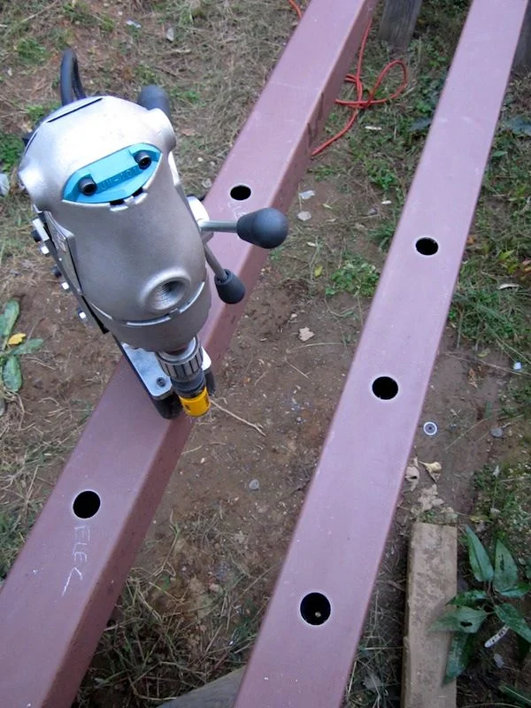

This is the Jancy Slugger (JM101) I picked up (used) years ago. As you say, it's not something I use frequently but it makes the job much easier when I have a need for it.
The one I got came with a Jacobs chuck on it, which suits my purposes most of the time. Typically they come with an arbor for annular cutters. I like the Jacobs chuck to be able to drill holes with regular bits and I can use hole saws, but there have been a few projects (like the one above) where I'm cutting a quantity of larger holes and (as I'm sure you know) there is a difference between a hole saw and annular cutter at that point. Unfortunately, I haven't seen the arbor pieces for less than I paid for the whole unit with the Jacobs chuck, so I haven't gone that route yet. But it's also probably why I got such a good deal on it. The ones with arbors were fetching a lot more - to the point that it seemed like I might as well just buy new.

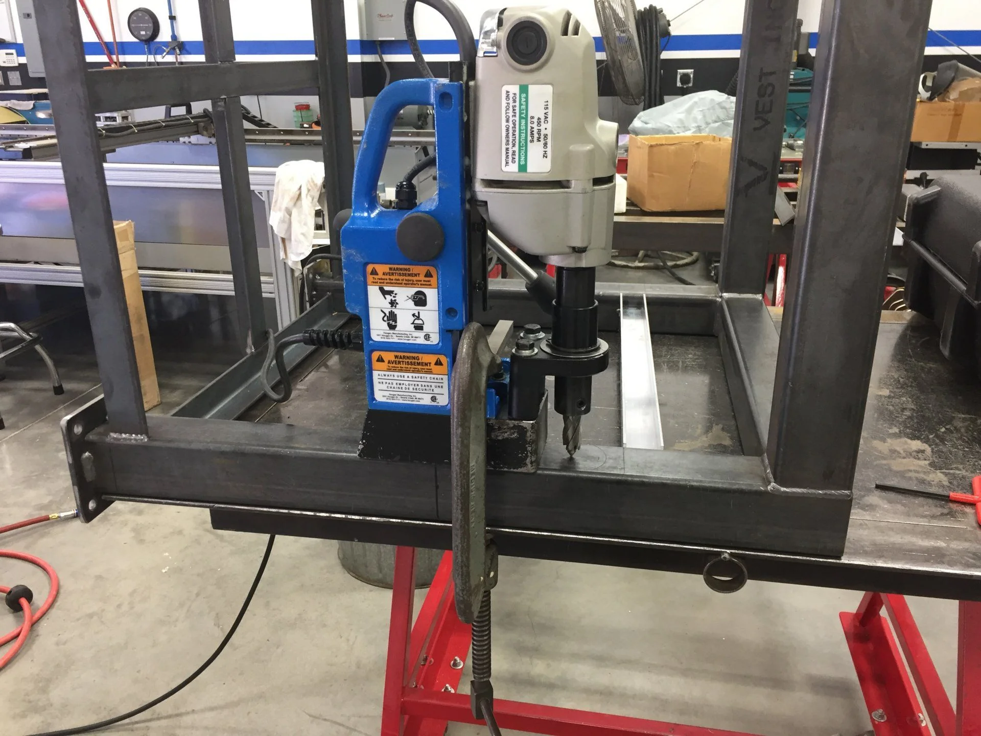

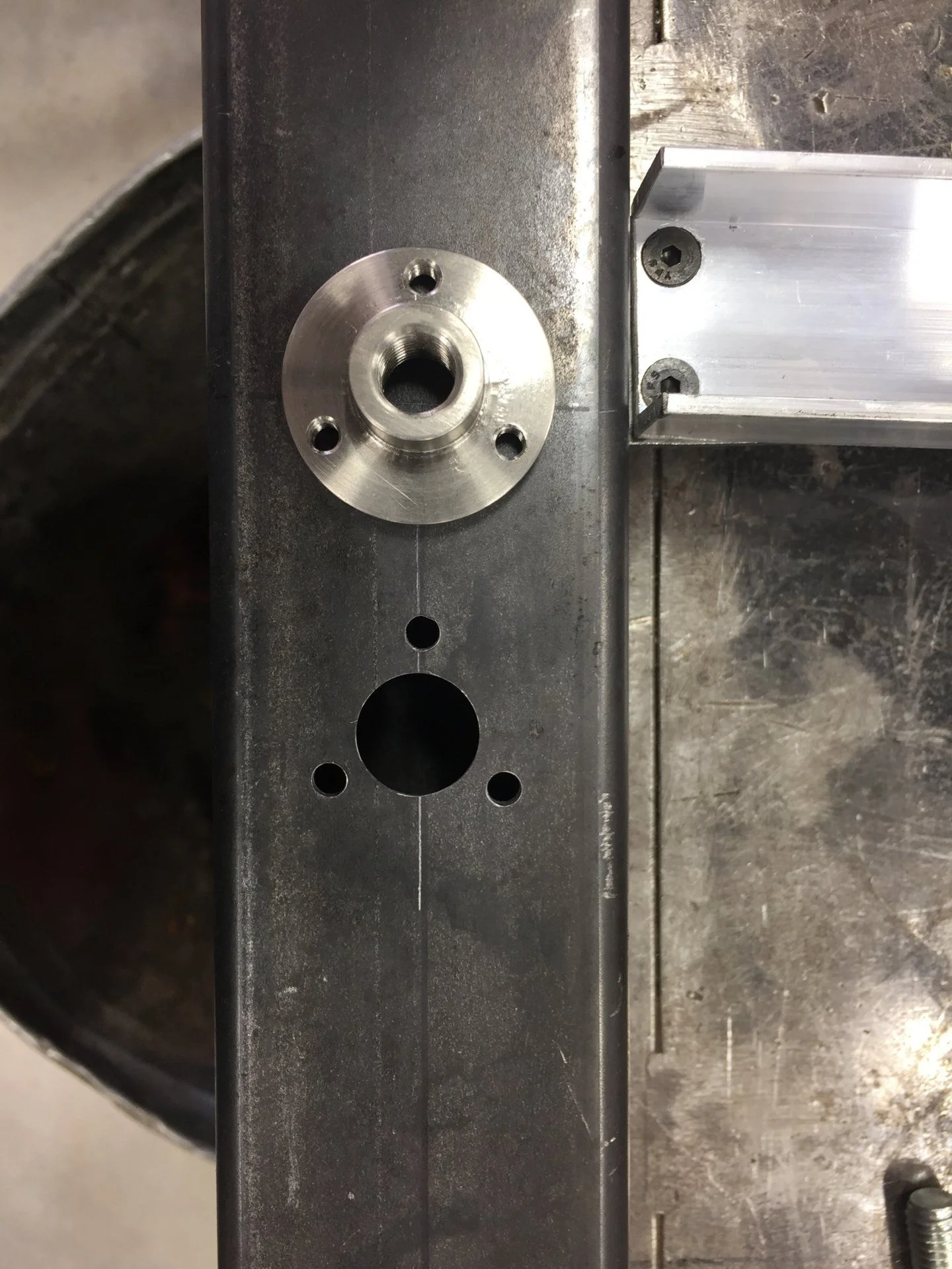

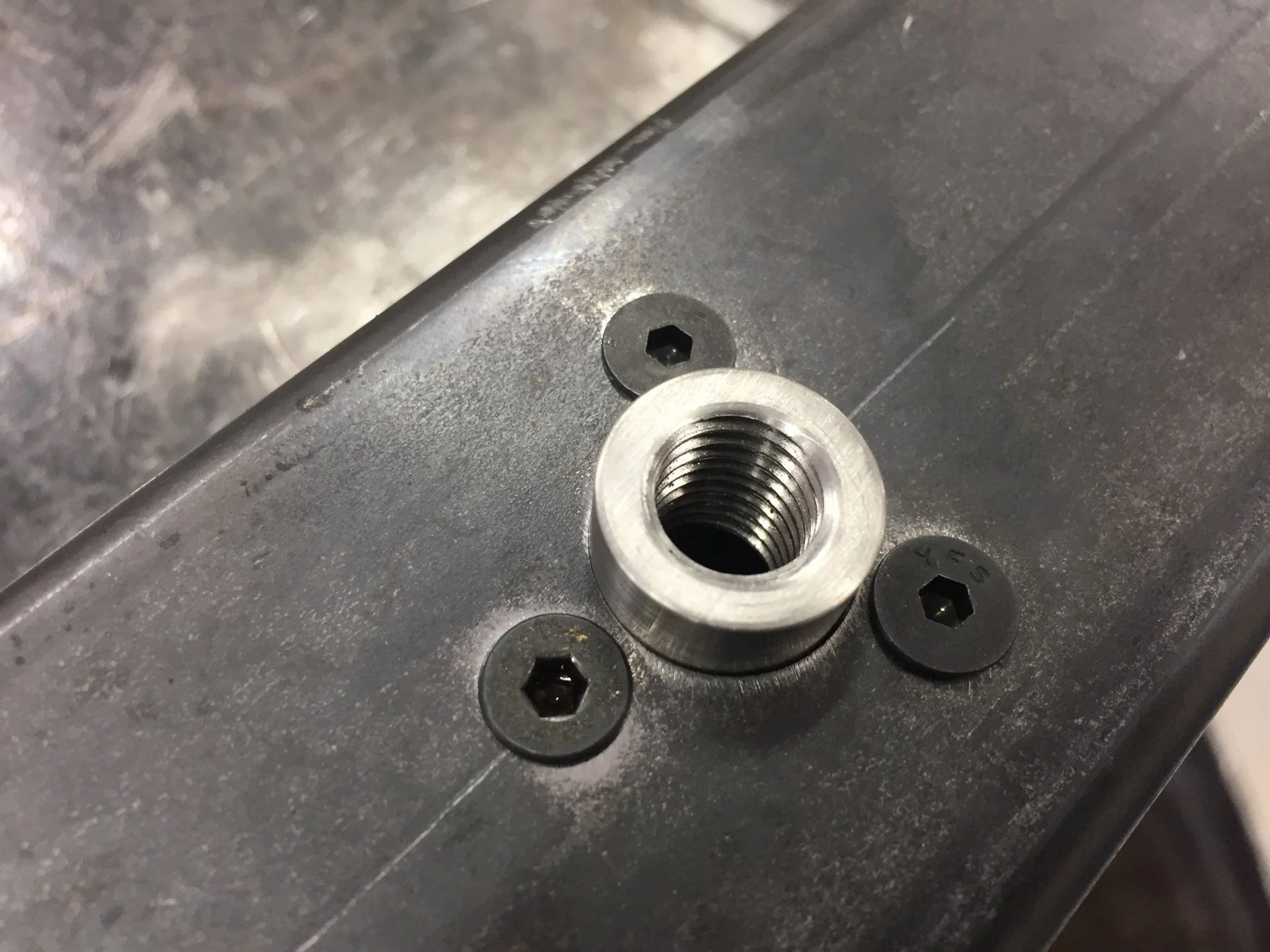

I built this machining service cart without drawings so when the time came to drill a couple of precise holes for two machined bushings this tool was used. Again not used often as others have mentioned but a handy tool non the less.
It's always a good idea to secure the setup when drilling thiner wall material. The toque these tools produce will get you hurt.
