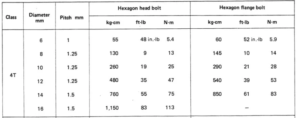

for the OP, it looks to me like both the M10 and M12 have a pitch of 1.25. This table is a bolt torque spec table from one of my FSMs. The typical rivet nut sizes do seem to be M10x1.5 and M12x1.75

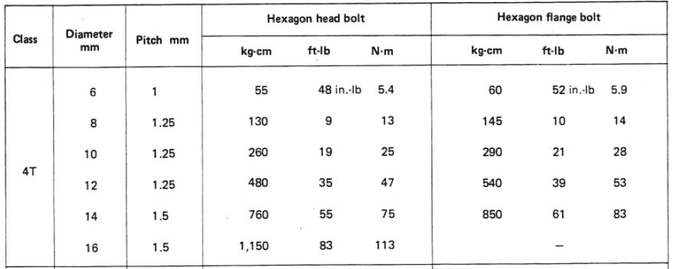

Yes, the M10 is a 1.25 pitch, which I guess is not common in riv nuts, and the M12 is 1.5, according to my measurements and my metric tap and die set, which is also not common in riv nuts.
