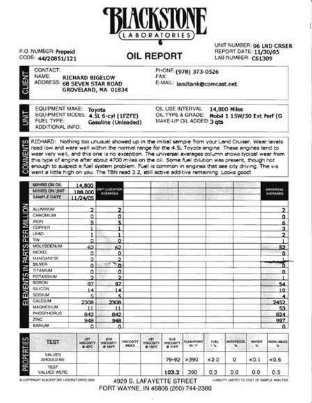

Got my analysis back today. Seems I have 0 antifreeze in my coolant. And the oil is about in the same shape as some having only 4700 miles on it.
When I get home and have access to acrobat I'll try and post up the whole report. Basically this extended life stuff works! And at 45k a year will save me some cash.

Here is a scan of my report. It says something about the VIS being a little high. Can someone explain this.

Viscosity = resistance to flow. The higher the number, the thicker, the slower it flows...
Your 15W50, pretty thick in the first place, seems to be slightly above the high end.

WOW, neat report, those wear metal #'s would look great @ 5K miles but this is 14.8K a long haul and still great, I don’t know why blackstone squawked the fuel, 0.3% is next to nothing looks in line with my 5K reports.
Even though I am in the "thick camp" I would normally say 50 wt is to thick for the north east except for summer, even M1 50 wt witch is thinner than others, but apparently the 4.5L is just fine with it and even seams to like it all the way into early winter. Makes the EPA mandated “5w-30 recommended” look like BS,,,,, Again,
IIRC you do a lot of extended trips? That may explain it, thin oil is handy during warm up in cold weather, if you spend a lot of time at temperature with fewer warm ups then the thick stuff has its place.
vis=viscosity, according to Mobil’s spec sheet 15w-50 is suppose to be 18.2 CST @ 100C witch translates to about 90 SUS at 212 F and a low SAE 50wt oil, your 103.2 SUS @ 212 is higher than fresh from the bottle but still within the range of a SAE 50wt
IIRC soot, oxidation, nitration and volatility can lead to higher viscosity.
Looking that the viscosity did not drop over time shows that this oil is shear stable, good to know
Could I talk you into posting this over at BITOG in the UOA section?

It was in for maybe 4.5 months. I bought the stuff by mistake in one of my PepBoy coupon raids. Because the Aus market specs 15w 50 for summer I thought that I'd try it. I did leave it in a little long as the last day it got down to about 20* and the engine knocked like crazy when it started up. I changed the oil that day.

Great report. Once again it shows that the 80 motor is easy on oil and can comfortably tolorate 10K+ changes with a good synth. I don't see any need for a bypass filter here.
Raventai. I am wondering if we are seeing oxidative thickning occuring even though the additive package is not fully depleted. Would be a good question for Molekule and those guys on BITOG.
To keep the thickning under control, I would suggest a mix of 50/50 15w-50 and 5w-30 M1 EP if you want to run long oil changes.
