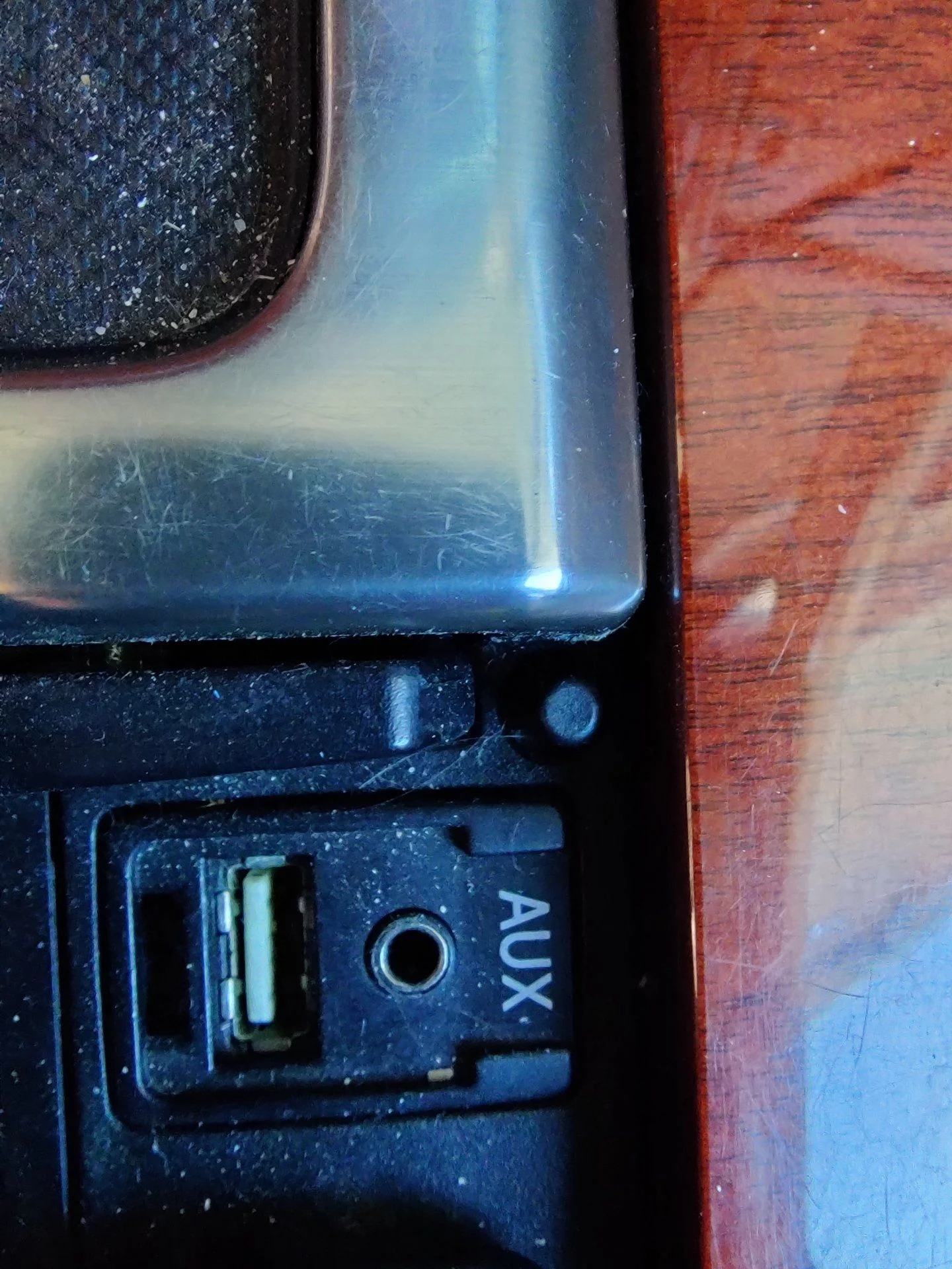

I know this a shot in the dark, bit any older (2010) LX owners do a USB port retention?
I picked up the grom audio box and it's been great; however it doesn't appear to have any USB port retention cables, which has turned into routing some long USB cables in some not so clean ways.

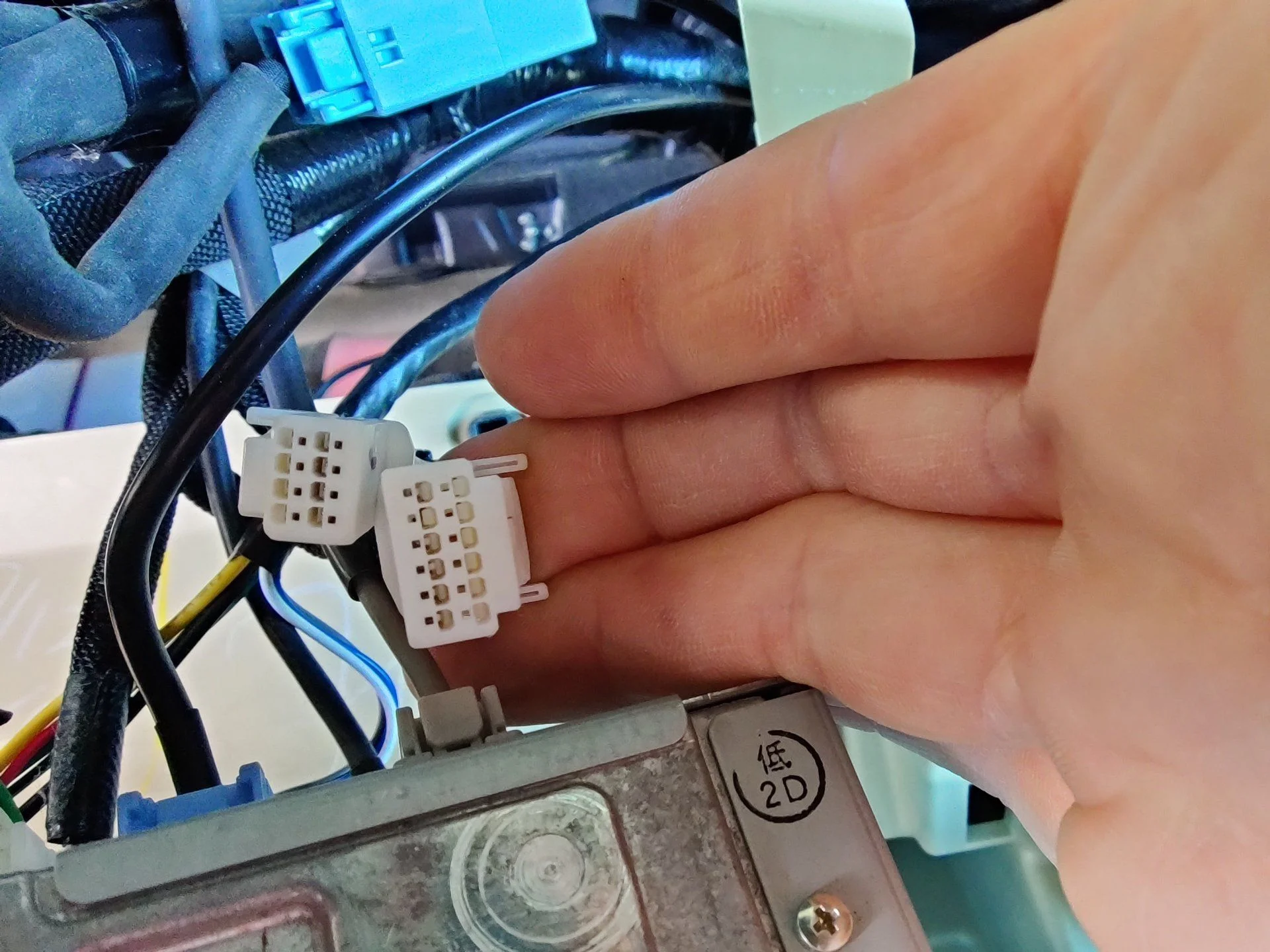

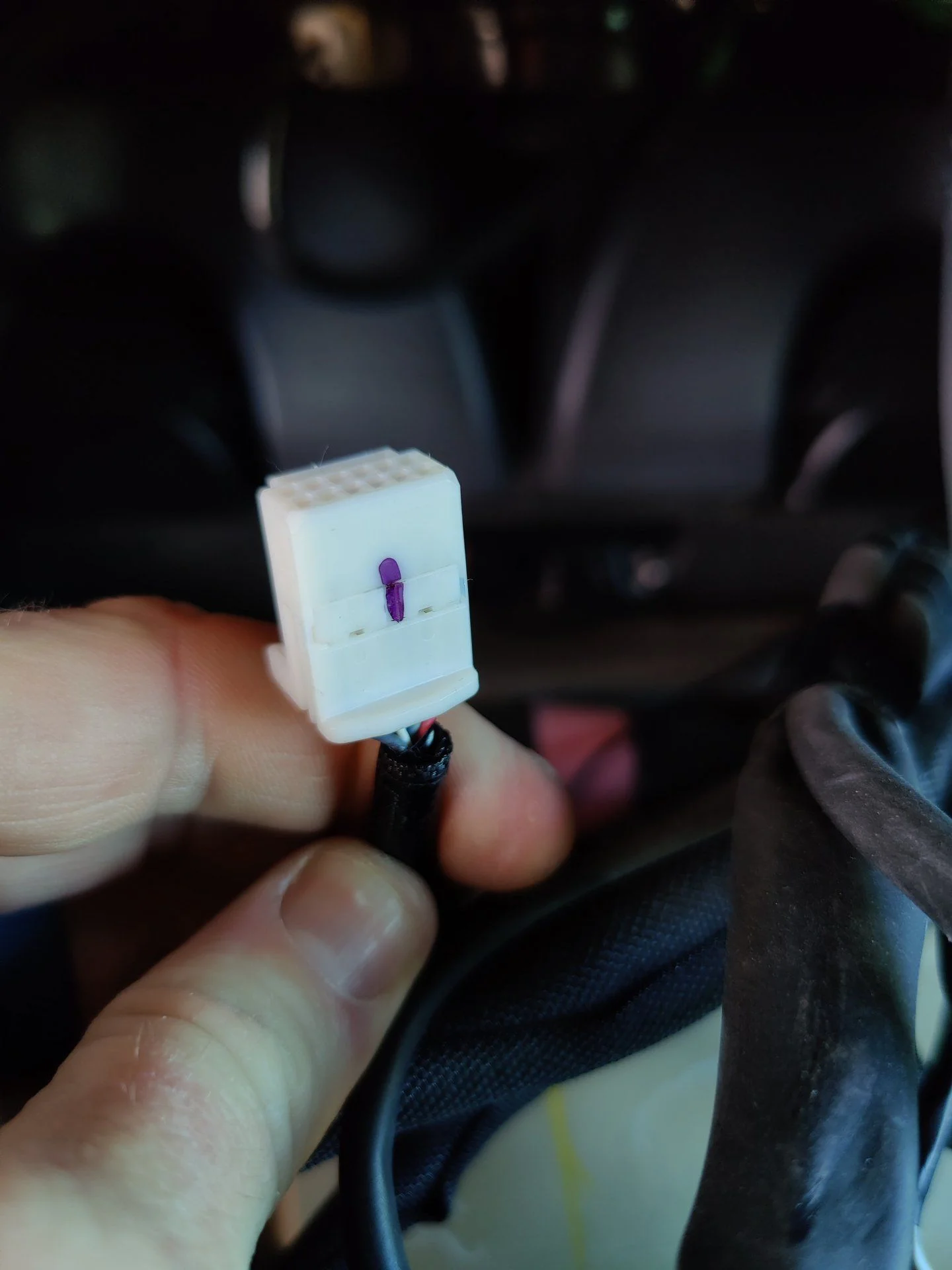

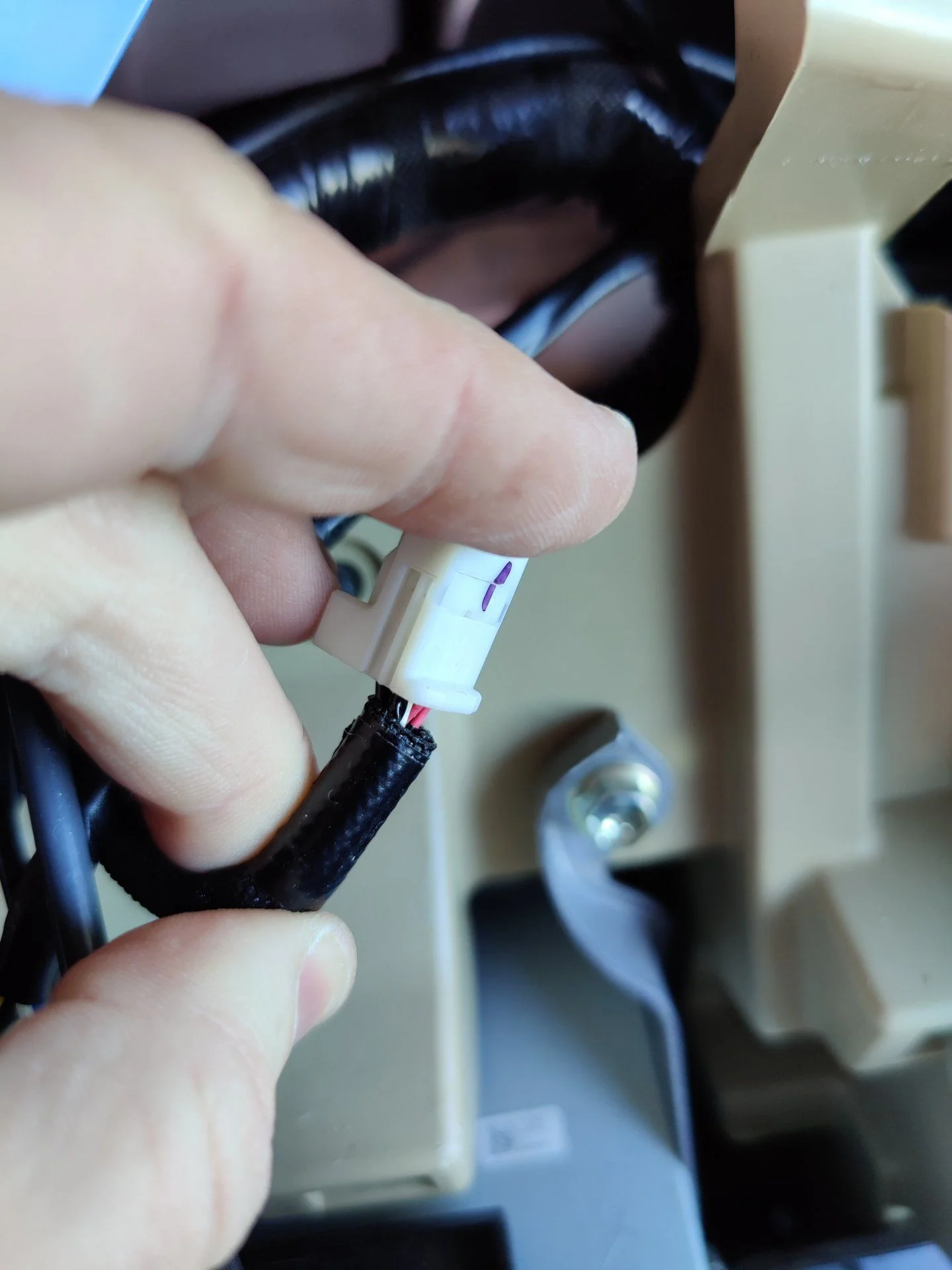

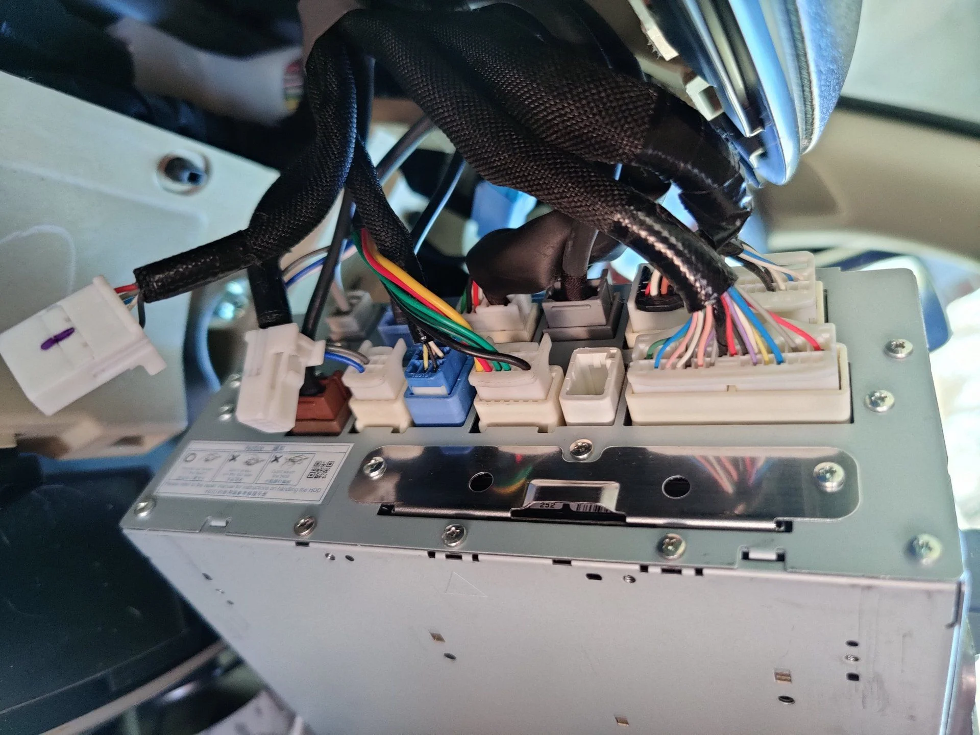

I originally thought this would be easy and picked up both the TY1 and TY2 variant adapters that are common, but neither seems to be a match for the wiring that was removed from the back.
Here are some pictures of the two connectors I disconnected during install.
Any ideas?

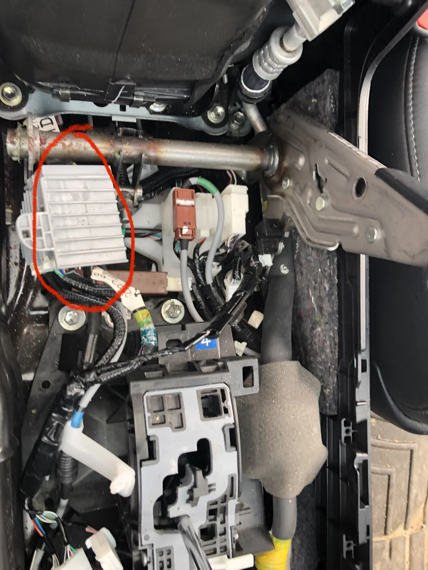

I can't seem to type in the above post, but it plugs into the box on the underside of that grey plastic cover on the left of the photo (closer to the passenger side). Although the photo above is with the entire console removed, you can access it by taking out the cup holder (pull straight up).

I was able to reuse the USB port in center area beside the shift lever to connect the USB device to GROM. It took a bit of tinkering but finally I got the USB cable from
GROM under the center cup holder and removing the existing connecter of the USB port and use the GROM USB cable to get fixed there.
After doing all of this, I realized its not worth the effort as USB connection to Carplay is not efficient compared to carplay over wifi. whenever you disconnect and reconnect its creating some issues and the charging capability was also not as strong as a typical carcharger. The only use I see is if you want to load songs or movies and play them in GROM then this could make sense.

Not worth the tinkering and hacking required to make the USB female fit into the PAC USB-TY2. You literally need to dismantle and remove the existing socket and push GROMs USB Female.
I think you can route the GROM USB to under the cup holder if you need to connect something quick.
