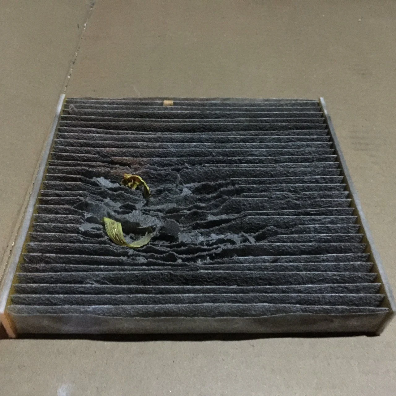

Thinking it was time to change my cabin filter?
Odd how much crap was stuck in there. The Cruiser is otherwise super clean, interior was well-kept and it's spent zero time offroad. It looks like a pillow got shredded in the cab and sucked into the filter? Doesn't look like rodent chew and no bad odor? Crazy eh?
That is crazy!! I've changed them at 30k mile intervals and they look new. We're talkin mid-west, Nevada, and Texas. I think your right must of run over a sheep or had a sheep in the vehicle??
Seriously. The material all looks uniform. I'm thinking a pillow ripped open under the dash?
Swapped the filter and it's blowing stronger than ever.
LOL..................

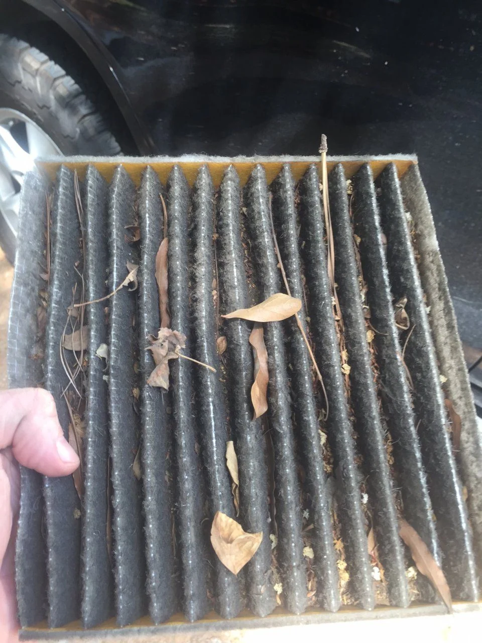

When I bought the rig 2 months ago this is what the filter looked like. I also have dropping all over the engine bay as well as a few wires that have been chewed on.
The critters tend to do this more in the winter. I found moth balls to be a great repellant: placing one every few weeks stopped the chewing on my knock sensor and fuel injector wires.
I have traps and sticky pads and keep the garage trash free. Also use stainless steel scrubbers to block garage door gaps.
