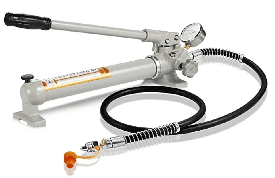

The AHC module refreshes pretty slow in Techstream. That is why it isn’t “real time”. So here’s a kicker for trying to use Techstream
to measure pressure. The slow refresh rate doesn’t help, and also in a lift situation, if the computer engages the accumulator then the ecu will also attempt to fill the accumulator after the lift process. So you have to also hope you get a pressure reading before the accumulator starts filling. This is probably why you saw the L to N register 12ish MPA.. You should be hitting around 8mpa in that scenario.
I’ve spent a little time considering how to
Measure the pressure as well, but ultimately I agree with @TeCKis300 that it probably doesn’t matter that much. I believe Toyota has a SST that is essentially pressure gauges that attach to the bleeder(a). Even if there wasn’t an SST.. that’s probably the best way to get real time pressure readings.
