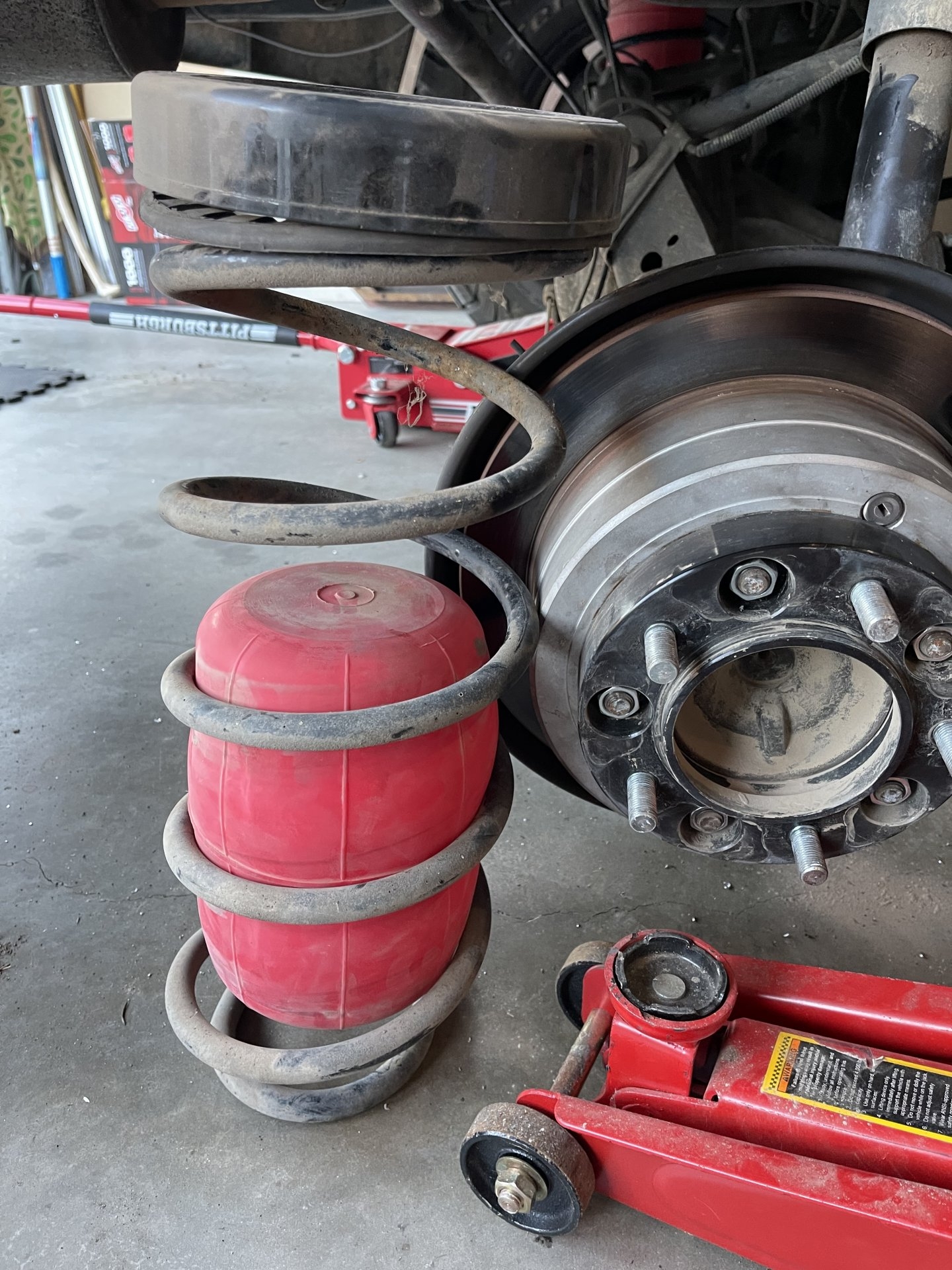

I had airbags in the back from years ago for towing, but they were faulty. Kinked hoses and ballooned out.
I removed those, added 30mm spring spacers, and new airbags. Pressures them to 25# and rear pressures went to 6.6! That was all airbag, the spacers were already in when getting 9-10.

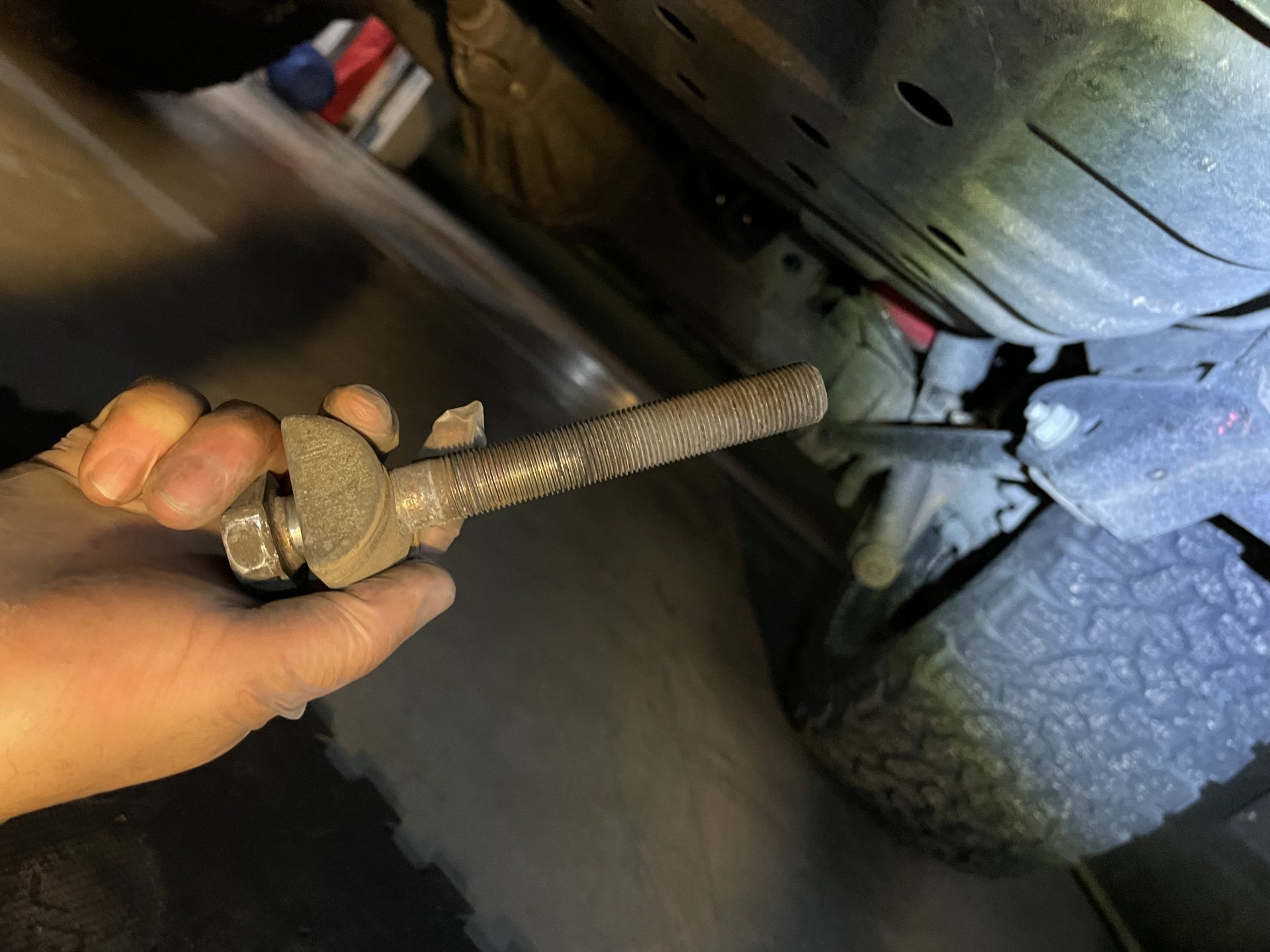

3. Remove TB adjusting bolt - uncrank all the way out

3. adjusting bolt removed

6. Adjuating bolt removed

So the bags had issues. while wheeling they deflated 2x. both probably my fault on the install. The hole at the bottom of the spring plate seemed big enough but it looks like the clamp get caught in it and pulls off the hose. The second was a pinched hose that leaked, not sure how the pinch happend, so I just reconnected to the T and all was good again. both quick fixes, but not ideal.

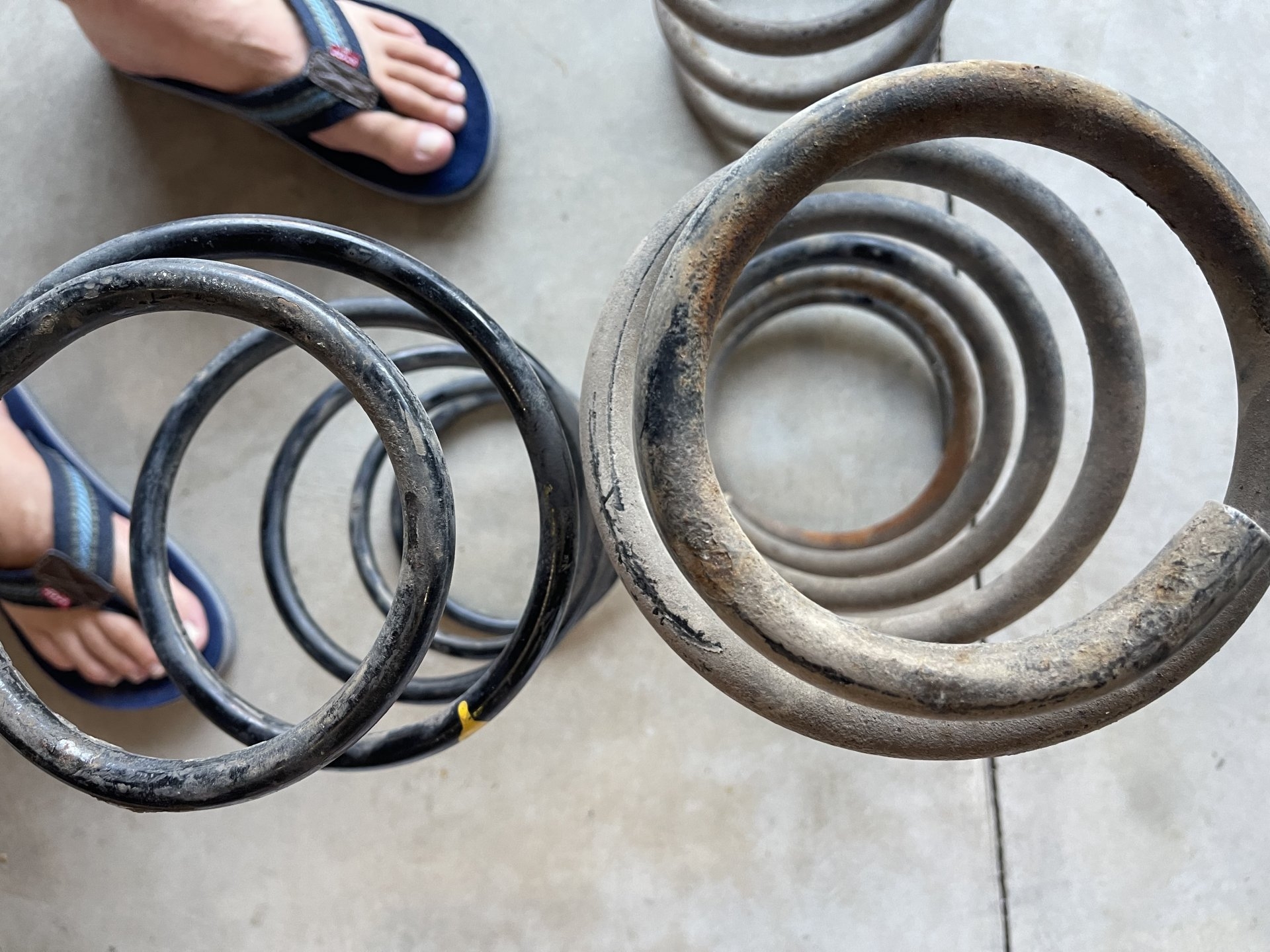

Next plan: installing 80 series springs tonight with 30mm spacer and bags (with a larger hole) as well! Lets see what those pressures do now!

Ok! 80’s on, with 30mm spacer and airbags with nozzle pointed down and a 3/4” opened up hole.

these 80’s look like they have an extra 1/2 turn and a little taller for the ds and much thicker than the stock ahc spring
Looks like I lost .5” height in the rear also. Next step, get the shock spacers and arms as needed for a full sensor lift aka Paddo. I still get some rub on the front fender when stuffed. I am running 325/65/18 ko2 so kinda wide😂

Thanks for the write up! So would replacing just the adjuster bolt be as simple as raising the tire, removing the bolt, and screwing in the new one? I don’t need to reindex yet but I have a bolt that is so rusty it’s getting hard to adjust. If it’s that easy I’ll just replace them.
