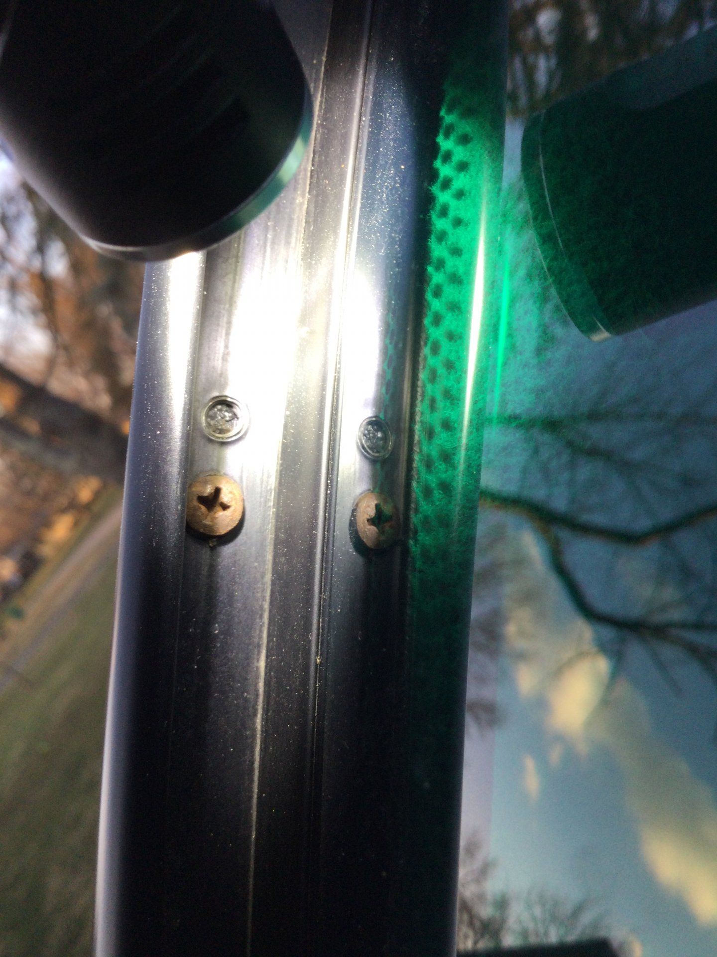

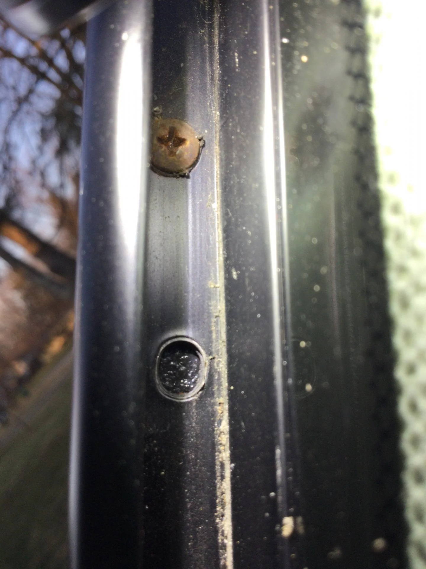

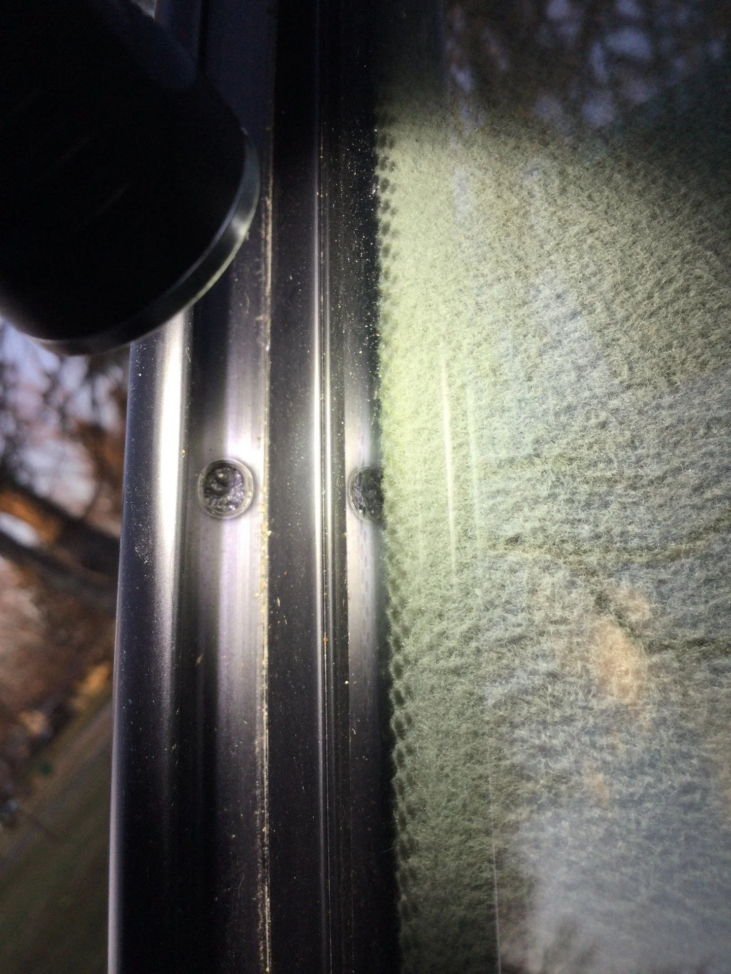

I never had fuse box issues until I had windshield replaced. Now it gets soaked every time it sprinkles outside. Flashers were on this morning. I’ve had the horn blare nonstop before. The windshield place swears it’s not their problem. They even put on a Lexus windshield after I complained about them using a fuyao the first time. I pulled the soft trim and this is what it looks like. Would this be the source of the leakage? It’s been 4 months and it looks like their screws are very rusty already. I have battery disconnected now until it dries out. Any help is greatly appreciate.

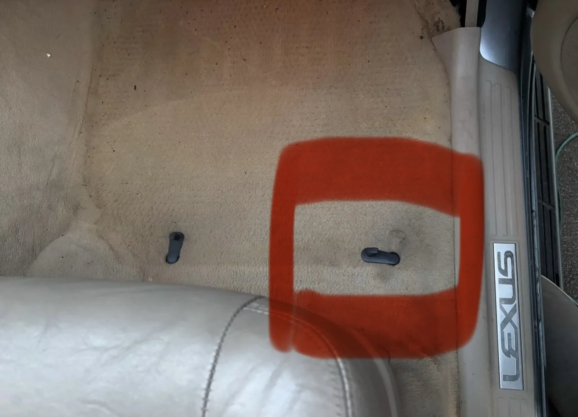

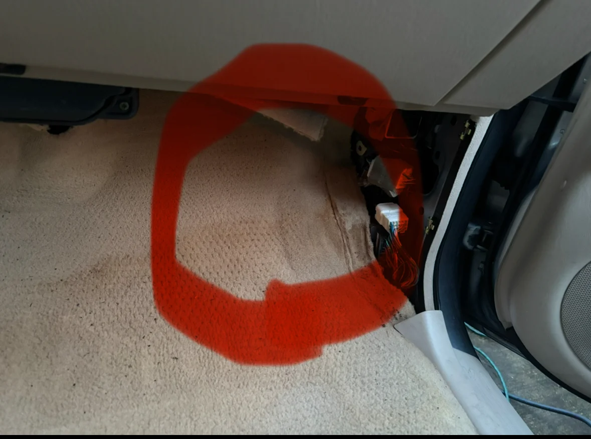

I’m having the same issue with mine. Did you ever get to the bottom of the leak? I’m noticing moisture on the passenger side behind the carpet by the kick panel and the carpet is wet near the right floor mat hook on the passenger side. My guess is it’s coming in somewhere near the kick panel and pools up by the floor mat hook. Initially I thought it was a vapor barrier issue, and there were noticeable holes there but after it rains there’s still detectable moisture. I just bought this car and it does have an after market windshield. I’m working if that is the culprit?
