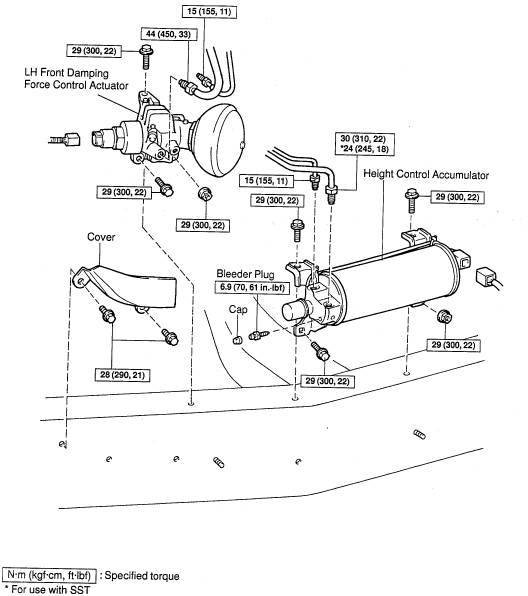

Good information! Ben, just wanted to clear up something. You refer to "Accumulators" but do you really mean "Actuators" (Damping Force Actuator). See Diagram. Just don't want anybody to special order the wrong part.
I have read good things about Keith Bowers at B&B Suspensions. He rebuilds the actuators at a very reasonable price ($175/ea). You can reach him at: kebowers47@hotmail.com

Hoser, you are correct in that the whole assy is called the actuator. The piece I'm referring to is the big ball piece on the end of the actuator. This is the part that actually fails, it is the part that contains the nitrogen and the diaphragm. I have never seen the actual actuator fail, or one of the pumps for that matter.
Thanks for pointing that out hoser.
