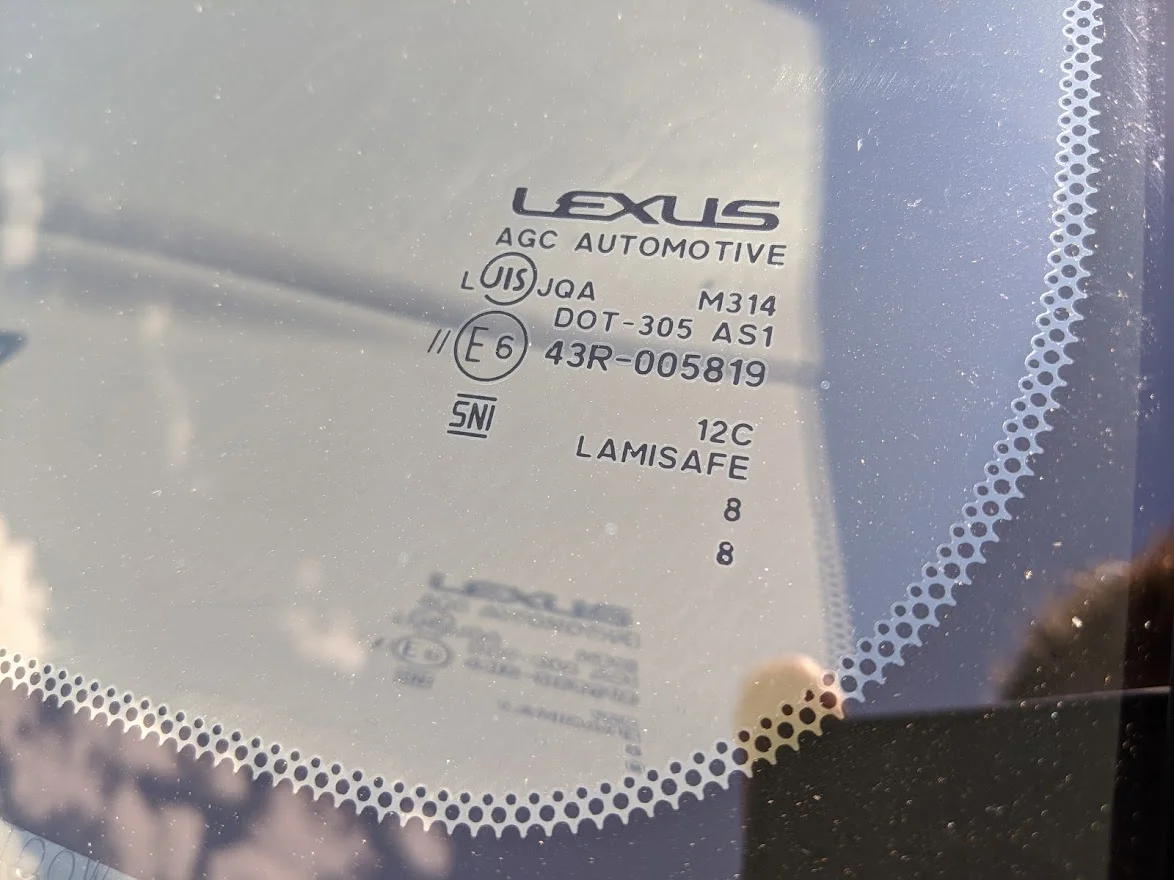

Acoustic glass is generally marked as such. My genuine Lexus glass has no such mark. It's AGC Lamisafe. They make acoustic glass as well, but it appears to be a different product line.

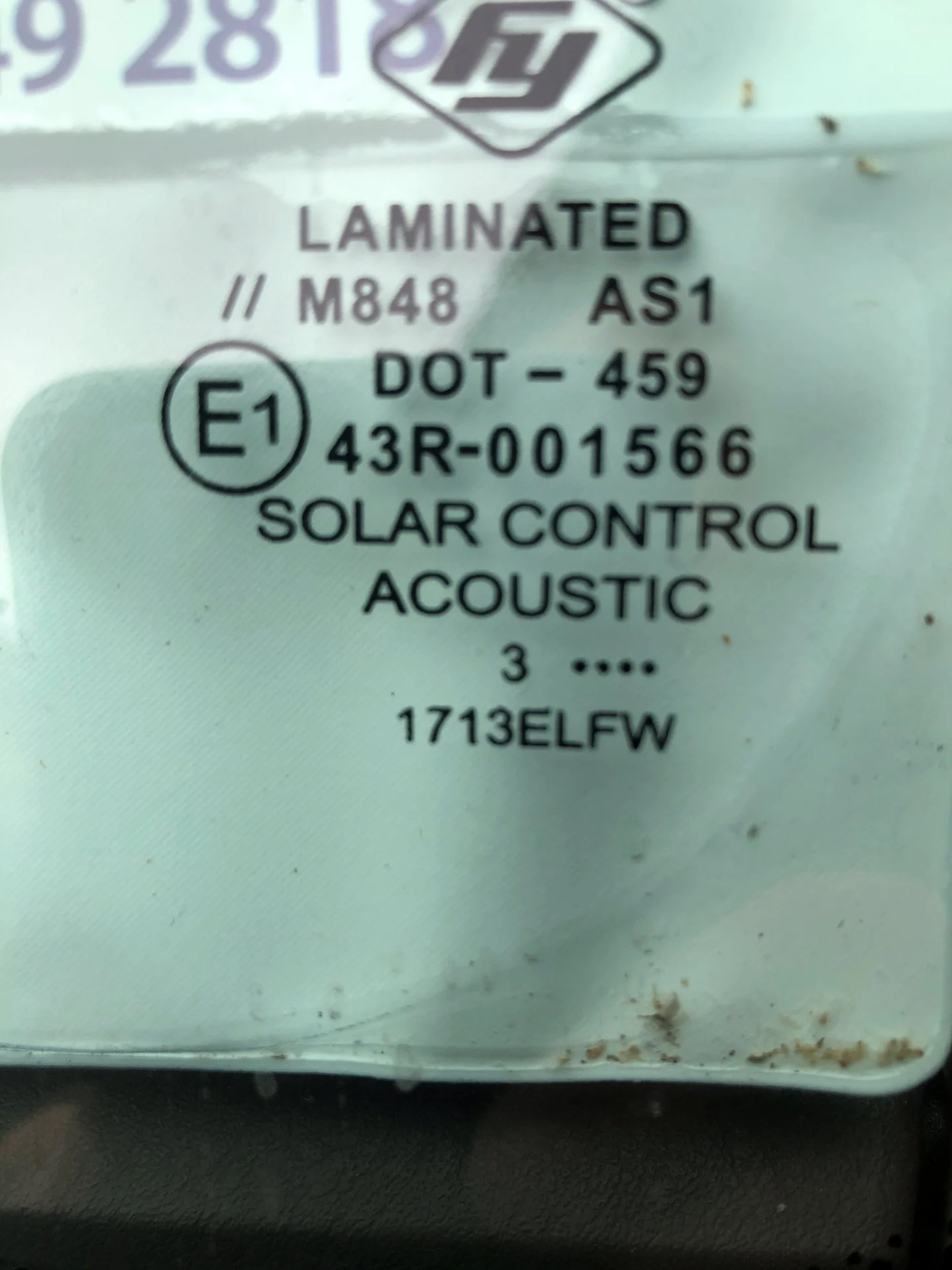

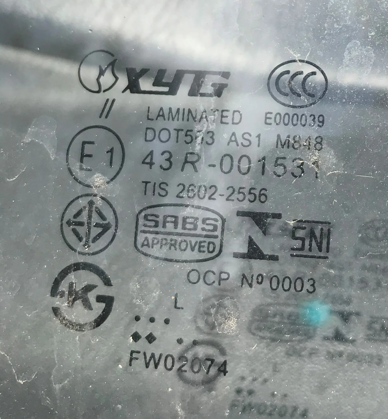

Absolutely recommended upgrade to get the Lexus screen. Had to do a tidy up of rust around the screen last time I had it replaced. Took the opportunity to upgrade to better tinted and acoustic screen. At the time I did an amateur level sound test with an app and found there was a measurable reduction in noise after fitting the new screen.

Absolutely recommended upgrade to get the Lexus screen. Had to do a tidy up of rust around the screen last time I had it replaced. Took the opportunity to upgrade to better tinted and acoustic screen. At the time I did an amateur level sound test with an app and found there was a measurable reduction in noise after fitting the new screen.View attachment 2686572
Weird. Is that Lexus glass? Maybe an aftermarket part compatible with Lexus? I don't think Fuyao is on OE supplier, but maybe they are. 🤷
Here's their marketing for the acoustic glass: ACOUSTIC GLASS_Fuyao Group - https://www.fuyaogroup.com/en/products_list_7.html
Apparently uses a sound insulating material between "PVB" to reduce 1000-4000 hz.

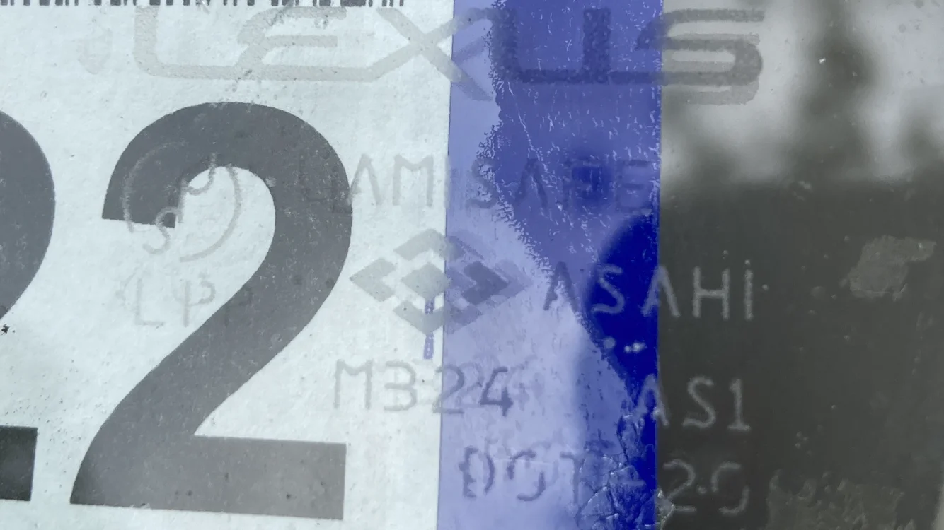

Pics here:

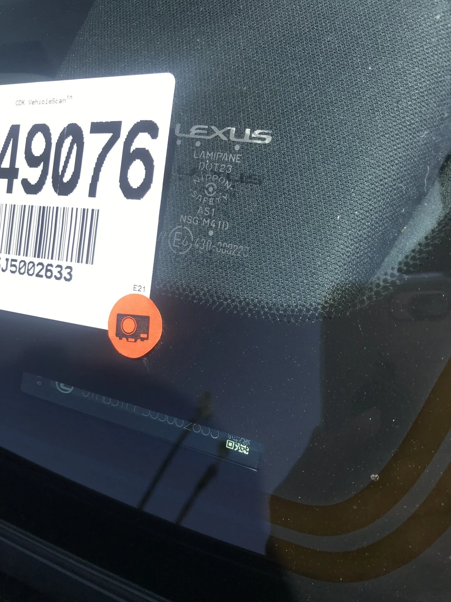

I was at the Lexus dealership today and took the opportunity to stroll around their certified used car lot. They were several 2017 and newer LX 570’s on the lot as well as a LS500 and none of them had the acoustic markings as outlined by the linked article. The LS500 windshield is certainly acoustic so this leads me to believe the OEM Lexus glass must not prescribe to the linked naming conventions.
Here’s the LS500 windshield. Note there are no “acoustic” or “A” or ear markings on it.

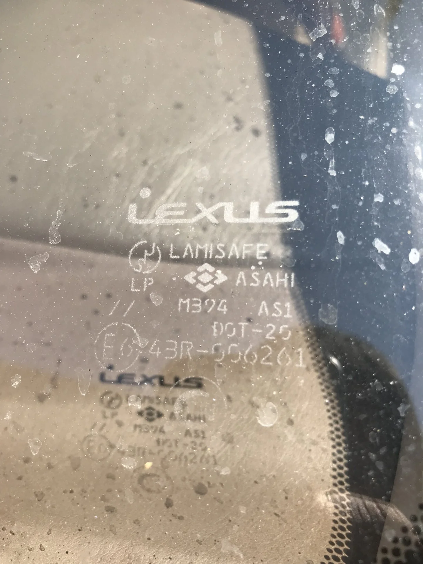

Here’s the bug on my 2002 LX. I assume this is original OEM. I read on another Lexus forum that AGC/Asahi/DOT20 all refer to the same manufacturer in Japan FWIW.
