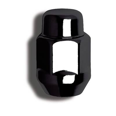

I run steelies and got my lugs from Gorilla Automotive. They are powder coated black and awesome.
Wouldn't you just buy Tundra steel wheel lug nuts?
for the steel wheels you want a tapered fit lug nut, your stock lug nuts are a shank fit. why not use the tundra nuts or you can use 93-94 80 nuts
Look at your stock lug nuts. On my 2000, they had the taper at the end in addition to the flat shank. They look dorky, but will work until you get smaller ones. I ran Tundra steelies for 10k miles like that.
Gorilla Automotive 91147BC Acorn Bulge Seat Black Chrome Lug Nuts (14mm x 1.50 Thread Size)
Got them on Amazon.
