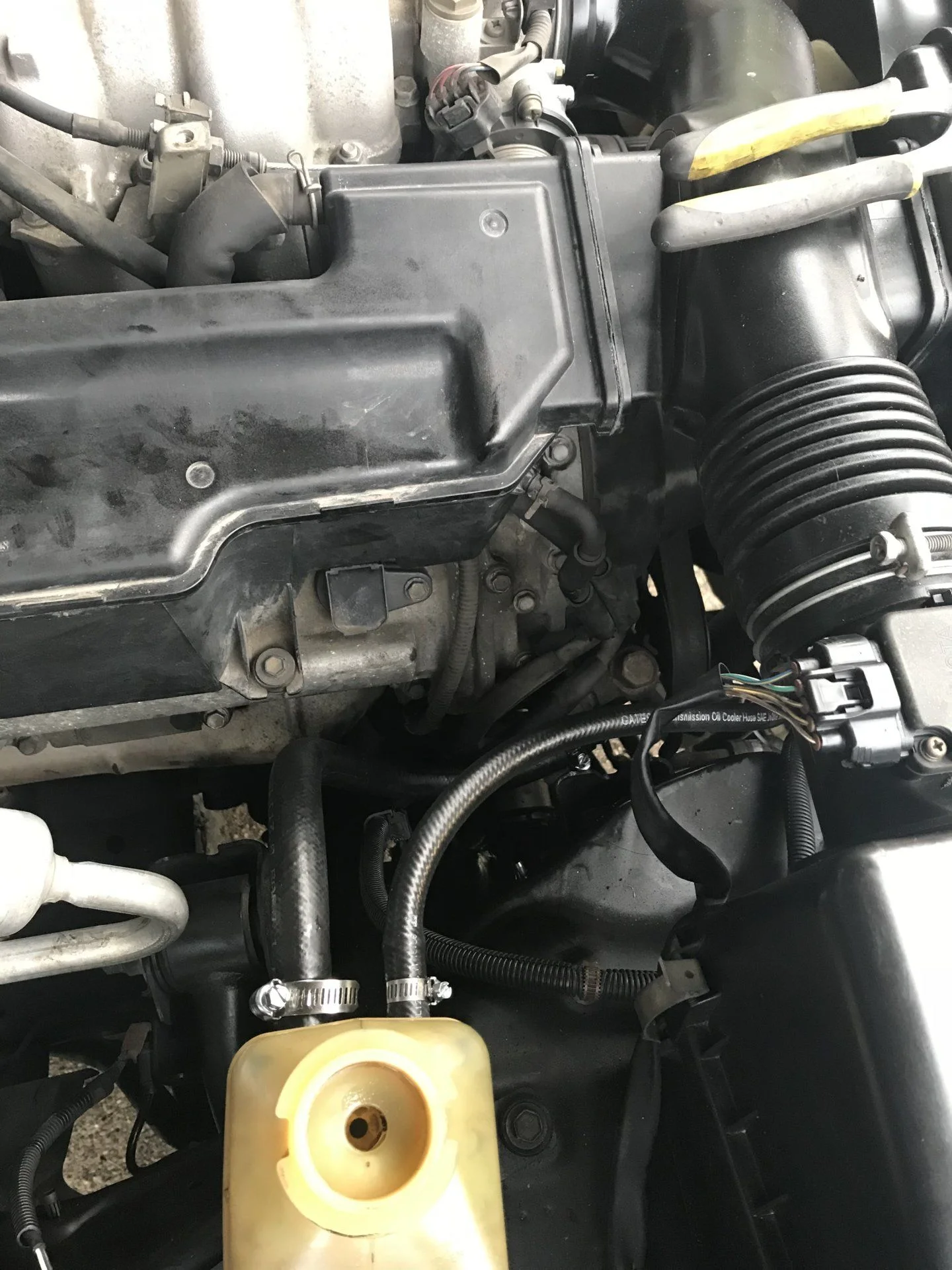

I replaced all low pressure power steering hoses, including the return hose to the reservoir, on a 1999 LX470 with bulk 3/8" ATF hose. The suction hose is 5/8", I used bulk hose for that too.
Exactly! I just did mine a few weeks ago. I used bulk Gates 3/8" and 5/8" transmission oil cooler hose.(not regular coolant hose) Get about 30" of each and cut to length needed. I think the hoses plus a bottle of Valvoline Max Life ATF fluid and new clamps cost me less than $30.
Make sure to remove and clean your reservoir (screen in bottom) before attaching new hoses. The 3/8 transmission cooler aftermarket hose will fit so tight future removal will be very difficult. Steering Flush & Cleaning

If budget has room, it's nice to use OEM for the suction hose (large hose) along with your old OEM clamps.
How did you guys get the old hose off the bottom on the return without damaging the steel bend? Just split with a razor and cut/pill? MIne is on there really tight.
