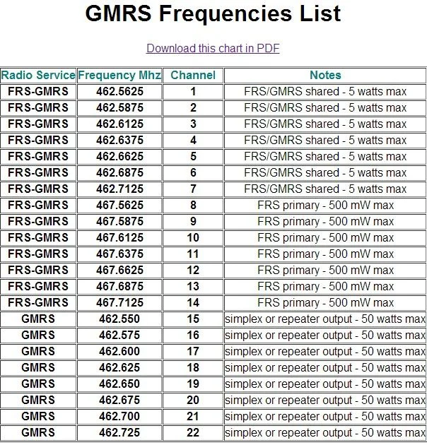

Another vote for the Baofeng UV-5, I used one on Saturday for a similar purpose as we had a truck without an FRS radio. I wouldn't waste the time programming it though tbh, just print out a conversion chart and stick it in the center console, here's one of several examples available:
So you'll monitor the Ham frequency on one side of the radio, and you can plug in the frequency of your GMRS conversation on the other.

I have a similar chart. I thought the FRS/GMRS limit was 1W unless you had a GMRS license (which costs $ but all you have to do is fill out a form online with the FCC), but I could be mistaken.
Yes I believe you're correct, and those radios will let you do all sorts of illegal activity, including transmitting at 5w. He's already got the GMRS mobile unit in the truck though for transmitting, putting the same frequency in the Bao just provides another monitor option that can be more portable.

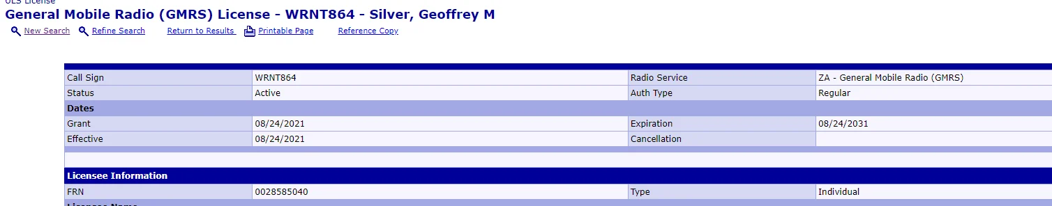

$70 for 10 years when I got my GMRS license. No test, just need to pay. Worth it for the piece of mind to me.
$70 for 10 years when I got my GMRS license. Not test, just need to pay. Worth it for the piece of mind to me.
Yep did mine last year, that's what I recall as well.
Yep, I have GMRS and the license.
Even better for new people just getting into it recently, the fees were reduced to $35. There is really no excuse not to get a license.
