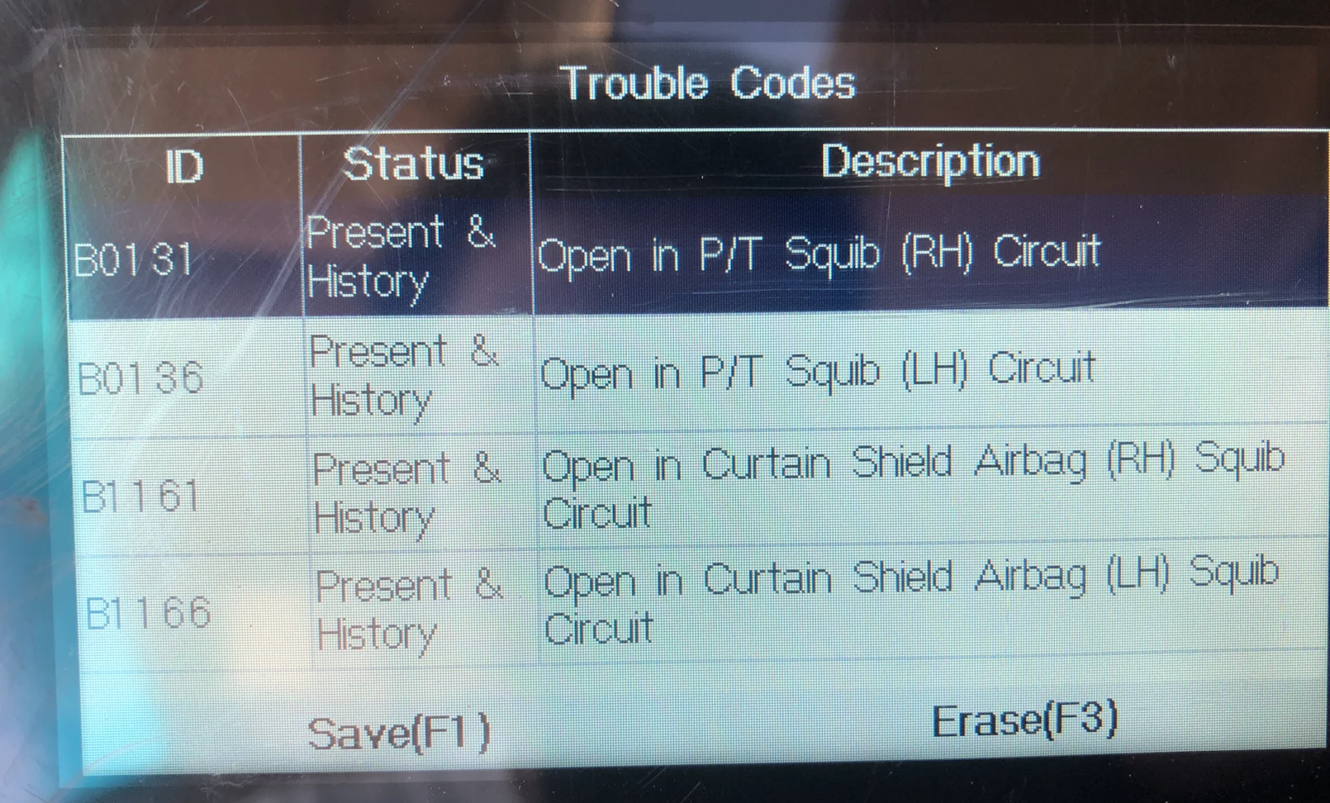

I have never tried the TIS but I think it's good practice to use it, will give it a try. Maybe I can also get the techstream to program me some new keys as well... I also had B0131 and B0136 for seatbelts which I already got fixed by sending them to a seatbelt repairing company and cost me less than $100 for both sides.
This picture is all the airbag codes that the truck has before I started working on it.

Out of curiosity, what’s the history on the vehicle, to cause all of the airbag/seatbelt issues? Accident? Water intrusion?
I have no idea, the truck itself has so many problems but I fixed most of them except the airbags, I got it off Copart auction. The front diff is busted, and the front bumper shows indications of a front end, but no car fax reports regarding accident.

I took it to the dealer, they replaced the airbag ECU under the recall for me. I had a solid airbag light before, after the dealer replaced the module, the airbag light turns flashing, the same codes. Then I had the seatbelt repair company did my seatbelt which helped with the first two Squib codes.
Use the search function and find my post about the code for airbag squib circuit. It was a connector and after a 10 minute repair the light disappears on its own. Good luck!

I fixed the open squib circuit the similar way to how you fixed yours, and mailed it off to some company that does it. I assume that is the post you are referencing about, I cleared the first two codes by doing that. Now I really don't want to mess with anything on the curtain airbags and just swap them out.
