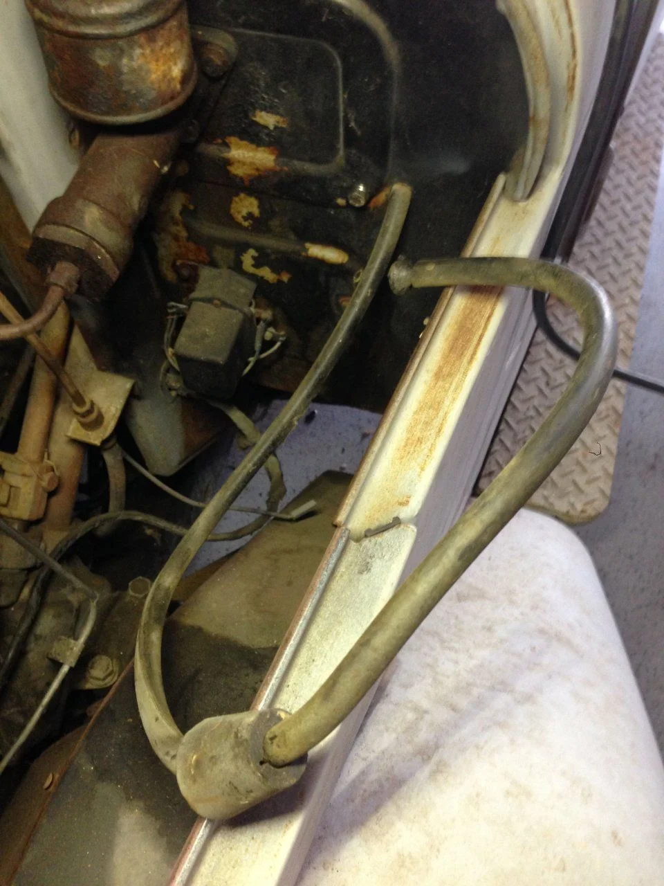

My 1966 FJ45 lbp came without the windshield washer tank. Need information on or a picture of the tank so I know what I am looking for. I also don't seem to have the bracket that would hold the tank so if someone has a picture of that it would be much appreciated. Thanks all

I am guessing that the tank goes here some where on the firewall or more forward by the radiator? Looking closer this system seems to be after market. Thanks for the help.
After re-reading your posts and looking at what I had, I decided this mess is some sort of after market kit. Removed it all. Welding up the 5 holes in the firewall should be next. Thanks for the help!
