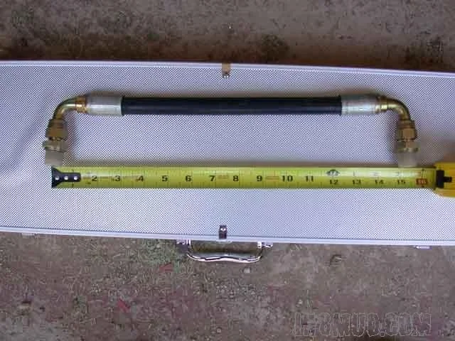

Sam, hope this helps. This is a pic from Bsevans' writeup on his making of the return hose. Mine has push lock ends on the fittings instead of a crimp as shown.
Found the pertinent post from his writeup:
The hose is a steel braided -08 Parker "Tough Cover". The centerline distance between the fittings is 15" to 15.25". I made two, and they both fit. The short one is currently in place. The fittings are 37 Deg Flared Compression Tube Fitting, Tube X Male Metric For 1/2" Tube, M18 X 1.5 straight Pipe. McMaster-Carr p/n4545K223 at a cost of $11.44 each (pg 144). The hose with two 90 degree crimp fittings installed plus two steel caps so I can remove the hose without having to remove the adapters was $35. About what you would pay at either MAF ($55) or SOR ($65). This hose is meant to carry hydraulic fluid that is above 200 degrees. The fittings from McMaster-Carr have an outer steel washer with an inner rubber o-ring that seals against the tranny and transfer fill ports.
