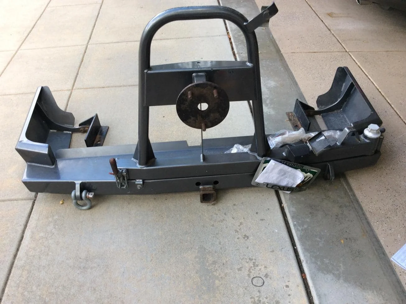

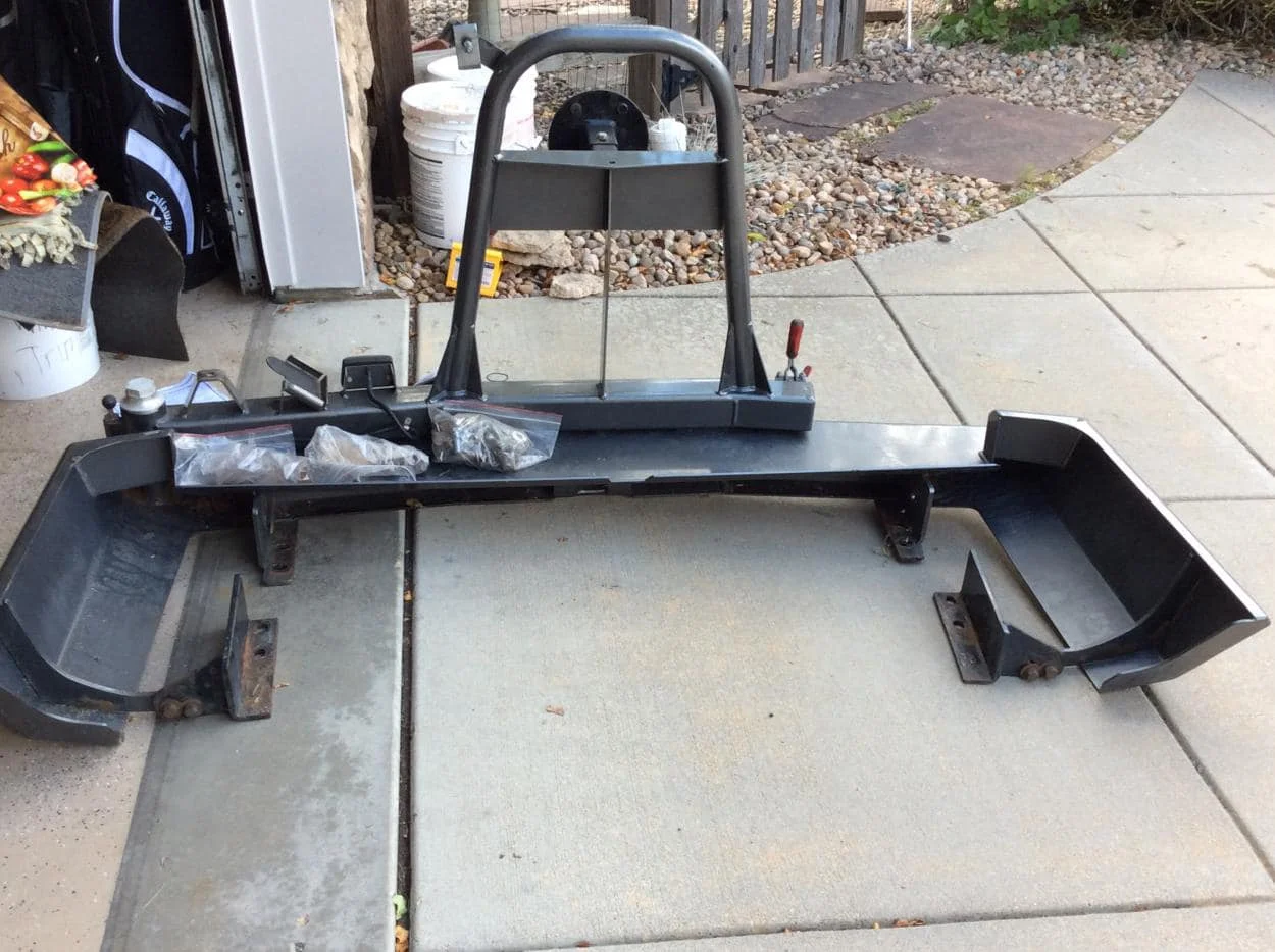

It's advertised for a 1998 - Any reason that it wouldn't work on a 2000? And it is obviously an older model - does anyone know if it requires cutting or is it a straight bolt on?
There’s no need for a receiver hitch. I’ve hauled 5500lbs over the sierras with that bumper hitch. Basically the usable capacity of our rigs. Ditch the stock receiver.
Ditto that, have over 20k miles towing 4000lbs on and offroad with both the single and Slee's dual swingout bumper on the 100. The slots in the underside of the bumper will only fit a pretty small shackle link (3/8" WLL 3600lb) for safety chains.

OP- randomly found the same pics in this listing from 2014 in rising sun 4x4...
What a great looking bumper. Love the centered carrier.
Yikes! Thanks for that - same pics 10 years later makes me wonder. I think that I will keep looking.

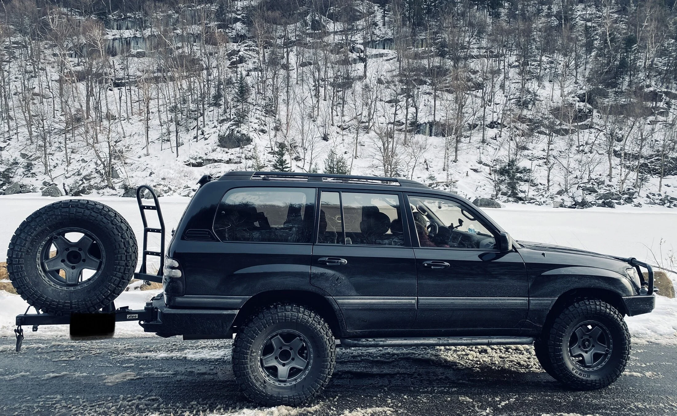

Notice the angle:

Notice the angle:
View attachment 3751021View attachment 3751023
