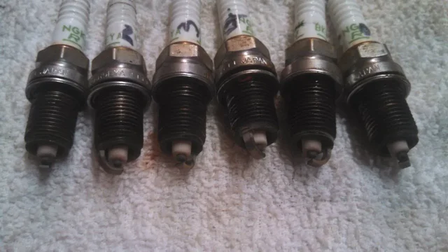

IMG_20140914_201548_980.webp Pulled the plugs and they look look clean, maybe a bit on the lean side. One thing to note is they were barely snug in the head, a couple of them weren't even snug. I can't believe there wasn't oil all over the inside of the plug housings it was that bad. Maybe a bit of compression was being lost by the plugs, I can only hope that would fix it, not likely though. I plan to install new plugs tomorrow, just the basic NGK's.
