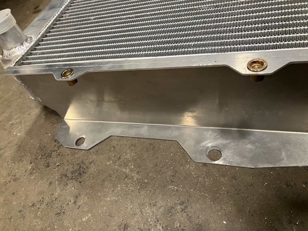

This is the radiator I went with: MT Radiator For Toyota Land Cruiser LJ70/LJ71/LJ73/LJ77/LJ78 2LTE 2.4TD Manual | eBay - https://www.ebay.com/itm/394591602292 It has mounting holes for the radiator and the fan shroud, in my case I had to modify the radiator mount since I used it in a non-stock application. I also used M8 rivnuts to mount the fan shroud, much easier than trying to get nuts on the backside of the flange. There is no radiator cap on this model, as the stock LJ78 setup has the fill cap on the thermostat housing. I don't know if fitment would be the same with a KZJ78, mine is the manual transmission version so it doesn't have the built in transmission cooler.
Mines an AT. I could add a separate cooler, but would rather not and just hook up the lines to the rad. I found a couple on ebay that work for a 1KZ-TE AT and look like the holes line up except for one of the AT lines, but I think I can just get a longer hose if it doesn't reach. Biggest thing I just want is the bracket holes to line up. I'll look at ordering the one I think will work hopefully today and let you know how it turns out. Thanks for taking the time to post the pics!!
