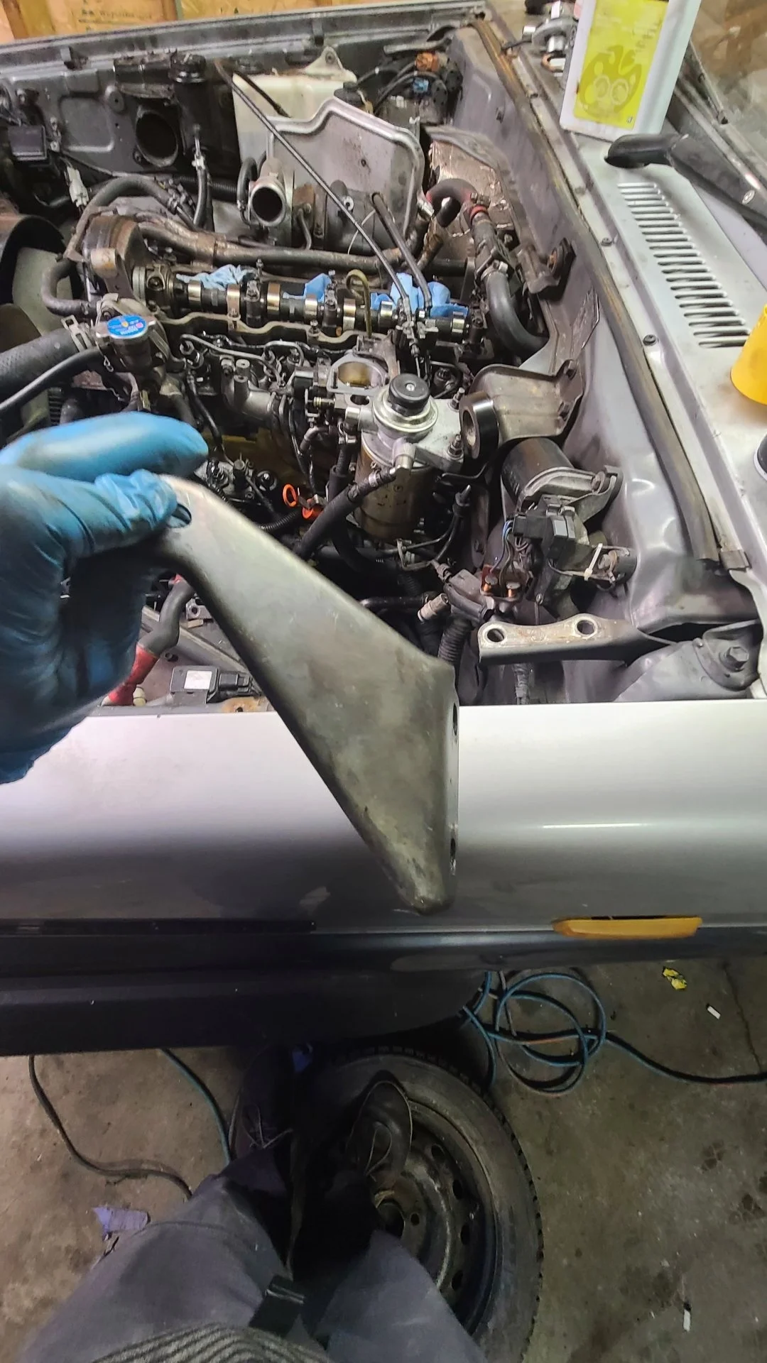

I still feel like soemthing is off with the injection timing, because I swear fuel was coming out of all 4 lines before I clocked the pump, but I double checked the timing belt/sprockets and all the marks line up. I suppose a lot of air could have gotten into the fuel system, though, in the week while I was looking for that cap for the fuel return line bolt.

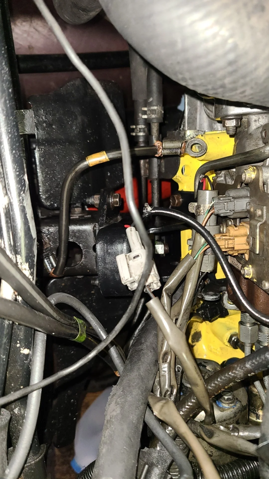

I'm just working on the LJ right now. I actually got it to start once by hotwiring the spill valve, but it was just smoke everywhere. I don't think the wore to the spill valve is working properly. I think there might be ground issues on this engine. Can you send me some pictures of where the grounds are on your engine?
For example, I have one ground that jumps from the left frame rail to the block, but that was connected to the pump bracket, and I'm not sure if that's correct. I'm also not seeing that ground cable that's in your picture with the bracket.

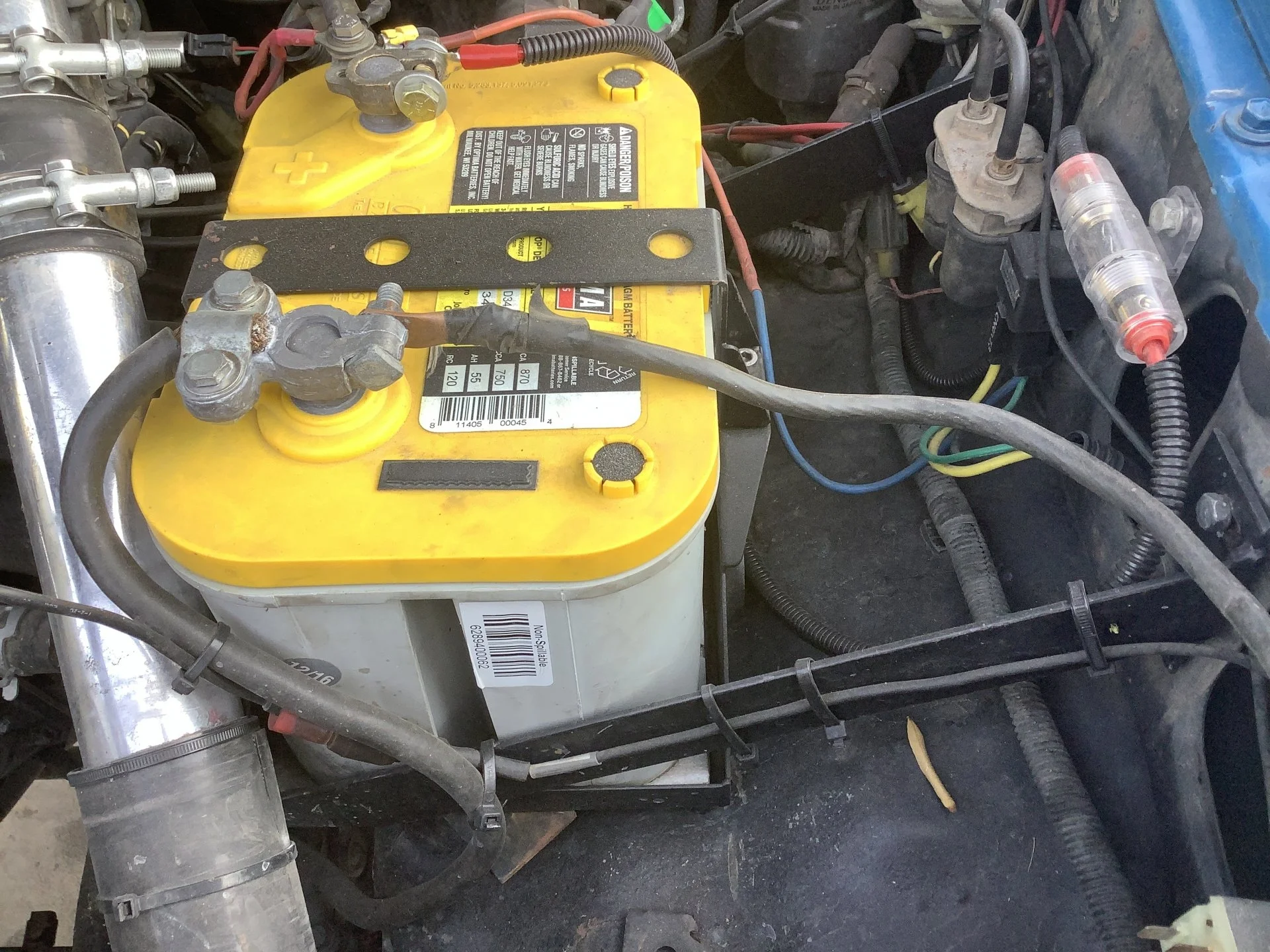

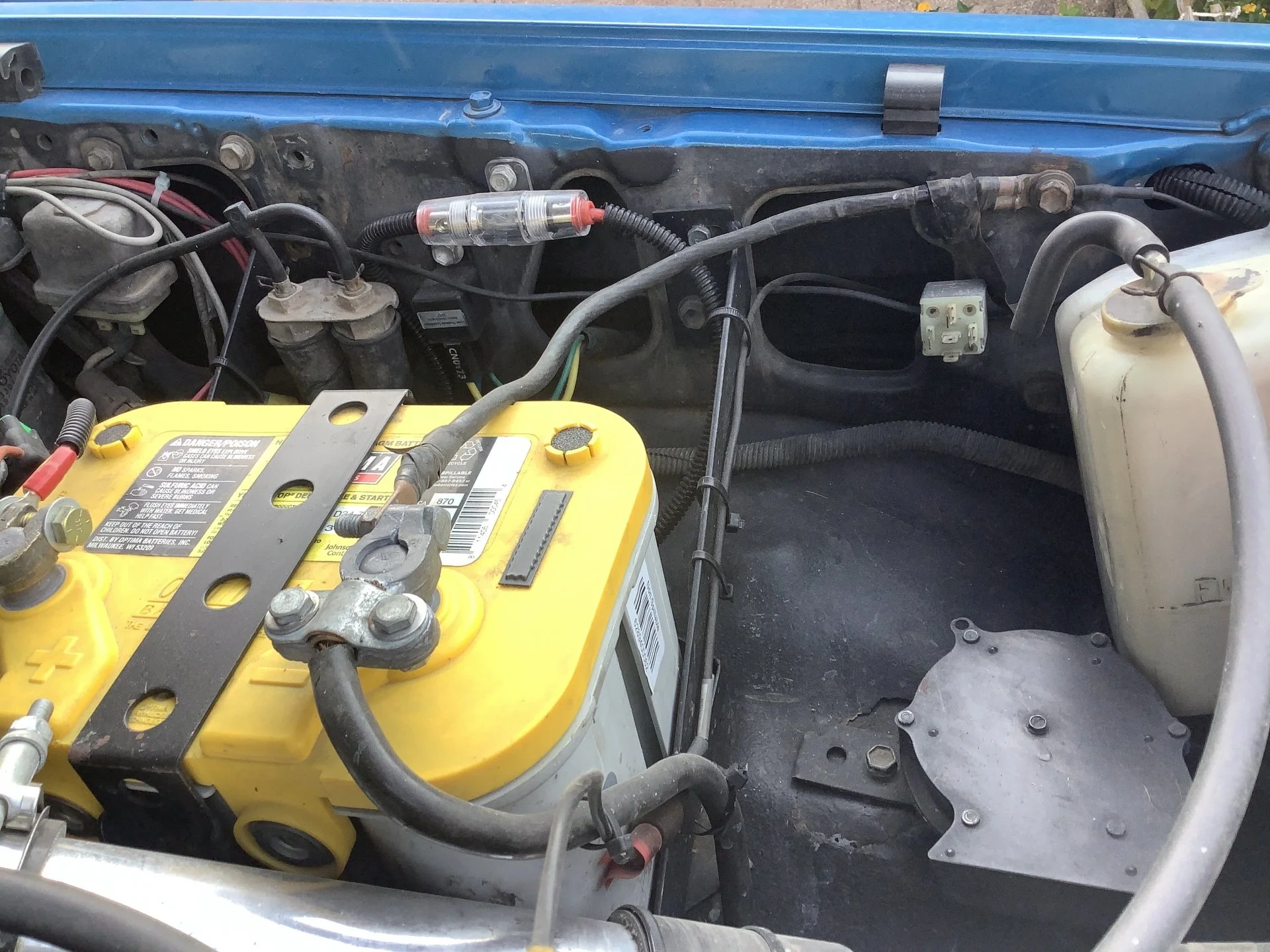

@gannex , You are looking at one of the battery grounds in the photo above. I run (2) grounds from the battery. (1) above, and another to the left fender.

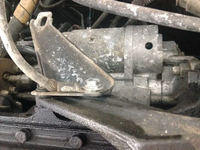

I have that ground bolted onto the starter. Is this incorrect?
There is another ground wire on the left frame rail. It was originally bolted to the bracket for the injection pump, but I think it should be on the block.

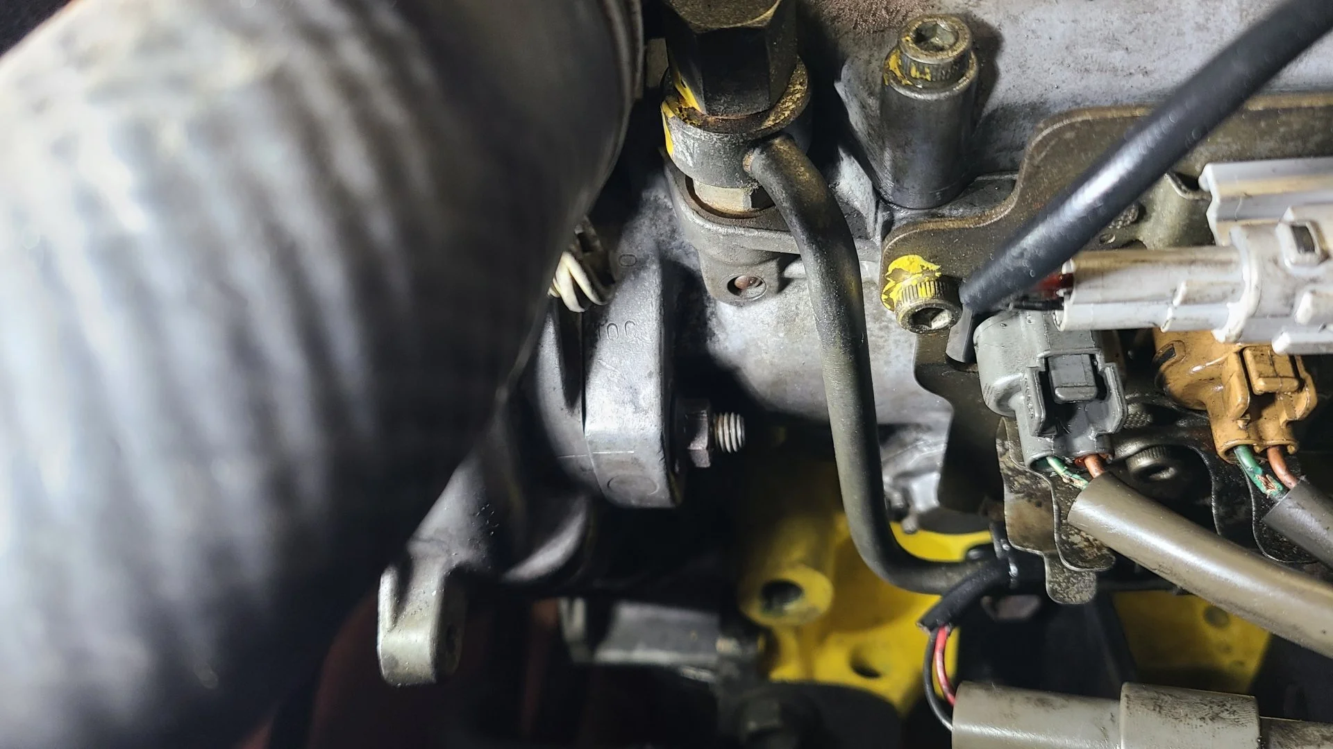

OK so I found the relay for the spill valve and tried unplugging it and testing the signal at the spill valve plug, and it indeed comes on and off, so I think the wiring going from the harness to the spill valve is intact. I am pretty sure this means the ECU is not sending the right signal to the injection pump.
I brought the truck to a friend's shop (they're big rig mechanics) and they checked through the wiring harness. Unfortunately, I can't find the correct pinout for the ECU (there is one translated from Japanese posted on here, but the colours of the wires don't seem to match mine). Anyways, we eventually got fuel coming out of all 4 lines, and they confirmed that the timing is correct, so I think I have done everything correctly.
