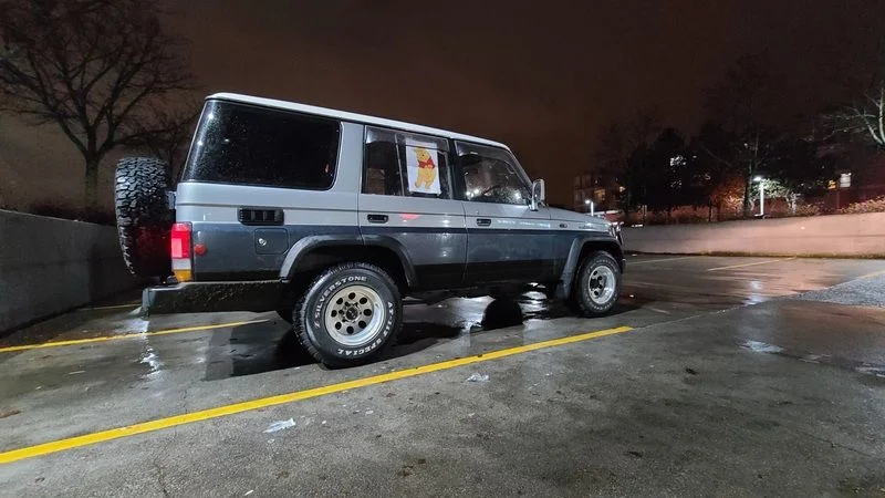

The old Samurai awakens:
Surf:
Here's what we've done so far:

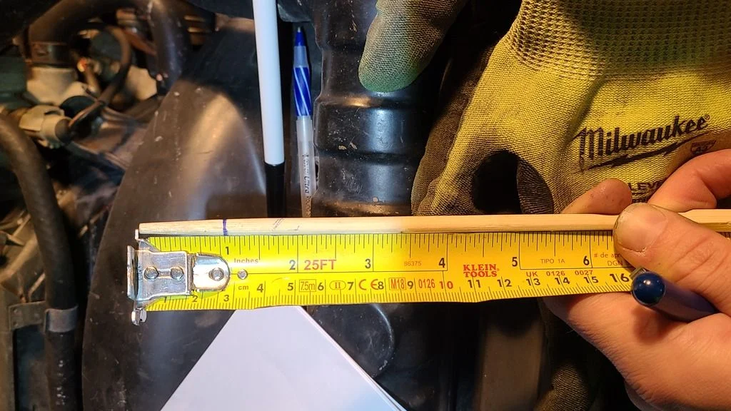

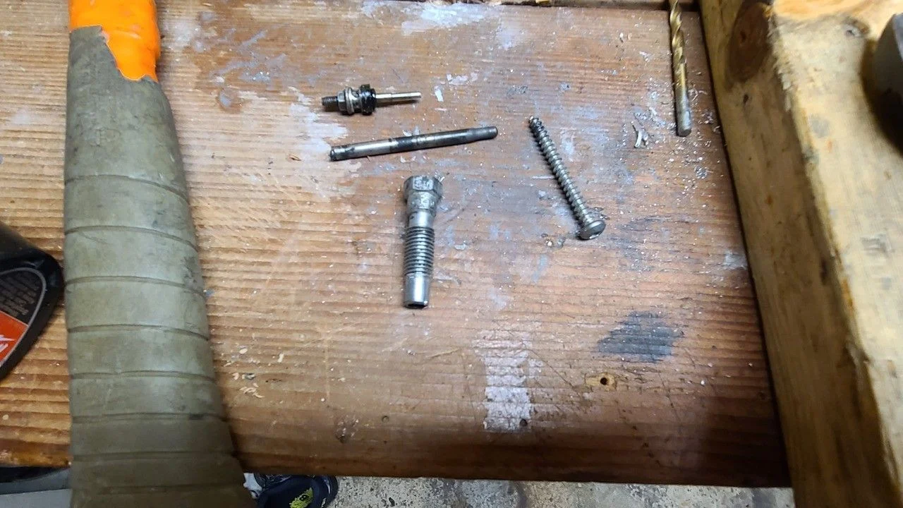

OK so I bought some tools today. I didn't have time to take the injectors out yet, but I removed the turbo to manifold pipe and the glowplug power rack and inspected the broken glowplug tip.
OK so the broken glowplug tip is on cylinder 2 and the previous owner just plugged the hole in the cylinder head with a bolt:

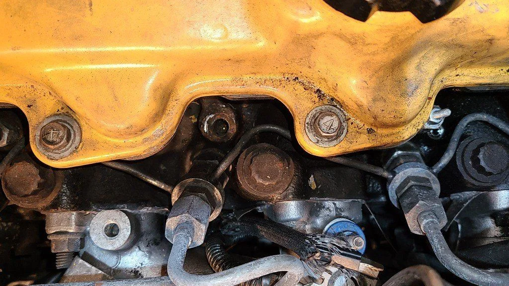

I pulled the bolt and took a photo of the hole:
I measured the depth with a chopstick:
It's not too deep in there, so this makes me think it's a pretty long section of the glowplug element that's stuck in there. Since it's a big section and not very deep, I figure it should be pretty easy to access, so I'm thinking I might just drill a pilot hole, then screwing a deck screw into it and pulling it out with pliers without fabricating any special tool.

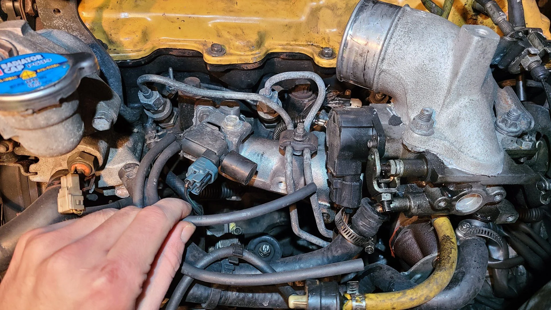

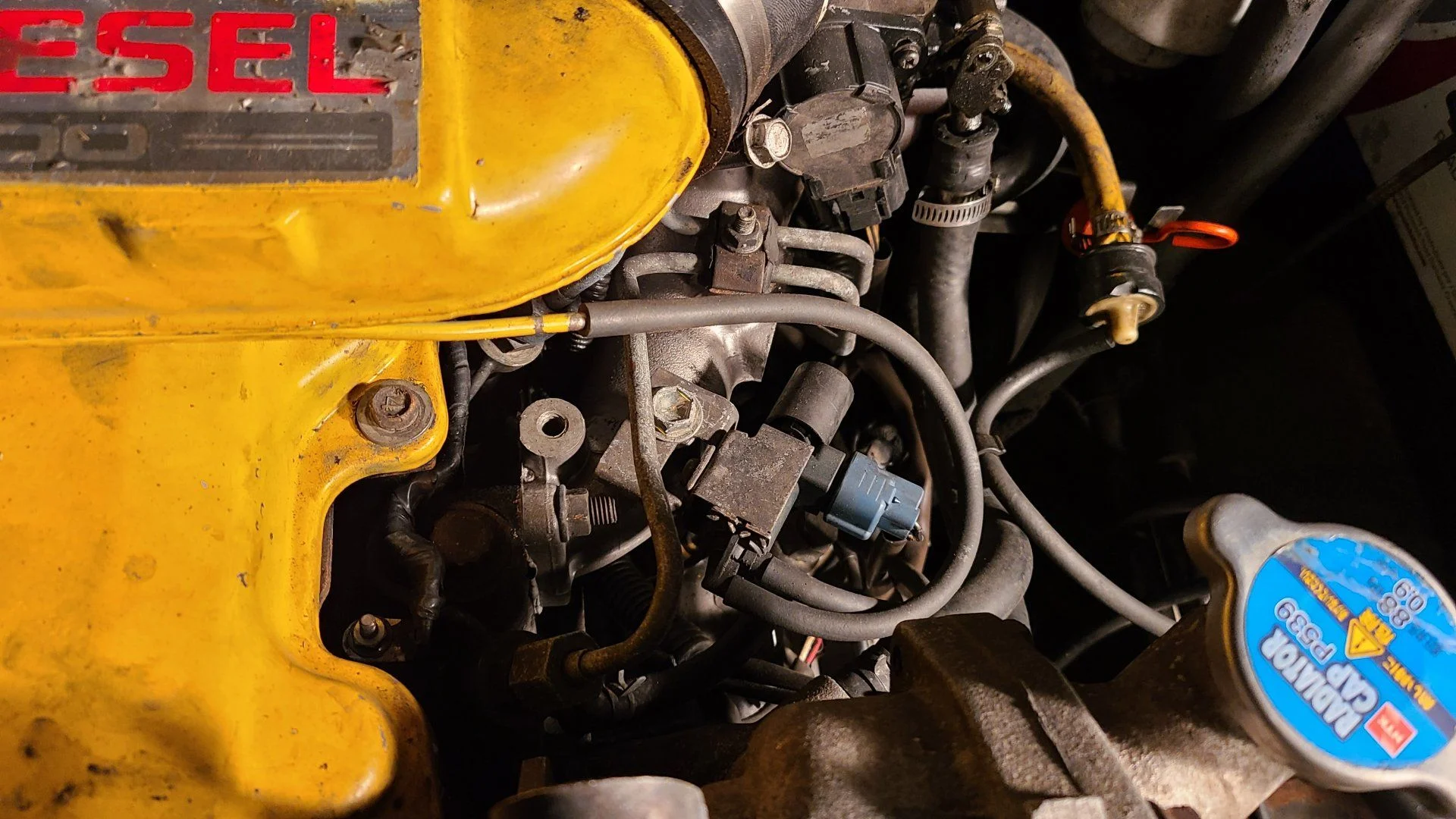

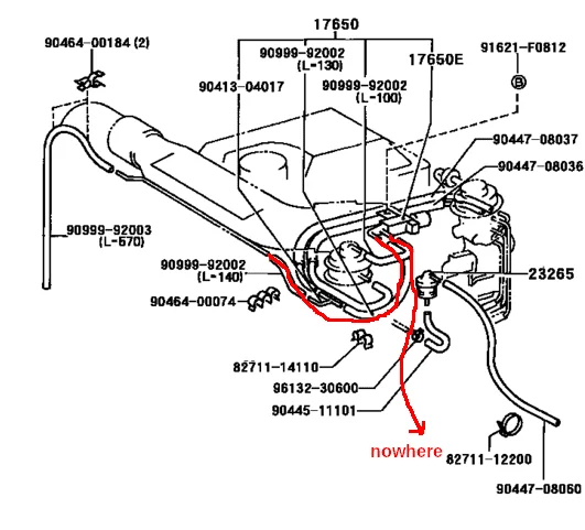

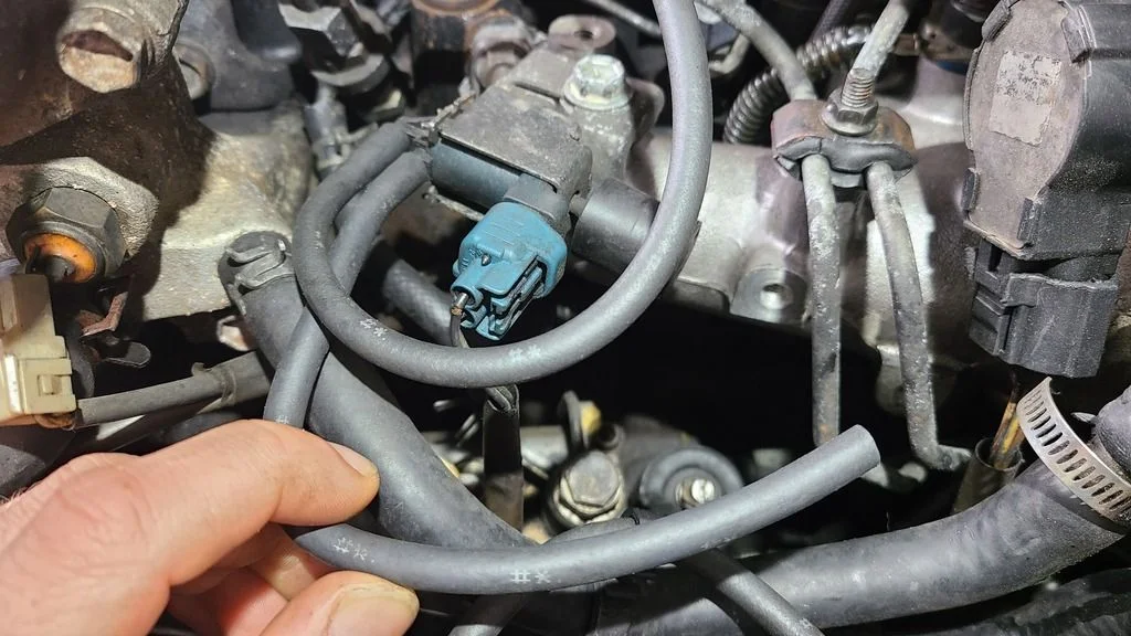

While I was poking around today, I also noticed that there is a vacuum tube not connected to anything:
I can't find it in the manual.
Do you know where this hose is supposed to go?

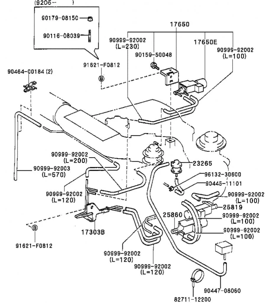

Go look on Megazip at the LJ78 drawings to figure out your vacuum routing.
Note that there is a VSV controlled butterfly in the throttle body. If your emissions is not hooked up right or working right, this valve will be closed at startup (when it should be open). This will starve the motor of air, and can very well cause the horrible startup issue you're having.
Best option is to remove the main butterfly, and remove all emissions VSVs entirely. Then your motor will get all the air it needs, and it improves performance in many ways.
I'm ultra busy and can't point you to all this today. But there are a number of LJ78 build threads that detail removal of these emissions items. And the Megazip info is easy to find.
Thanks for the info! I didn't know about the diagrams on megazip!
I wonder if this is what's going on! The emissions stuff seems to be completely absent, but the VSV is still there.
It is currently hooked up like this:
Maybe the emissions system hasn't been deleted properly?
Here is an expanded view of the vacuum routing in case that helps.
The key think is to make sure that disconnected emissions throttle plate in the intake is sitting open by default now that it has been disconnected. Pull the intake neck off (piece bolted to throttle body) and visually inspect to make sure the small throttle is open. Maybe use tie wire to keep it open using the remains of the linkage on the outside. You don't need a gasket when you put the intake neck back on. Just use a thin film of automotive silicone.
I've removed all those emissions VSV's on mine. I also removed the large throttle plate in the intake. And I removed the whole EGR system and capped it off. Lots of people have done all that and there are lots of great threads with good pictures. Just do some searching in the 70 series section and Diesel section of mud. Stuff will come up. If you don't have much luck, use google to search instead using the term "ih8mud" in your search parameters.
@gannex , You said, "so I'm thinking I might just drill a pilot hole, then screwing a deck screw into it and pulling it out with pliers without fabricating any special tool."
I like the idea of drilling a pilot hole, but not so much the idea of screwing in a deck screw and pulling. You may destroy/damage your threads on the head for the glow plug by pulling. There is a "special tool" called an Easy-Out Extractor and it is pretty easy to use and not very expensive. Get a known brand name extractor like Irwin or Bosch or comparable. Use a quality drill bit as well for your pilot hole. I wouldn't go less than 1/8th and probably at least 3/16th for the pilot hole. Use the largest bit you can compatible with the extractor size. Put some oil in the hole prior to drilling. You do not want to snap the drill bit in there or you will have additional problems extracting that broken glow plug. Just take your time here and drill true.
Here is a video on the general idea of how to "extract a broken fastener":
@gannexI like the idea of drilling a pilot hole, but not so much the idea of screwing in a deck screw and pulling. You may destroy/damage your threads on the head for the glow plug by pulling.
With a great deal of effort, I was able to get the element out of the threaded jacket of one of the old glowplugs.
I was thinking I could screw in this old jacket and use it as a guide for the deck screw, like in this thread, but I guess that wouldn't be compatible the idea of using an easy out extractor. The other thing is that the inside of the glowplug tip is ceramic, not metal, so I'm not sure if that's what the extractor is designed for.
