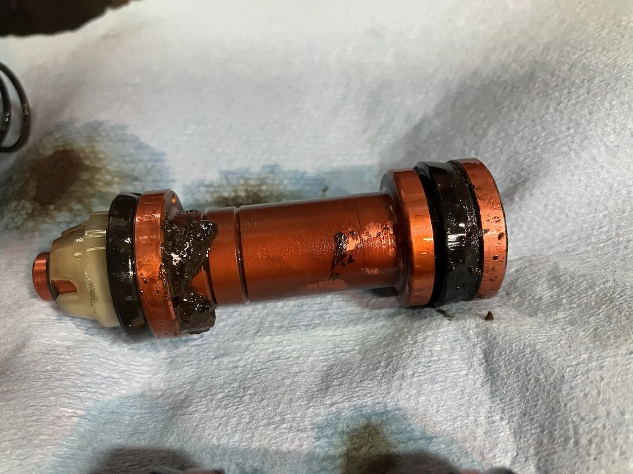

Well, upon further consideration I decided to just get a master cylinder rebuild kit and go from there. Parts came in from @cruiseroutfit on Monday and this evening I pulled the original master cylinder out. Definite evidence of leaking past the seals to the booster, though whether fluid actually got into the booster or just leaked out the bottom I can't tell yet.
Inside the master cylinder there was a huge buildup of nasty gunk on the pistons:

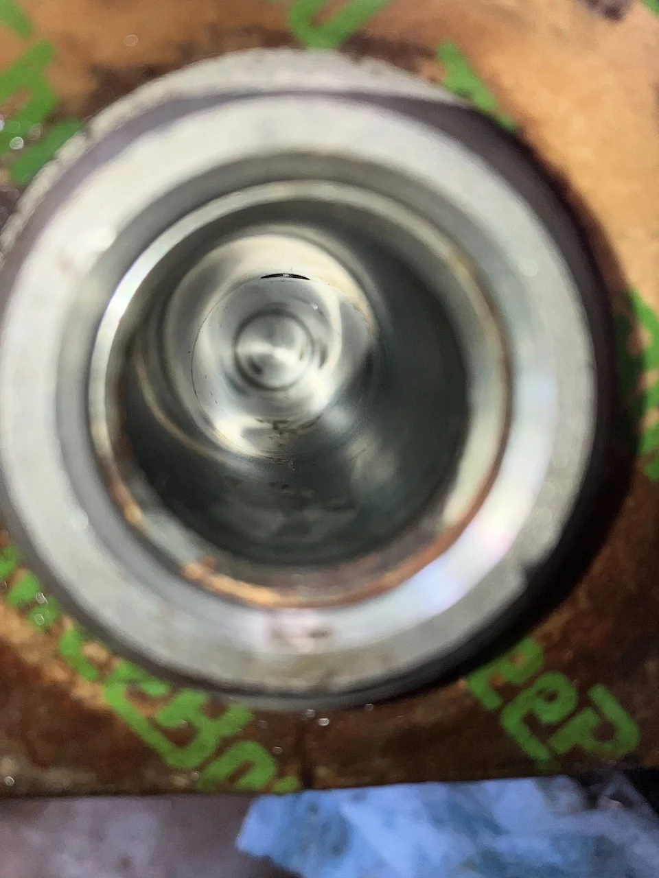

Unfortunately while most of the bore looks great there is pitting along the bottom. I am going to try honing the cylinder to see if I can remove the pitting without taking too much out of the bore, but I am not hopeful. Looks like I may have to go the 80-series upgrade route after all.

Spent some time with the brake cylinder hone this evening and it became apparent that the pitting is too deep to hone out.
Weighing the various options I think that going to the 80-series booster and master cylinder is the best route to take. I considered trying to make one of the other 70-series style MC's work, but that would require almost as much modification as the 80-series setup with no performance gains. Currently trying to hunt down an FJ80 booster that doesn't cost a small fortune!

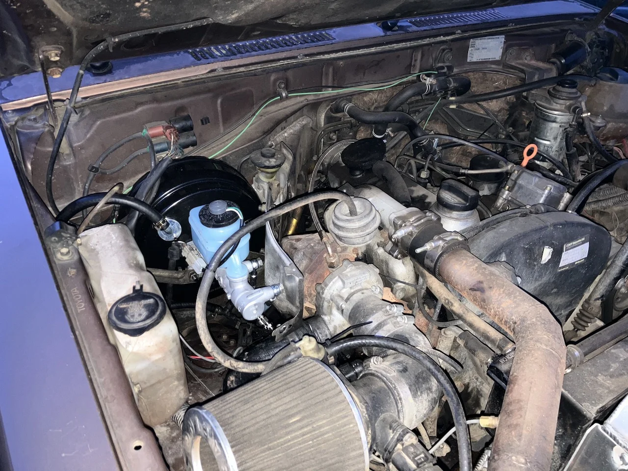

Figured I should update this thread. I purchased a new aftermarket 80-series dual diaphragm booster, new Aisin 80-series MC and installed them with some stainless, banjo/-3AN lines and -3AN/10mm inverted flare adapters. Everything fit up nicely, the booster clevis rod was the perfect length to attach to the pedal without modification, the factory heat shield fit with a couple of minor tweaks, and the vacuum port on the booster was even in the original location.
I bled the master cylinder and braking system as per the instructions in the FSM, but braking doesn't seem to be all that great. The pedal is quite soft, stopping power is adequate but not great; certainly no better than the original setup before it started leaking internally. I've adjusted the booster pushrod, but probably need to bleed the system once more just to make sure and then readjust the LSPV. Pretty sure the front brakes are doing the bulk of the work.
One very odd thing I've had happen several times now is that all four brakes will occasionally stick on slightly while driving. I can just feel them catch when coasting to a stop, can smell them getting hot after a few minutes, and can feel the engine bog a bit and struggle in 4th and 5th. The pedal feel changes too: it will get significantly firmer when the brakes stick on. After a few minutes of driving they will unstick again. I've checked to make sure it is all four brakes; they were all quite hot when I stopped and felt the rims.
The last upgrade needed is an additional vacuum reservoir since the new booster uses a lot more vacuum than the original. A few hard pumps of the pedal in quick succession will drain the reservoir.
