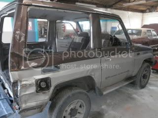

I brought the Truck cheap, completely stock of a lady owner who had hit some ice,went up a bank and lay the truck on its side.
It was easily repairable but going to cost alot for parts.
I always regret each time I sell a ute because there so bloody handy...

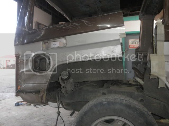

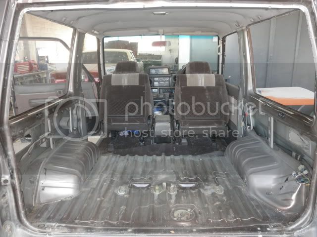

So I decided to stripped the back out and chop it in half.. :D
sorry about the different sized photos..something I can no longer change.

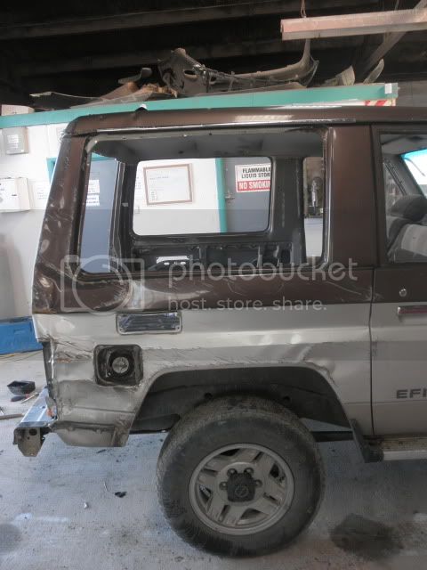

I was being a cheap arse so I used the old roof and folded it up into a back panel.
I didnt get any close up pictures of it but you can see here I sectioned the C Pillars and moved them forward to give the B pillars a nicer shape.

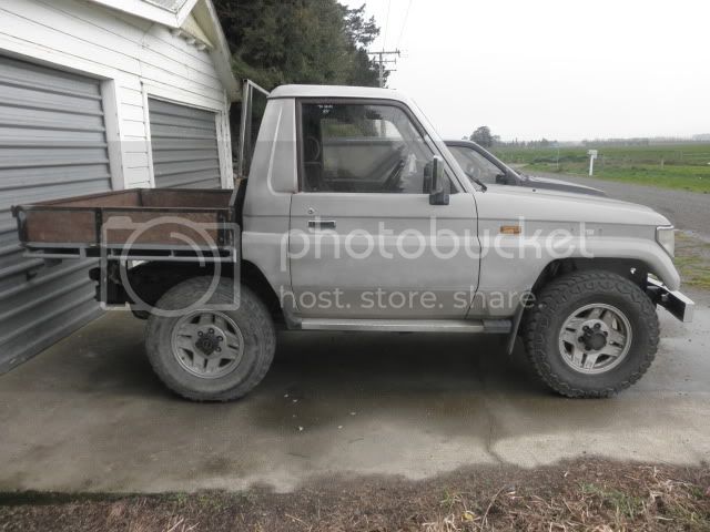

Finished the body work, got it in primer and got it Certified for road use. This is required here in New Zealand if you are going to modify a vehicle and make it road legal.
The deck/tray/bed (depends which country your from):D
is just from and old Mitsubishi ute that a friend had laying around.
Shortened it and as it turned out was the perfect width.

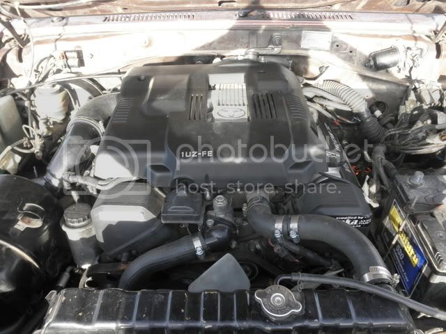

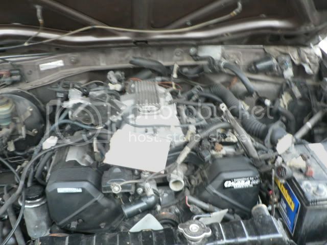

The 1UZ in the hole.. I got a mechanic mate to do this for me. He managed to squeeze a 1UZ into his KE30 Corolla so figured he'd be the man for the job!

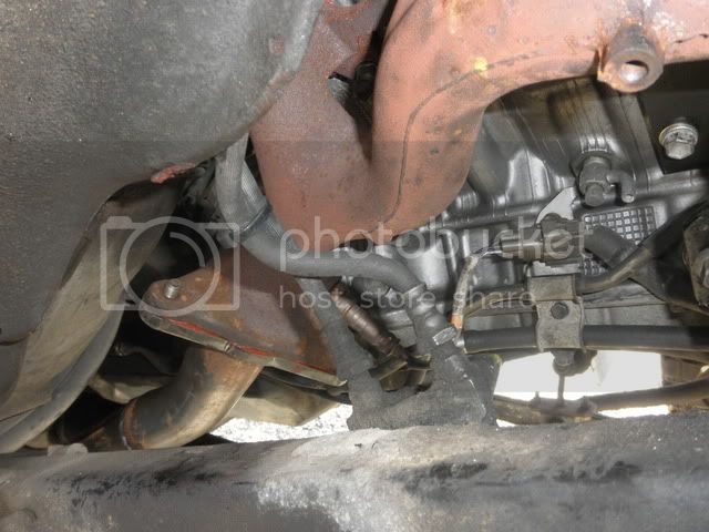

The engine is a front sump 1UZ from what I believe is a Toyota Crown. I got told to get a front sumper by another guy here in NZ who had done this conversion. I think he had a Mid or Rear sump and had to do a fair bit of modifying, It also has a Viscous fan which took a while to track down.
My modified sump. Real easy just to notch a section out of the steel part of the front sump instead of modifying the alloy part like on the rear sumps.
The factory headers, albeit restrictive fit very nicely inside the LJ71 chassis rails so I just stuck with them. Them do have a big ugly flange but theres still plenty of room to bolt the rest of the exhaust up to them.

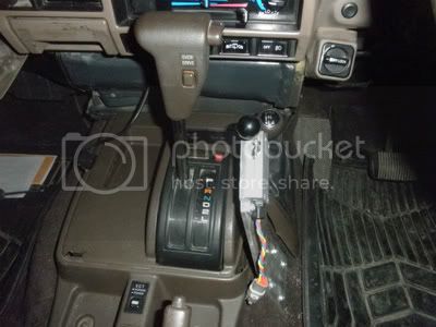

This is the Trans Controller mounted inside the cab, its not real pretty but is comfortable. I just rest my hand on the Auto shifter and flick through the gears with my fingers. Great little product!

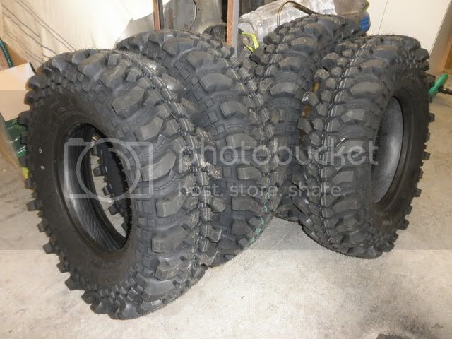

And then ordered some 33/10.5/16 Silverstones MT117 Extremes

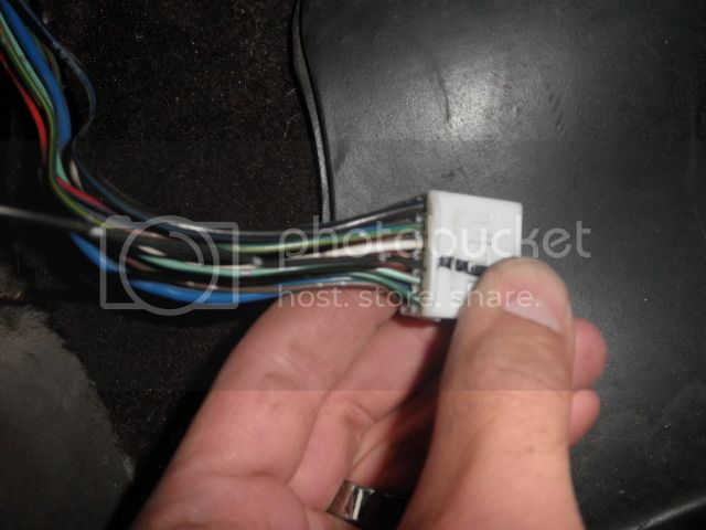

It took a while to get it wired up as I had a guy doing it as a perk. Most shops in town weren't interested in doing the job because it'd take up too much time so it was worth the wait. I went with a Megasquirt ECU that a guy here sells with a basic 1UZ tune already on them so it was just wire up and away you go..

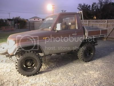

I was sick of the awful ride with the 80series springs so I purchased some Ironman 2" lift springs and shocks. They are a great riding combo but with the back cut off the Landcruiser it was sitting around 1 1/2" too high in the rear. I picked up some Dobinson 3" front lift springs and fitted them. They were better...
Here flexing up the Ironman kit once fitted with the 33s.

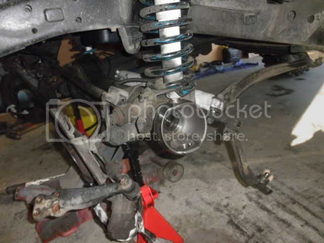

I had picked up some Toyota Hilux (pickup in America?) complete front stubs with good Aisin manual hubs and finally got motivated enough to fit them. Needed new front discs so was a good excuse to do everything at once.
All nice and shiney with my 28mm bolt on wheel spacers fitted too.

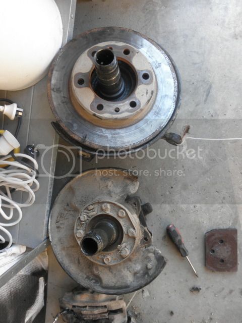

The problem with the electric hubs is that the wheel hub is shorter, so there is no room behind a free wheeling hub for the locknut assembly. Fitting a spacer is possible but not very strong. One solution, developed by Oldblue, is to fit a sealed manual drive to the outside of the electric hub - operated by an allen key. The solution I decided on was to use some Hilux parts & fit standard Hilux Aisin hubs.
Hilux hub on left, cruiser on right.

Unbolt the old electric hubs, take off the circlip, remove, then undo the lockring & take off the wheel bearing nut. Fish out the outer bearing race. With a bit of wiggling the hub should pull off.
The old Hilux disc will most likely be solid, the Prado brakes are vented. You need to remove the disc from your old hub. The studs go through the disc & press into the hub. To remove the studs find an old wheelnut you don't like to thread onto the studs before you bash them out with a FBH. Some discs also have a couple of bolts holding them on. Put your original discs on your new hub & press or FBH the studs back in.
As far as I could tell the original hub spindles would work with the new hubs. However I decided that the Prado spindles with the conductors for the hub drive running up the centre & the extra slots in the end for the brushes, didn't look as strong as the Hilux ones I had on hand. I took off the brake backing plate & original spindles, cutting off the wires that feed into the spindle. I took out the axles while I was there & packed some fresh grease into the CV's & all around. A healthy dollop of RTV was required to bung up the hole where the wires went in, & also a smear of sealant around where the spindle bolts on.

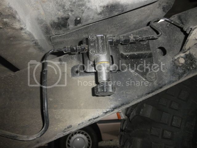

I wasnt happy with my brakes so after reading up on here I took the LSPV out of the back of the truck and fitted a Willwood Proportioning Valve, cheap mod and improved the brakes hugely.

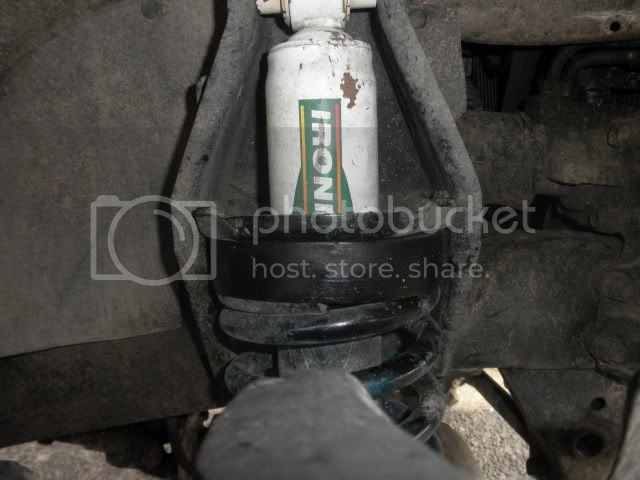

Still not happy with the front ride height I got some 40mm 75series Coil spacers
and fitted them.
Much better..

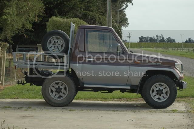

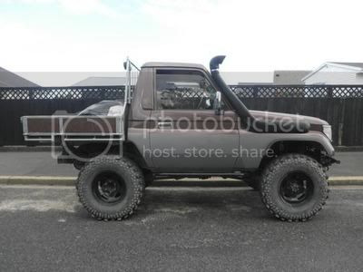

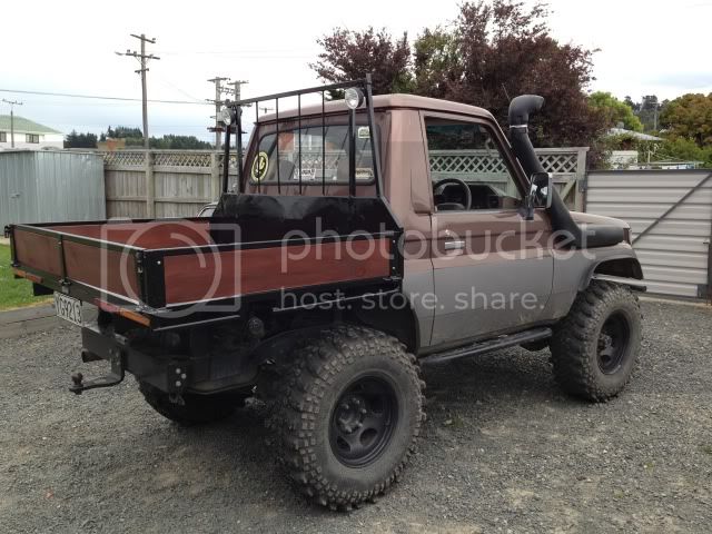

And just the other day thought Id give the deck a tidy up, some new wood and a coat of black paint. As you can probably see its had a chinese snorkel, a rear bar and some sliders fitted along the way too.

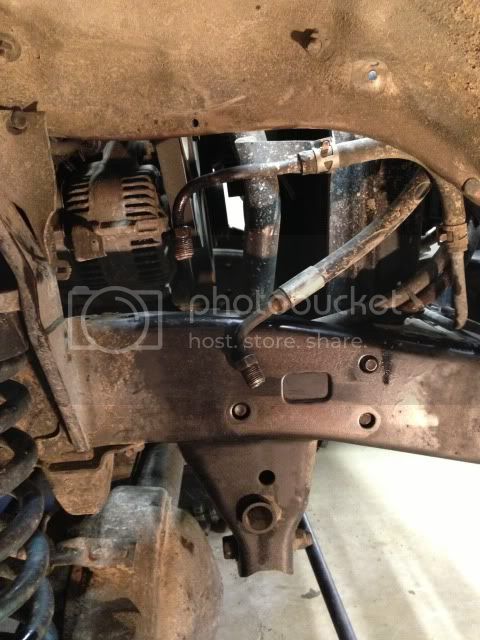

Bring this one back from the dead. LJjuz I really hope you still come around. How did you go about converting your diesel tank to Petrol? Mainly wondering how you added a vent since the diesel tanks don't have the same kind of venting system. I am worried about my tank pressurizing.
