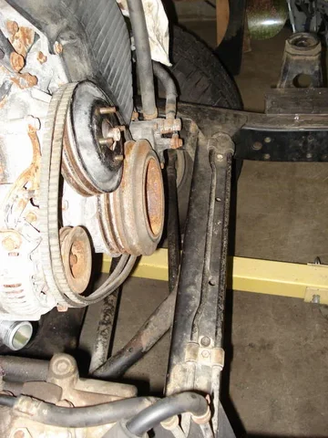

Her's a pic of the length of a hz into the bay of a LJ78 (2lte). A electric fan would probably work, but the height of the engine out of the bay might require some work (body lift/hood bump).
I used the front clip from a HD model, so clearences were not a issue.
