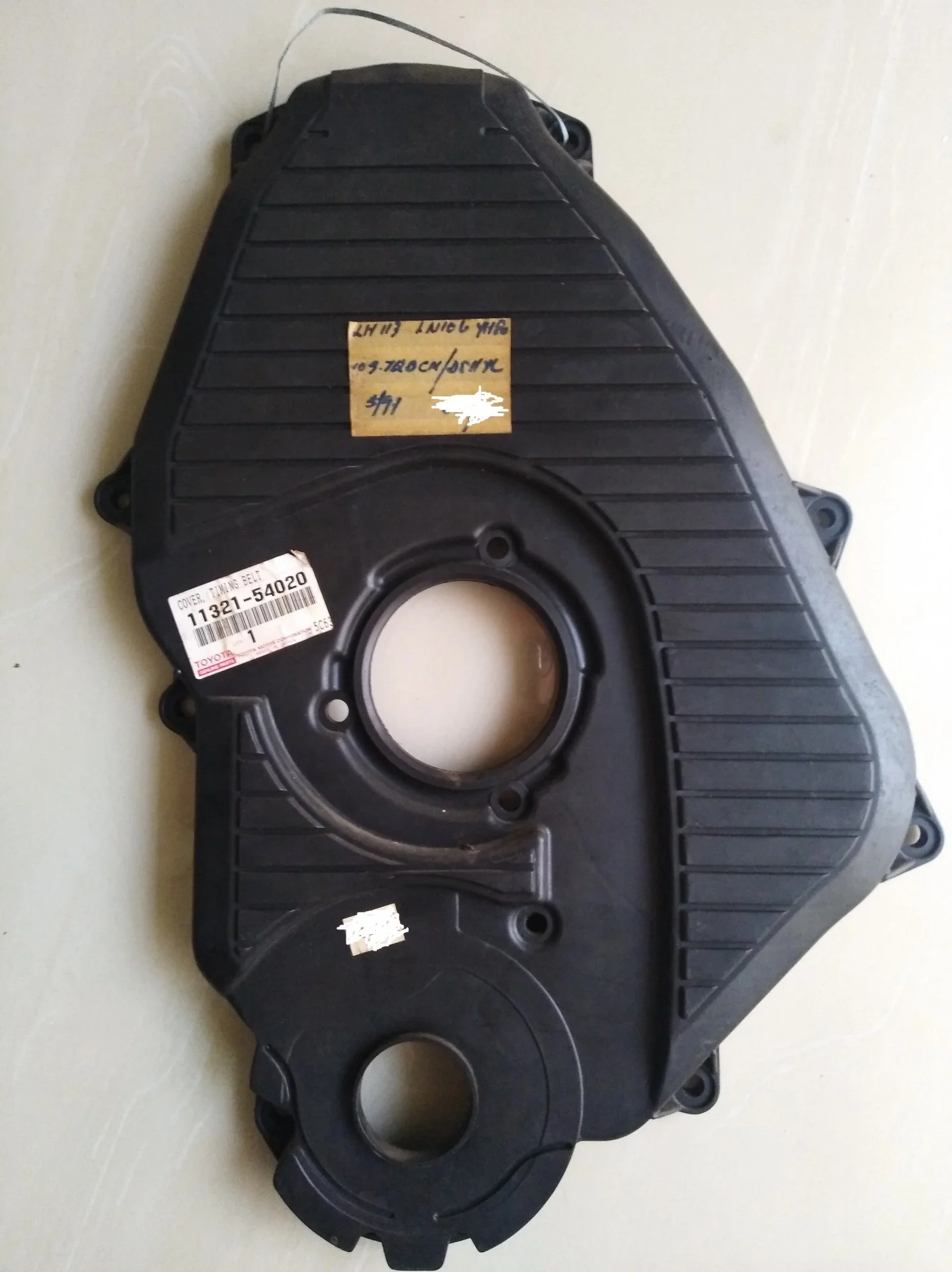

Finally got the timing belt case from a local shop. (yay!)
It is new old stock from 1991...
Old but work just fine.
Really a hassle to find... but hey, got it. XD
Junkyard ones are mostly cracked or incomplete.
