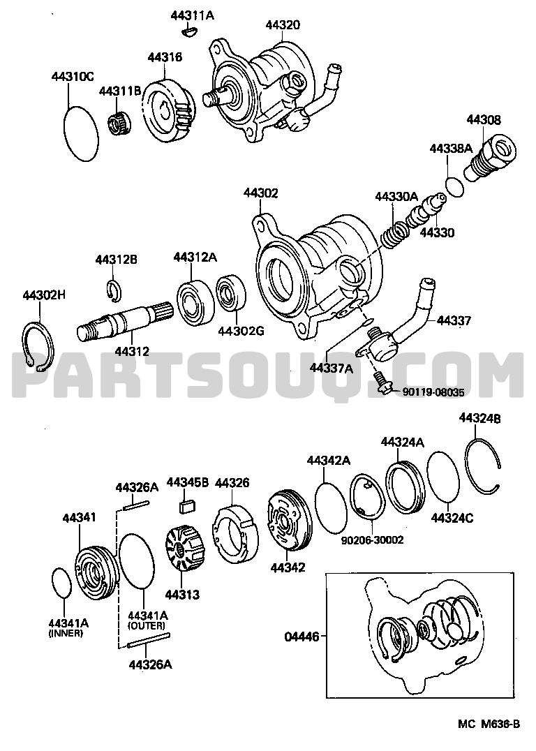

What's the key part number? Im replacing pump, key and sprocket...done messing around!
