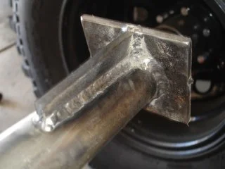

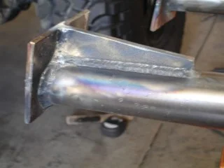

Here are a couple of welds off my sliders!
Im very pleased now that issue is resolved!
Thanks for all of your input and help!

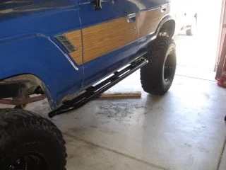

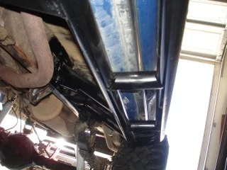

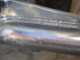

A few more!

Nice beads Keith! Do you have a tubing bender of did you have someone bend the tubes for you?
Looking good Keith.. I'm glad you got it all figured out.
Charles
I WISH!
The main body of the sliders are Marlin Crawlers...
He sends the "outriggers" un attached for custom sizing!
I added an extra outrigger making it a total of FOUR supports from the original design of THREE!
