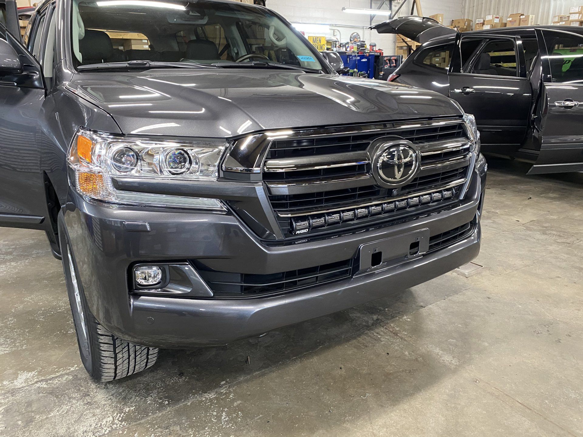

Quick video with 30” light bar mounted in the grille. Heritage grill swap for fitment.
Slick looking fitment. Great job.
Wonder what the lighting looks like at night, looking at the face of the car.
I think that I heard this in the video, but did you cut a section of the grill to get the lights to sit back that far?

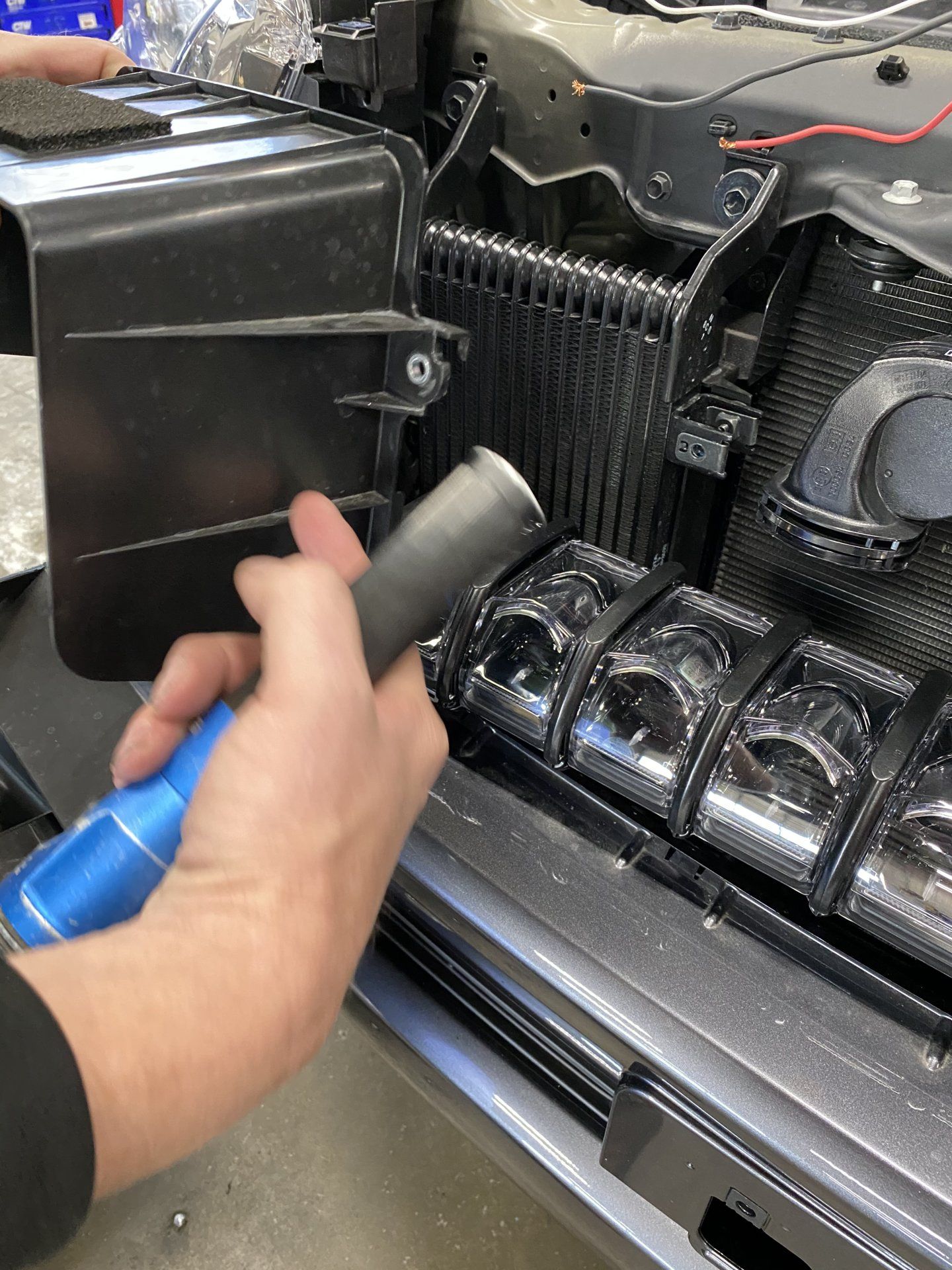

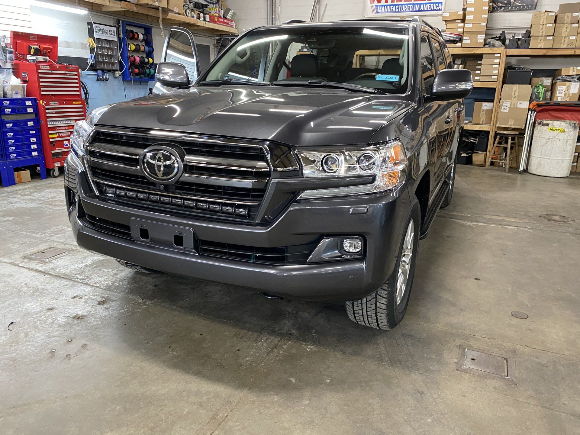

Yep, Heritage grills make light bar modification easy. A few more pics before bumper install
Thanks for the positive feedback. A few more pics here:
Looks great, thanks for the detailed pics! I will be doing the same to my HE in the near future.
If you’re not looking to do a chrome delete (or painting of the grille), you may run into some issues scarring the black-chrome where you Dremel’d the cut out. Knowing that you may have to do minor fill-in, it will be hard to match the black chrome with any kind of paint. You may be left with a slightly flawed grille or looking for a skilled hydro dipper.
Yeah, that's why I haven't pulled the trigger on cutting the grill yet. Still mulling over what I want to do from an appearance perspective. Probably make the cuts with my pneumatic body saw, it tends to cut more and melt less than a Dremel with a cut off wheel.
