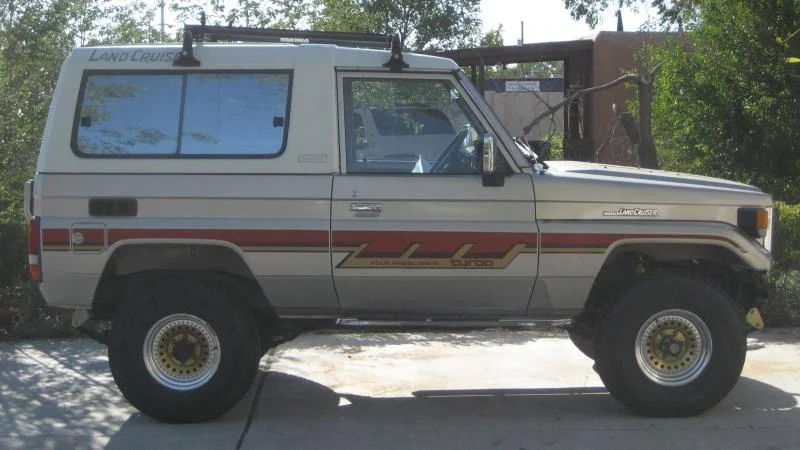

Does any one have a TRE puller or a pickle fork? Need to remove the steering stabilizer. Its on there good!
Lift numbers
Front right: 915 mm > 980 mm = 65 mm (2.55")
Front left: 905 mm > 990 mm = 85 mm (3.34")
Rear right 1031 mm > 1107 mm = 76 mm (2.99")
Rear left: 1002 mm > 1115 mm = 113 mm (4.44")
Front measurements from ground to center of headlights, rear from ground to almost top of brake lights.

I will be at American tomorrow--I'll have mine on me if you need it. Just stop by the parts department. I have both the TRE puller or the pickle fork.
Looks great. Can't wait to see it with the new tires. Size? It always seems to start with a lift then you will want something else. Can't wait to see what else you do to it.
I remember taking the stabilizer off my Hilux. I ended up cutting the thing off and drilling it out. I think a Sumo wrestler put it on.

TRE Puller was a NOGO didnt try the pickle fork (i'm sure that would have worked!) I ended up cutting and drilling - I feel your pain!!!!
is that OME? The OME Jon picked up for me in Moab lifted the rear of my troopy 2" and the front only 1/2" :(
Yes OME. CS006F in the front, and CS004A/B (medium 60 series) in the rear. Ended up taking out a leaf in the back to make it a light load CS0017A/B of sorts.
