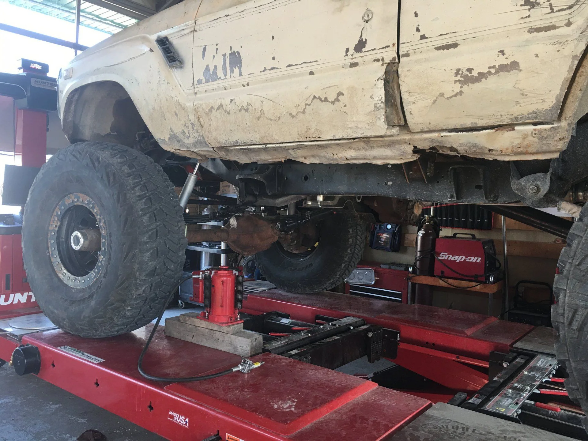

Had to do some cribbing and use a bottle jack. Which works, but on the trail not really wanting that, because the world isn’t flat.

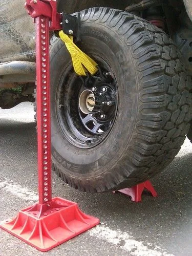

The Lift Mate allows you to easily lift the wheel out of a pit it dug itself into so you can fill the hole with rocks/wood so the tire has a firm surface to rest on. It's very effective when getting stuck in mud at low tide that wasn't quite as firm as you thought it was: Lift each tire up to fill the hole you dug and build a firmer track to back out the way you came in.
Without a Lift Mate I would have lost my cruiser for good down in Mexico. Priceless as far as I'm concerned.
Also it makes jacking up a flat tire wheel a lot easier than trying to use the dinky bottle jack under the car in the dirt or mud when the axle is too close to the ground.
I'd use it to lift the wheel off the ground then slide the bottle jack under the spring pad to use as a stand - then remove the hi-lift w lift mate to get at the wheel to remove it.

At least with my 15 inch wheels the lift mate would not work on the rear. The brake drums prevented its hooks from grabbing onto the wheel.

Hi Lift has an accessory called the Lift Mate that looks like it will fit your wheels perfectly.
Trying to lift any vehicle by the body is a loser with a Hi Lift Jack by itself. The Lift Mate is king.
Not opposed, just back loads of cribbing to brace the axle and then a jack move to take the wheel off
will see how the drum spacing issue looks, I wouldn’t have thought of that @2mbb brought up.

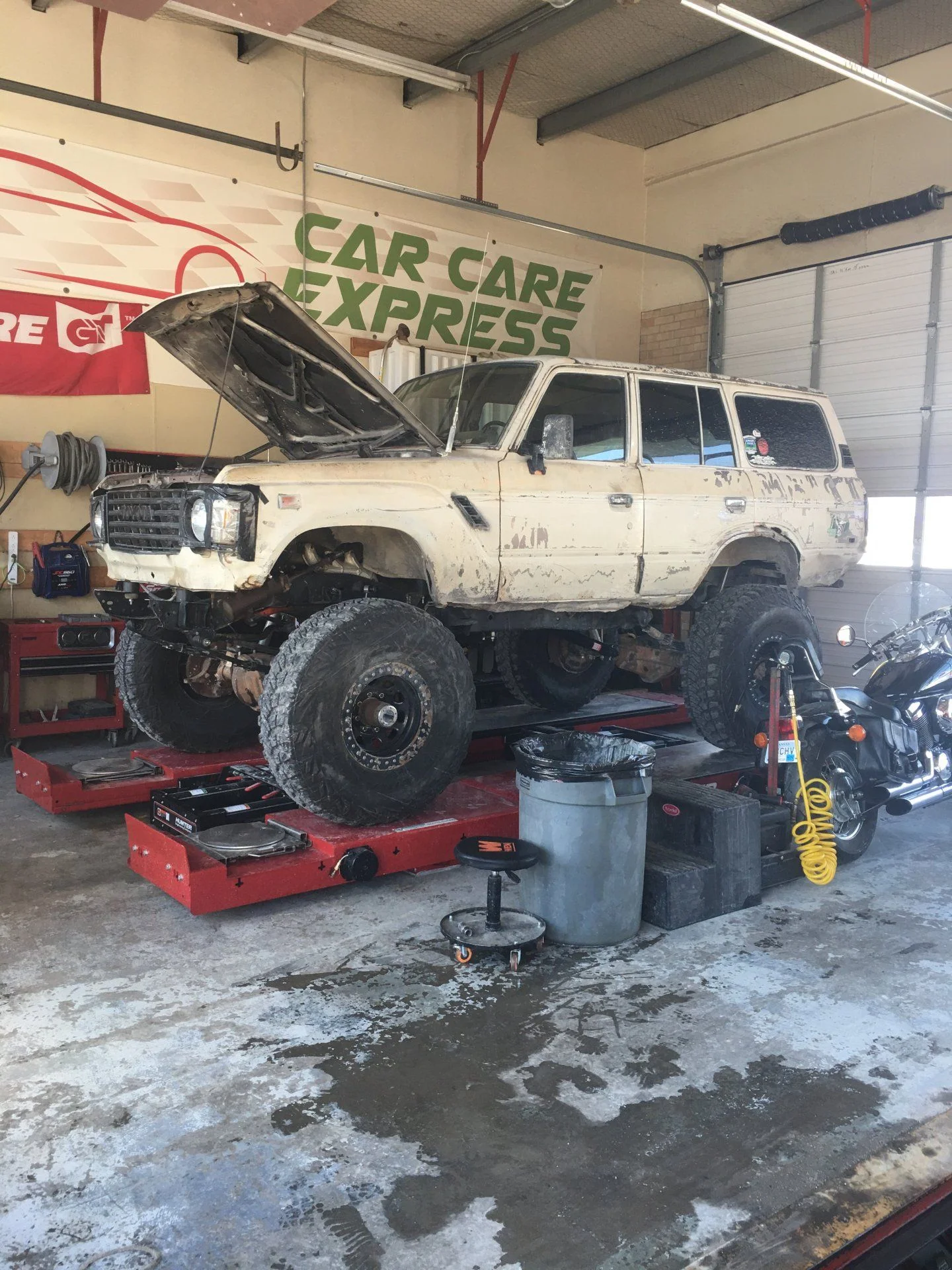

don’t worry John the first thing I busted out was my high lift and ended up using it in conjunction with the alignment rack to get the tire off the ground, no I didn’t take pictures It was sketchy enough, just get in and out hahaha

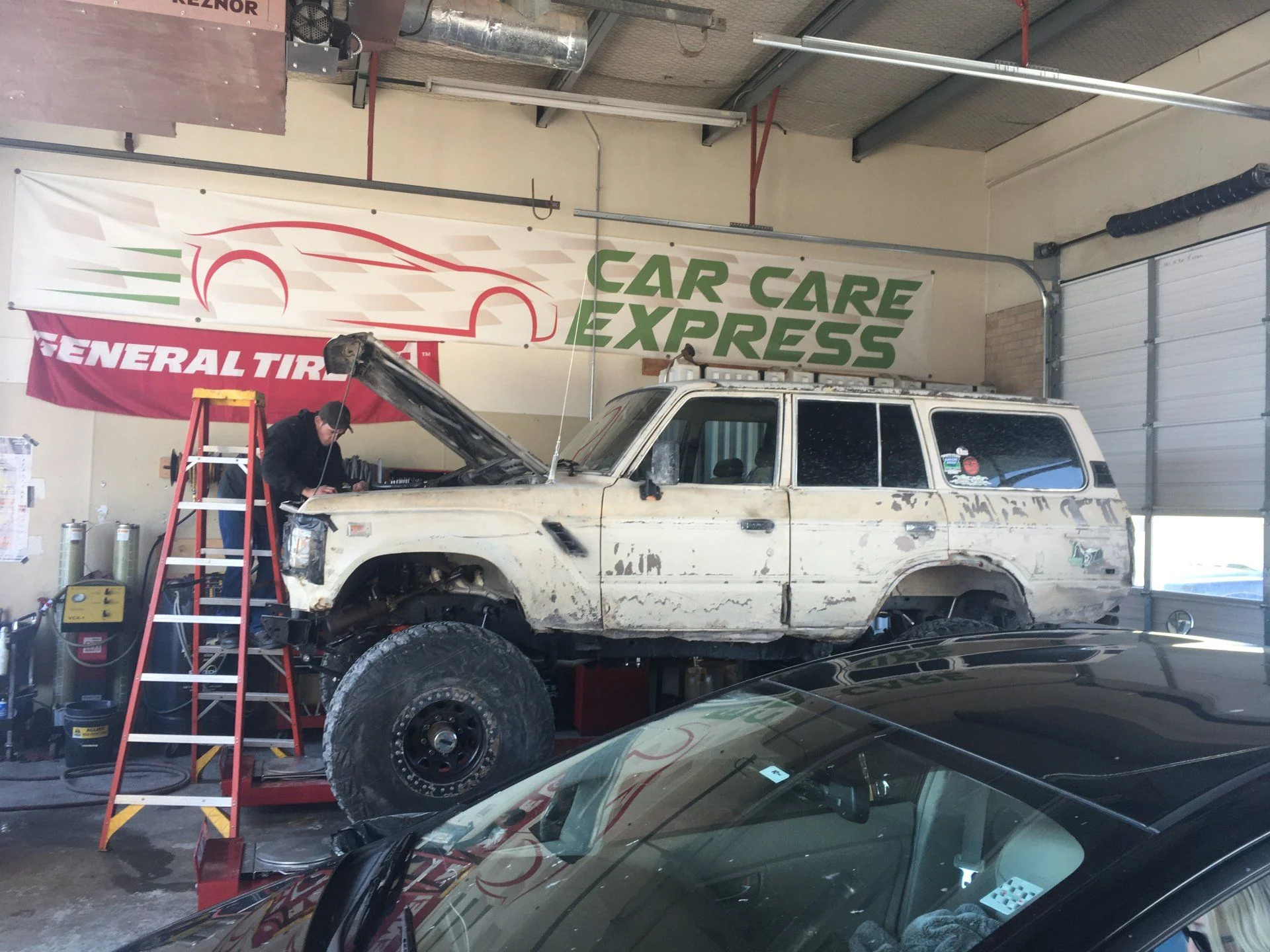

Holyhell that would be scary off-camber on slickrock. Do you have a scaffold for engine maintenance?
I just carry a 6ft ladder around now, or crawl clean in the engine bay, there no leaning over to work on things
have not gotten to slick rock yet but the back woods trails are ok, she’s fairly well planted surprisingly, but each wheel and tire combo comes in at 185lbs

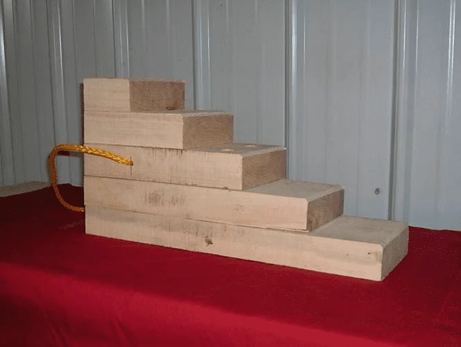

You can cut some cribbing into a wedge like this:
...make them about the same length as your other pieces. Then you can use the wedges to level up as you build on uneven ground.
Also when I was in the FD we used "step cribbing" to quickly stabilize vehicles. I could see you building step cribbing slightly higher than your frame and shoving it under the frame after you lift. Then lower the jack until the frame is resting on the step cribbing. Now your ready to fix broken stuff under the truck, change out a wheel or whatever. More stable than bottle jack on cribbing.
