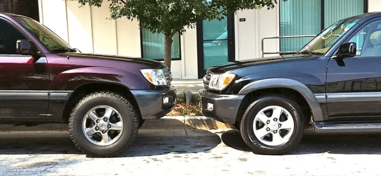

I agree with @Trunk Monkey - keep it stock. If you go a bit larger with the tires, crank the TBs up slightly, drop the running boards... It'll look like a Land Cruiser.
(I should've been counting how many times I've posted this pic)
Both of these 100s are stock. Mine (left) has the TBs cranked .75", stock in rear - no spacer; ditched the fender stickers and running boards. Tires are 275/70/18s BFGs

This is AWESOME news. I wondered if this was doable. And it looks like it totally is. Fortunately, we don't have the fender flairs to deal with and removing the running boards is definitely on the to-do list. I have already cranked on the TB's some to remove the old age droop. @Manhattan @Trunk Monkey pic above is exactly the look I want, including the tire choice. btw, I see you too are in ATL. What is the front in measurement I should shoot for? If I add the rear spacer, will the front go up high enough to compensate for the added rear height? What are the desired measurements? What size spacer do I add to the rear and who sells those? Thanks guys.

I'd do it in steps - do the tires and running boards and see how it looks. 275/70/18s fit a stock 100. If the adjustment you already made to the TBs got'er back to stock, crank a bit more. But keep in mind, these trucks like some rake - do NOT crank the front so much that the truck sits level. It will ride like absolute #$&@.
I don't have rear spacers - so, can't help there. I kept the pictured setup for a couple years... then ripped everything out and went to a new system. Kinda miss that stock truck ;)
