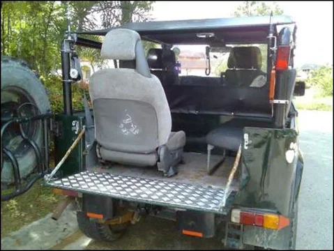

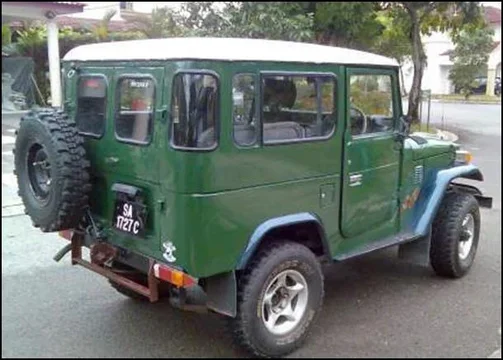

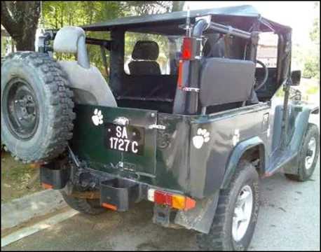

Hi Rickybobby,
This is how I did mine on the 1981 BJ40.
Sorry for the fuzzy images... BUT you will get the picture.
Before
After1,
You should see a one of the two 4 inch door hinge welded on drop
down tailgate. On the body above the rear bumper, is a 5 x1 inch
length plate welded at the edges with 3 mm spacer to allow the
other edge of hinge to be slotted in.
Holding the tailgate in vertical, I bent a "L" bracket and uses
the existing holes for ambulance door hinge, size 10 screw to
hold/pivot the "L" bracket.
After2,
Holding up the tailgate when drop down, uses chain (from
hardawre) cut to length. Bolted down to body on one end
while the other using "C" clip attached to tailgate.
This way the tailgate could be easily remove by unfastening the
2 "C" clips, unplug the wires to tailgate/number plate and slide
out the hinges.
Have fun viewing.
regards,
HelimanBD.
