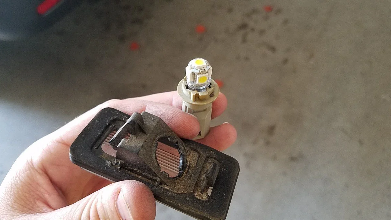

I just did mine not long ago. Mine slid to the right. Here is a pic I have of the assembly to give you an idea.
I just did this recently. If you look closely at the photo, you will note that the catch piece that holds the bulb cover in place is a good distance in from the edge. The metal opening is very small.
So you will need to slide something very flat under the cover to get to it and go further than just the edge. The bulb cover extends out well past the opening in the metal, so that connector edge isn't at the edge of the cover. Don't force that, or it will break. Just find a good but small flat head screwdriver and slide it in a good distance so it isn't forced.

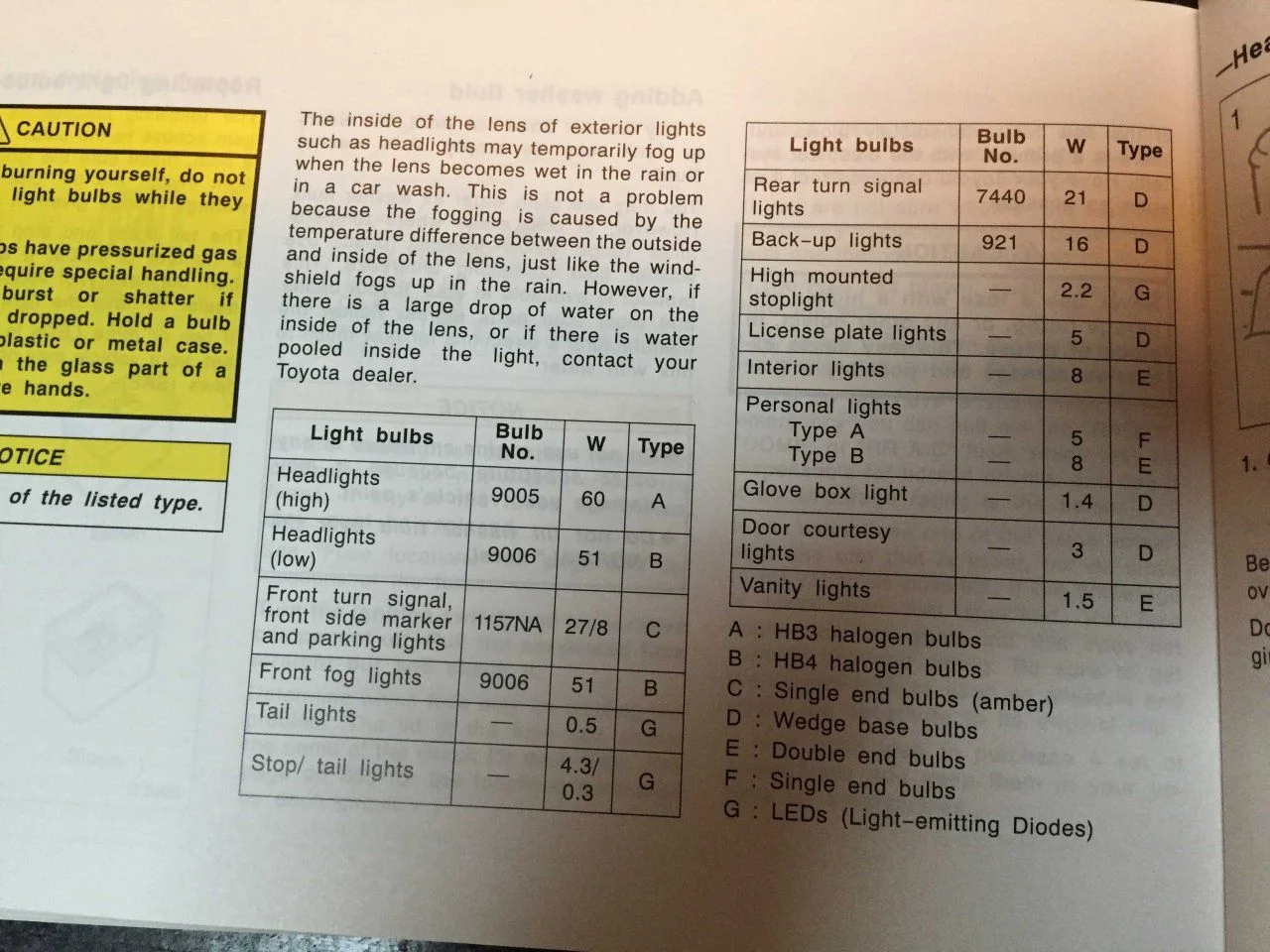

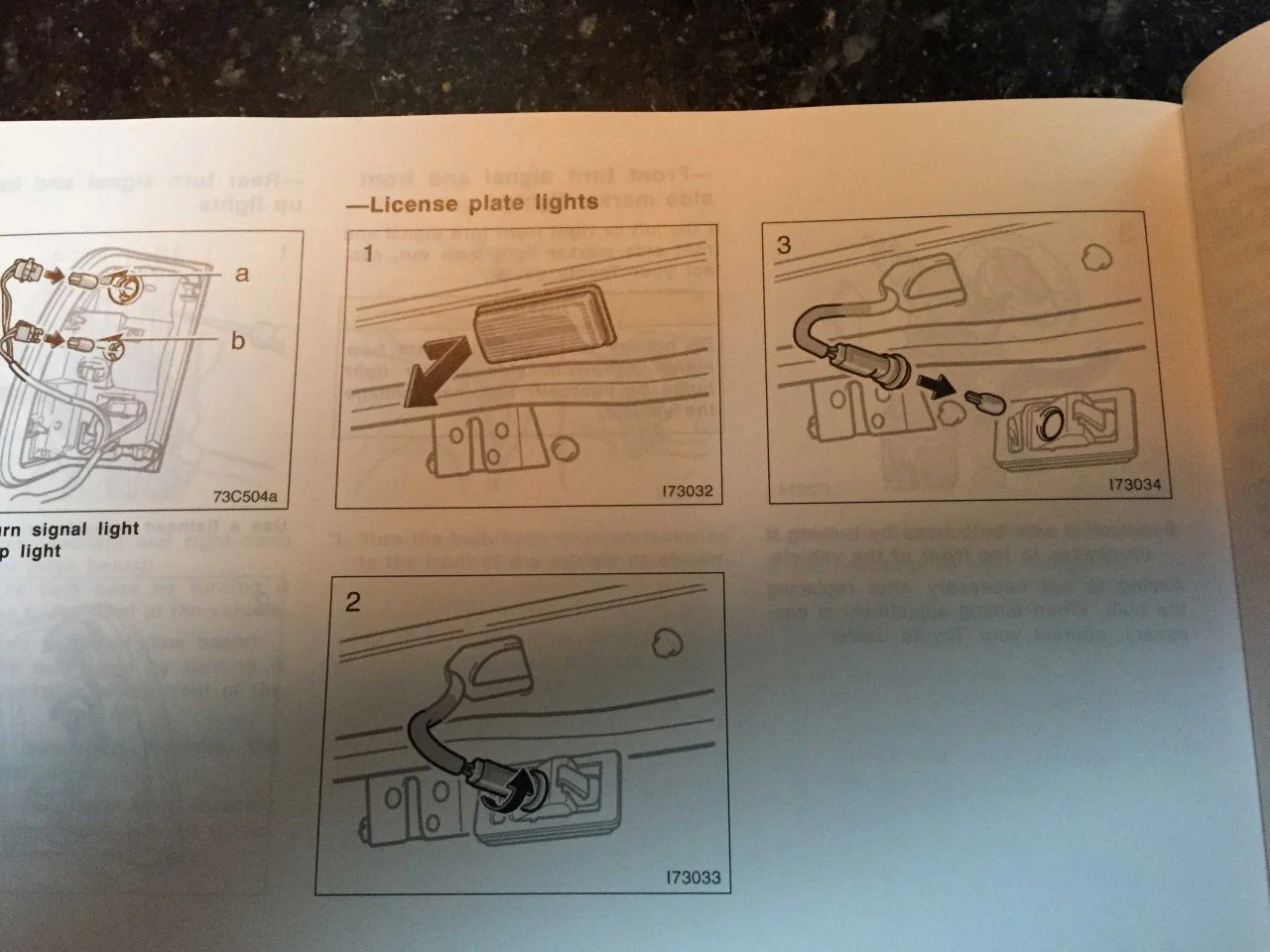

Well it certainly is in the manual....

So it's like @Pinittowinit said. Push the lens away from the camera, towards the tail lights. The lens will slide about 3/8". At the end of the slide pull the corner of the lens out to pivot the lens out of the hole in the upper tailgate.
Exactly as depicted in the manual. If only every replacement was this easy.
