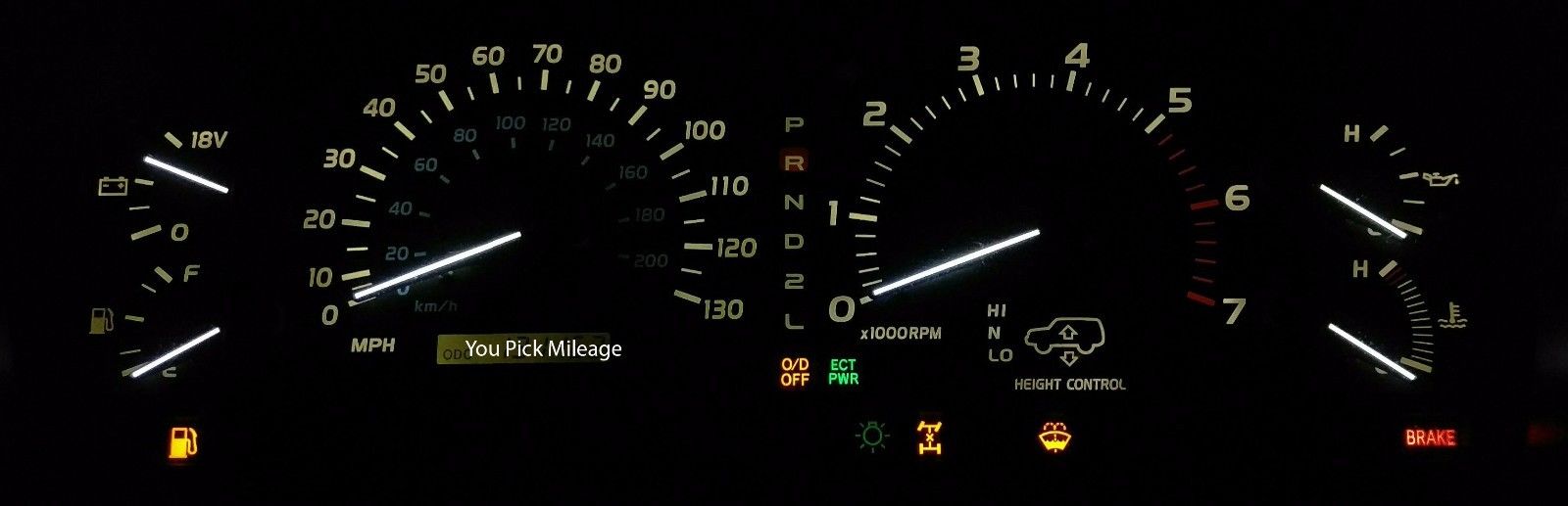

Hi Everyone
I need urgently help
i see some of sign in my cluster which turn on but not brightness , its seems with low lights which you can see in attached picture
i checked all of my wiring and connections and fuse but didnt saw any problem
is it possible my cluster board going to damage?
my car is toyota landcruiser fj100 model 2007 with 8 cylinders
