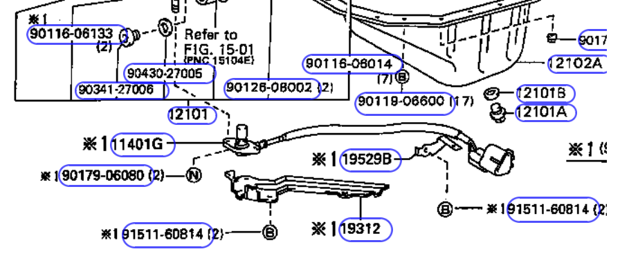

I started on my long overdue front main seal and oil pump gasket replacement tonight and noticed a lot of oil under the truck in a spot I wasn't sure about. This pic is my best attempt:
There's oil pooling at the bottom of that stud there for the coolant pipe bracket. I know the oil pump and front main seal (probably) are leaking and so am replacing those, but would that cause oil there as well? Looking at the FSM not sure what else could be going on except maybe the timing chain cover? I'd appreciate some wisdom
Additionally I can see (in this pic a little) that my crank position sensor is leaking a bit under the cover so I'll have to source some O rings for that (any advice on sourcing them without ordering would be great, or a link to some that will do the job as they aren't available from toyota).
