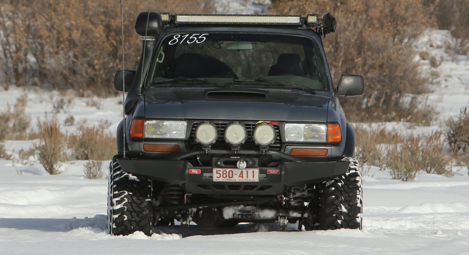

I have been using a couple lightbars from Arsenal (chinese I'm sure, bought on Amazon) for several years now and they've worked great overall. Hard to complain about the price. I paid somewhere around $100 for my 42" lightbar on my Prinsu rack. Have a 20" in the bumper. Personally I am a huge fan of HIDs which is why I still have 3 HIDs on the bumper. I haven't found a lightbar yet that can throw light as far as an HID. So I use the LEDs to light up all the close to mid-range area in front of the truck and the HIDs for way out there. Driving fast offroad at night it's nice to have an extra second to anticipate turns/obstacles. Would I be outrunning the light from the LEDs? probably not, but I've been spoiled with HIDs for a long time so I'm used to having that distance. When I use just the LEDs I'm always a little disappointed (even when I've used nice expensive ones in other trucks) because I can't see as far.
But as others have said, its difficult to justify the massive gap in price of LEDs from some companies compared to some of the chinese offerings. I'd rather put that money to something else.
Untitled by Adam Tolman, on Flickr
Here's a little video from a year or so back with my lights on. Pretty clear where the LEDs reach to and you can see the three spots of the HIDs in the distance to give you an idea of the difference in throw.

Are your three HID's spots or pencil beam or what?
Make and model?

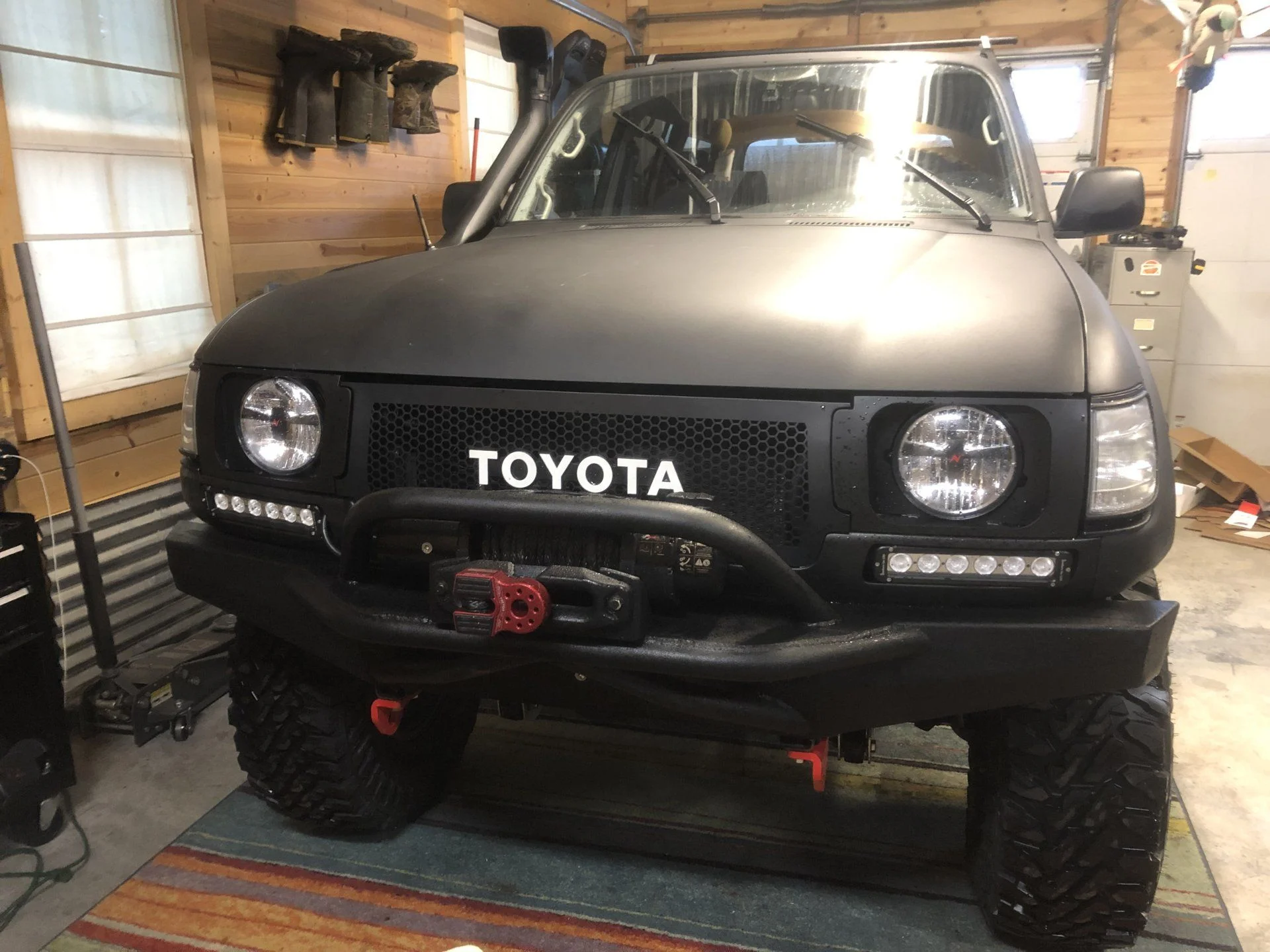

I have two of these 11" Southern lite LED Light Bar (Includes 60 Watt Single Row Light and Wiring Harness)
In place of the indicators in the valance they put out a ton of light.

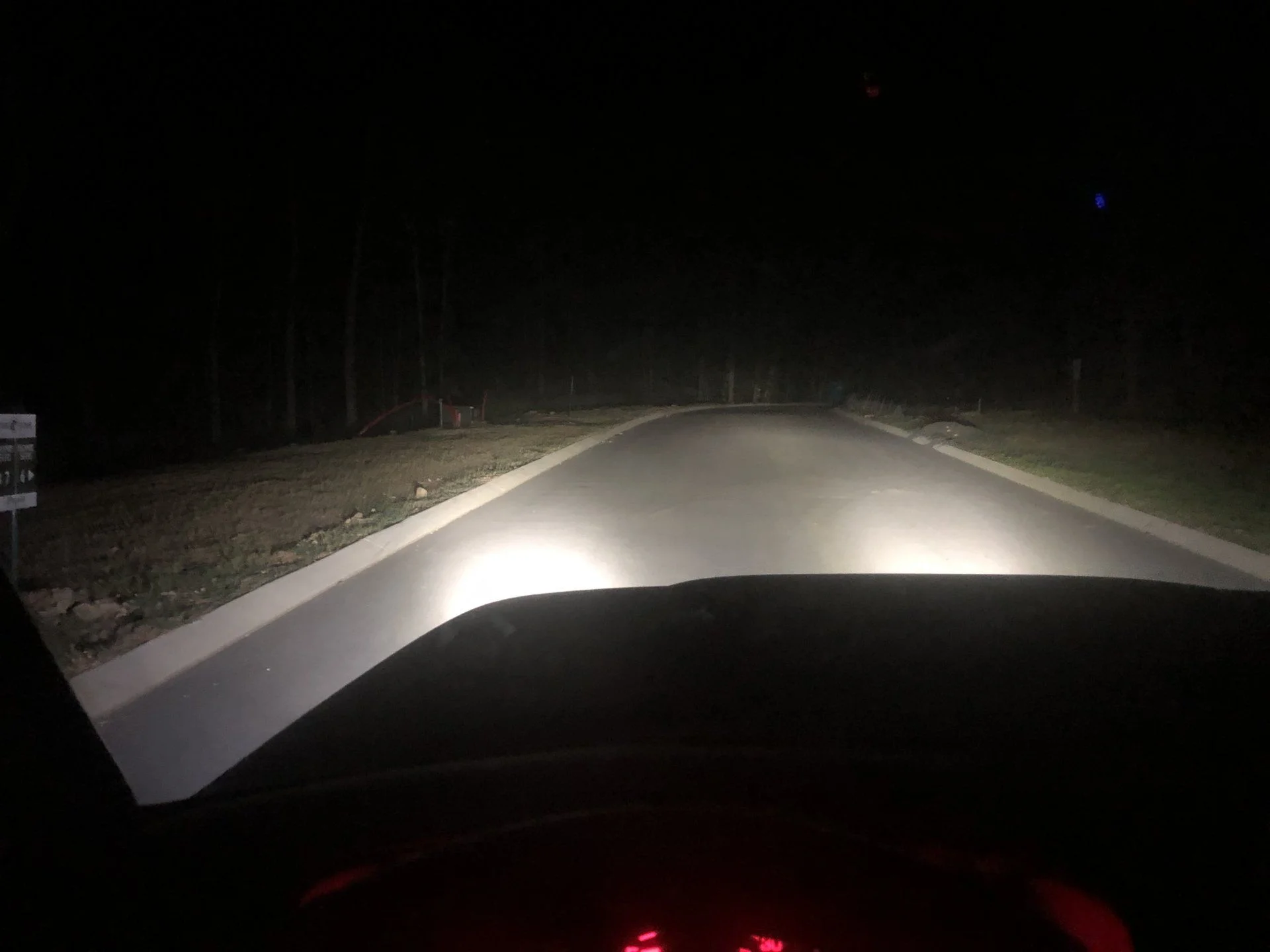

I decided to upgrade to depo lights with projectors. I can use hid or led or halogen bulbs. Im running hid bulbs right now and its great at night. I have it setup so that the low beam side is both low and hi beam. The normal hi beam side I have led fog light bulbs on a fog light switch. But if I wanted some serious distance of light I could install some high watt hid bulbs in that side. Cost me about as much as installing a light bar of high quality but I use the headlights more than I ever would a light bar. Would like to get some ditch lights.
