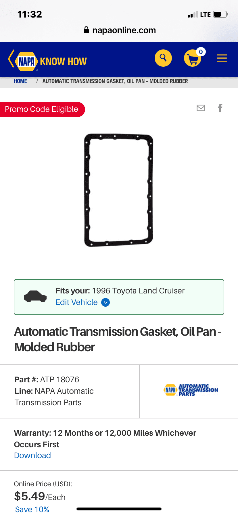

I used the grey one in green grey tube for differential. Should work on T case. Napa has a rubber gasket for the trans pan that is way easier then FIPG and in my experience reusable.
Just ordered the Napa gasket... gonna give it a shot. I didn't know one was available.
