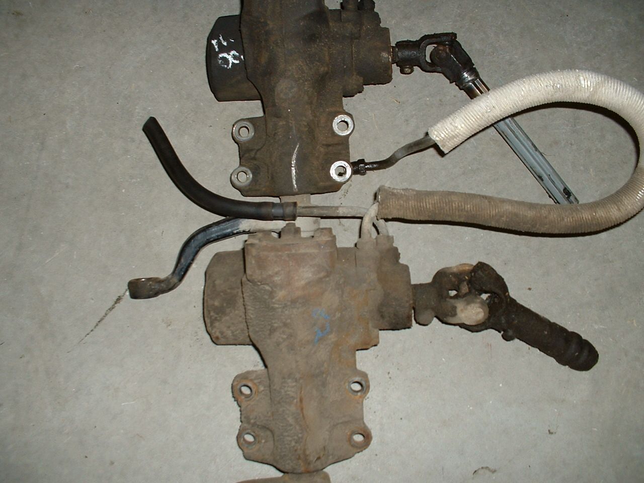

you'll have other issues with an 85 frame and an 84 running gear than just the vin.
-trans crossmember
-power steering box
can't remember if there are more differences
swapping a body is a big undertaking

easy to tell the differance in frames. the crossmember will either be a 3 piece which would bolt to the inside frame rails or it would be a 1 piece and there will be angle brackets on both the inside and outside of the frame rails to bolt the crossmember to.
PS box will either have a square bolt pattern or a parrallelagram bolt pattern pics below show the difference.
