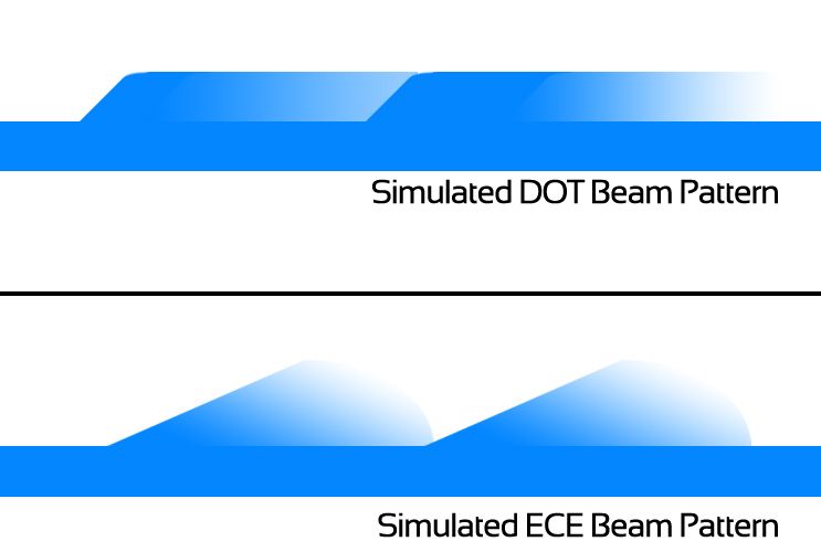

I run very nice LED bulbs in my depos and the cutoff is about 98% of what the halogens were but with far better light output. Keep in mind that depos use a European ECE LHD cutoff pattern which exacerbates the LED issue since they kick up on the right side of the pattern. So you have to aim them lower for sure. Good LED's play better in the stock US DOT housings.
