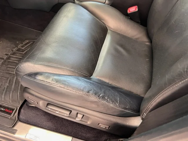

My attempt to repair the worn OEM leather seat bolster w/ 'seatdoctors' has been failed miserably. :(
The OEM leather seats are in great condition except the left lower seat area (see pic).
My local shop quoted me for $250 to just repair the left bolster area only w/ a new leather but, they said it won't be a perfect match.
The shop also quoted me $400 in labor just to replace the 2 front seats & arm rest w/ my Lseat leather covers that I ordered a while ago.
Here's my dilemma... I know OEM leather seats are quality leather and not sure replacing 2 front seats w/ Lseat would look close to OEM in both quality or look.
Other option is to keep the existing OEM seat covers and just repair the small left bottom damaged area for $250, but it will not match w/ rest of the seat.
Third option is just install Lseat leather covers by myself and save $400 in labor (already have tools and parts).
Any thoughts?
Anyone with any previous experience?
I usually like to keep my cars interior close to OEM.

I saw the samples but the color is more like 80-85% close.
The shop told me that Lexus purposely made the leather color non-standard and very hard to duplicate.
He suggested to re-dye the whole seat upon repairing but I don't really want re-dying the seat.
I replaced the bottom driver's seat on my 2013 with a replacement I got off eBay. It was $160 and matches perfectly. You might check that out and see what you think!
Thanks for the link… unfortunately, they don’t have black seat :(
How hard was the installation process?
Any special skill or tools required?
Ugh! I should have checked the color options for you . I would have thought that they offered it in all colors. The replacement was very straightforward. There are song hog rings to contend with but nothing to extravagant . I used the seat doctor dye to freshen up the door panels and the rest of the seats. All in all I believe it's taken my interior from 5 to a 8.5 with very little work. I've had this car for a few months now(traded a 05 lx470) and the previous owner was great on maintenance but their kids were hard on the interior.
Oh I see… I might give it a try. :)
It’s cheaper than what my local guy quoted me for just the small bolster repair.
Thanks OP just ordered a drivers seat lower cover replacement. :beer:
UPDATE: replacement piece was exactly like the original, they even had me send a pic of existing. Would certainly purchase again, even included new hog rings.
