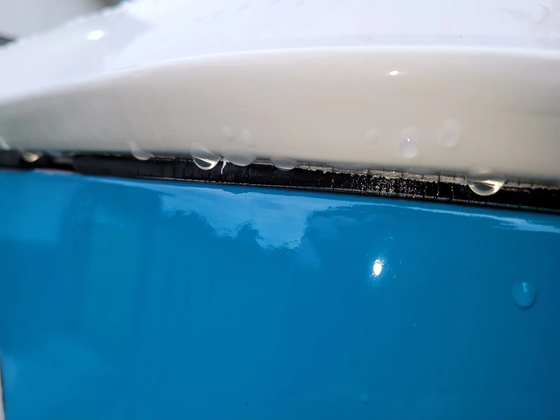

I have an old MRP fiberglass top on my '71. The gasket is missing in places and brittle. Every time it rains I have water in the vehicle, coming down from the roof. Since it is very difficult to find parts for anything earlier than '72 I thought I would caulk the roof from the inside and be done with it. I don't plan on removing the roof to go sporting around.
Is there a down side to this approach, other than making folks cringe when the word caulk is mentioned... Is there a particular sealer that works best?

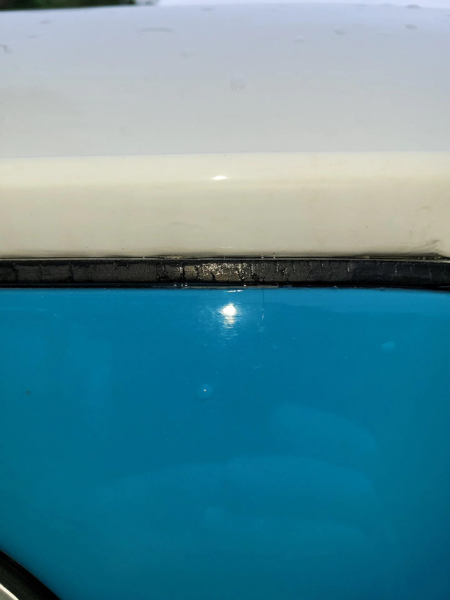

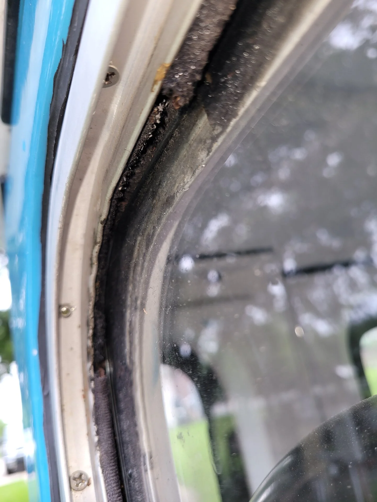

Gaps in roof gasket on both sides, near doors and rear windows. Gasket is dried and splitting. Also noticed the gasket that the sliding rear window goes in is shot... any recommendations?
Your biggest problem here is that none of these seals appear to be OEM Toyota top seals. The other problem is the top manufacture is no longer in business so obtaining original seals is not going to happen. There are companies that produce rubber seals, you're just going to need to provide them the profile of your existing seals to see if they have a match or one that is close enough to work.

That is why I'm considering caulking the seam from the inside...
I just looked up the roof drip molding/packing for '71 - part number is 63168-60011 ( here). It is superseded with part 63168-90307 and that is available OEM. I got mine from Lewis Toyota Nov 2022 - Toyota changed their parts website last week (and I have a rant about that on MUD). Point is still is available for 300+.

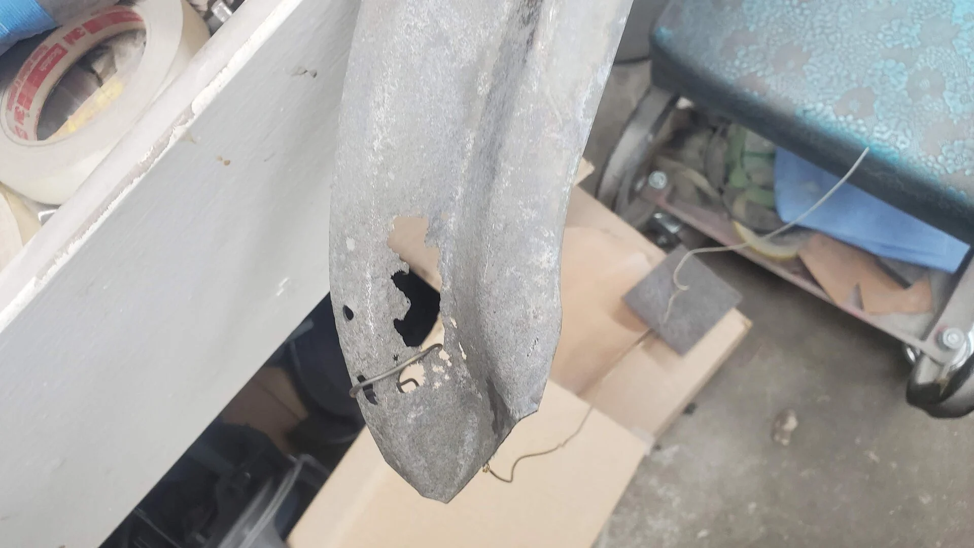

I would not seal it from the inside if it were me. Water will still penetrate and rust whatever it runs down, pillar supports, barn door frame, etc. Just my opinion and experience. My roof was leaking like yours and I took mine off a couple months ago to find some rust. Not horrible, but I never heard rust fixing itself. So I'm in the process of addressing the rust. You're in TX so that could be different ball game than north of you.
Even to open it up and put a rust neutralizer (IE Rust Convert) to slow it way down and slap new rubber would be better than locking sealing from the inside. Again, just one yahoo's opinion.

To extend - this is what I found after I decide to take the roof off and put new rubber down- and this wasn't where it was leaking - nor did I have any idea it was there rotting away.
Thanks for the insight. I guess it comes down to doing it right ...
Any recommendations on the sliding window trim? That gasket is pretty much gone. I don't see very many photos with sliding windows so I assume that replacement will be really hard to find.
