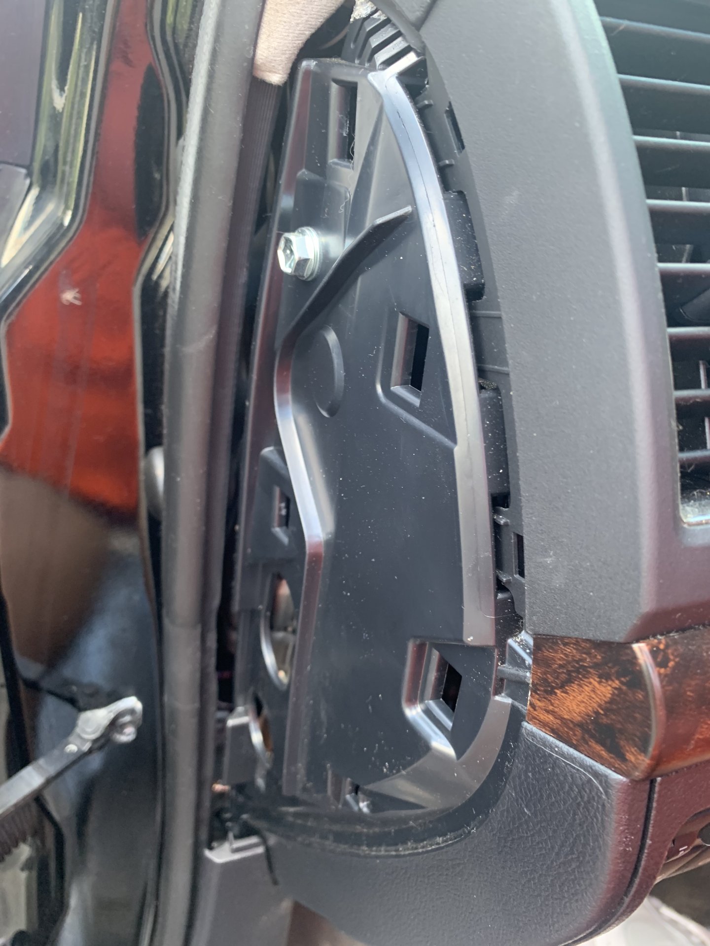

Can’t find it for the life of me. Removed the plastic cover by the pedals and didn’t see it.
Removed the panel by the dot and didn’t see it. Maybe I’m just blind but the owners manual isn’t helping either. It just says remove the lid.
I need to change the cigarette lighter fuse so I can put a charger in my car.
Any help would be greatly appreciated.
2013 Toyota Land Cruiser
Left hand or right hand driver side? Australian 200’s have a driver side on the right.
Two screws to remove the horizontal black plastic with the obdii port and the tire pressure reset in it.
Fuse box on the left of car, behind the hood and fuel releases
Thanks guys I found it like you where you said it was.
I was able to check the fuses and they are still good. Number 1 slot 15amp charge.

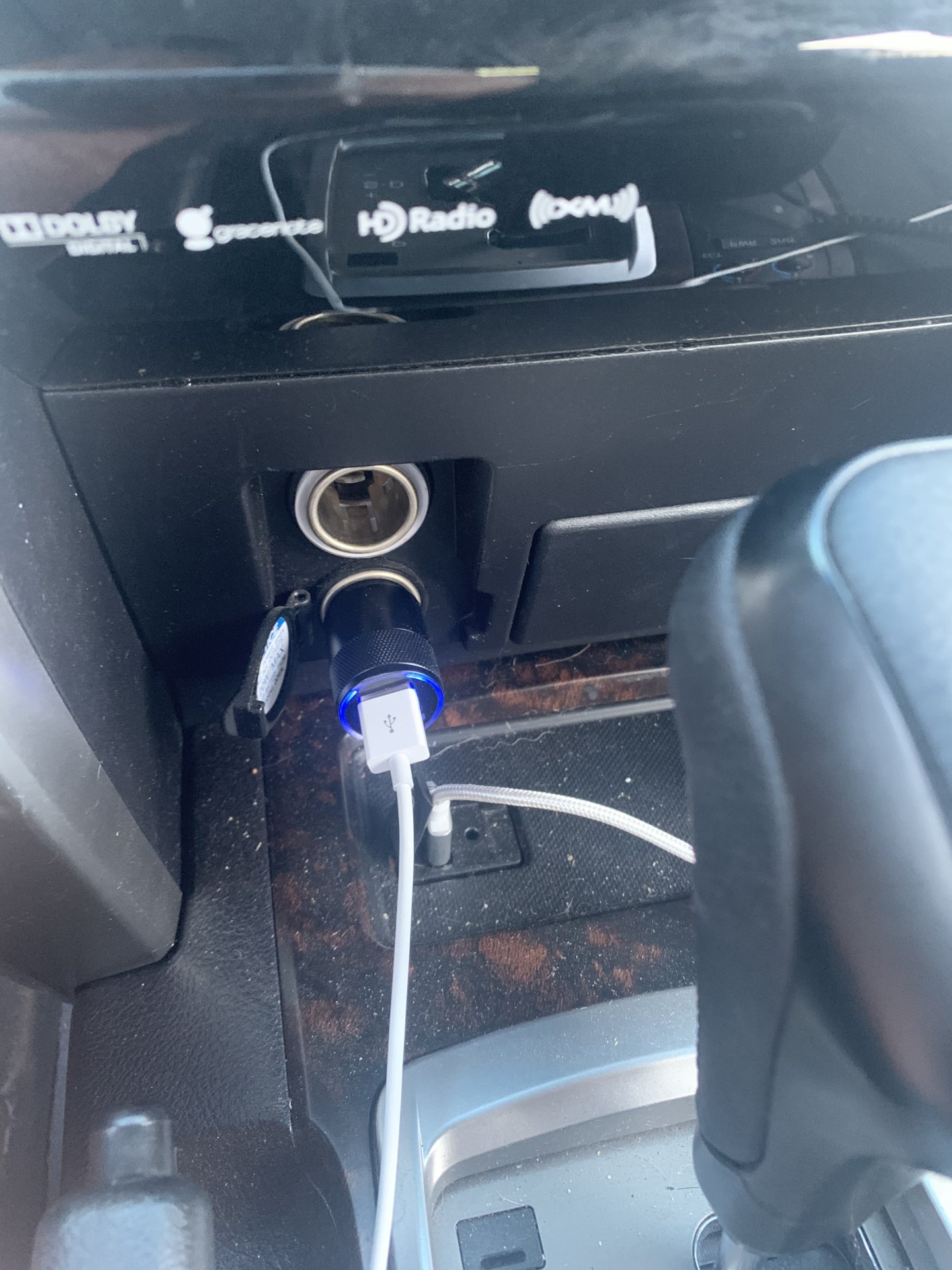

However only one of my ports work. The bottom port works while the top one doesn’t?
