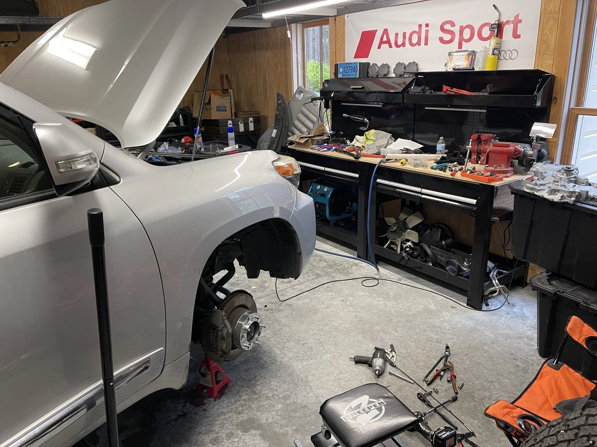

I'm somewhat mechanically inclined but have very little hands-on experience with auto mechanics. Knowing this, I (some might say stupidly) decided to take it on myself to do the work Toyota Service told me about on my 90K mile 2014 Land Cruiser. It ended up being almost more than I bargained for.
Issues Toyota Service Told Me about: Cracked radiator - needed replacement. They recommended also - That I replace the water pump and the tensioner pulley. My trying this job myself, and breaking several things in the process - here is where my journey took me:

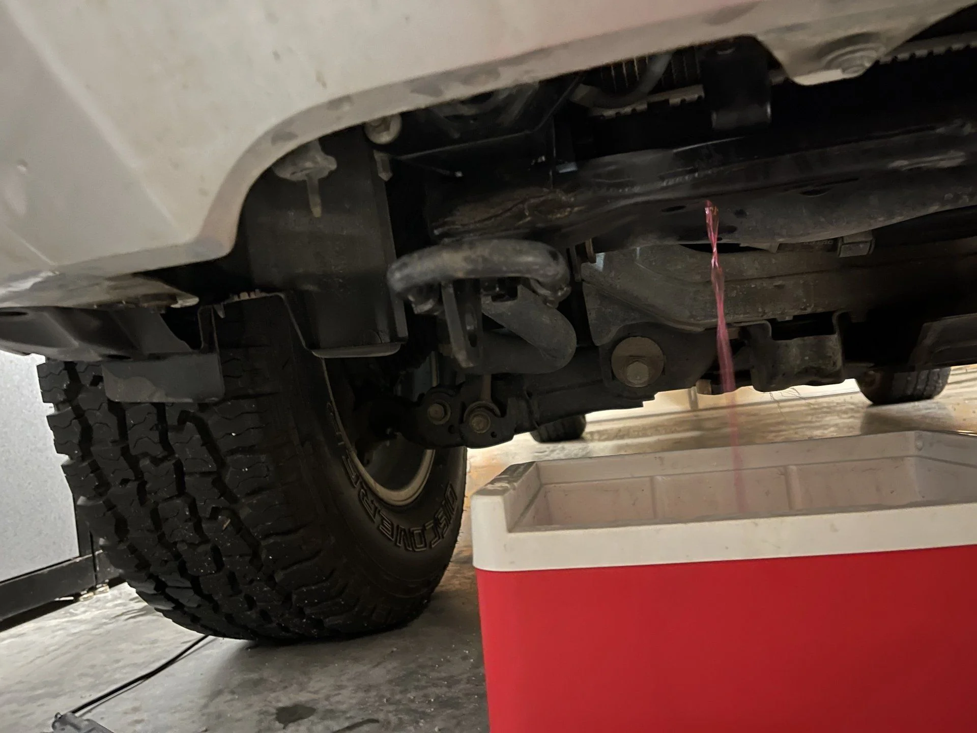

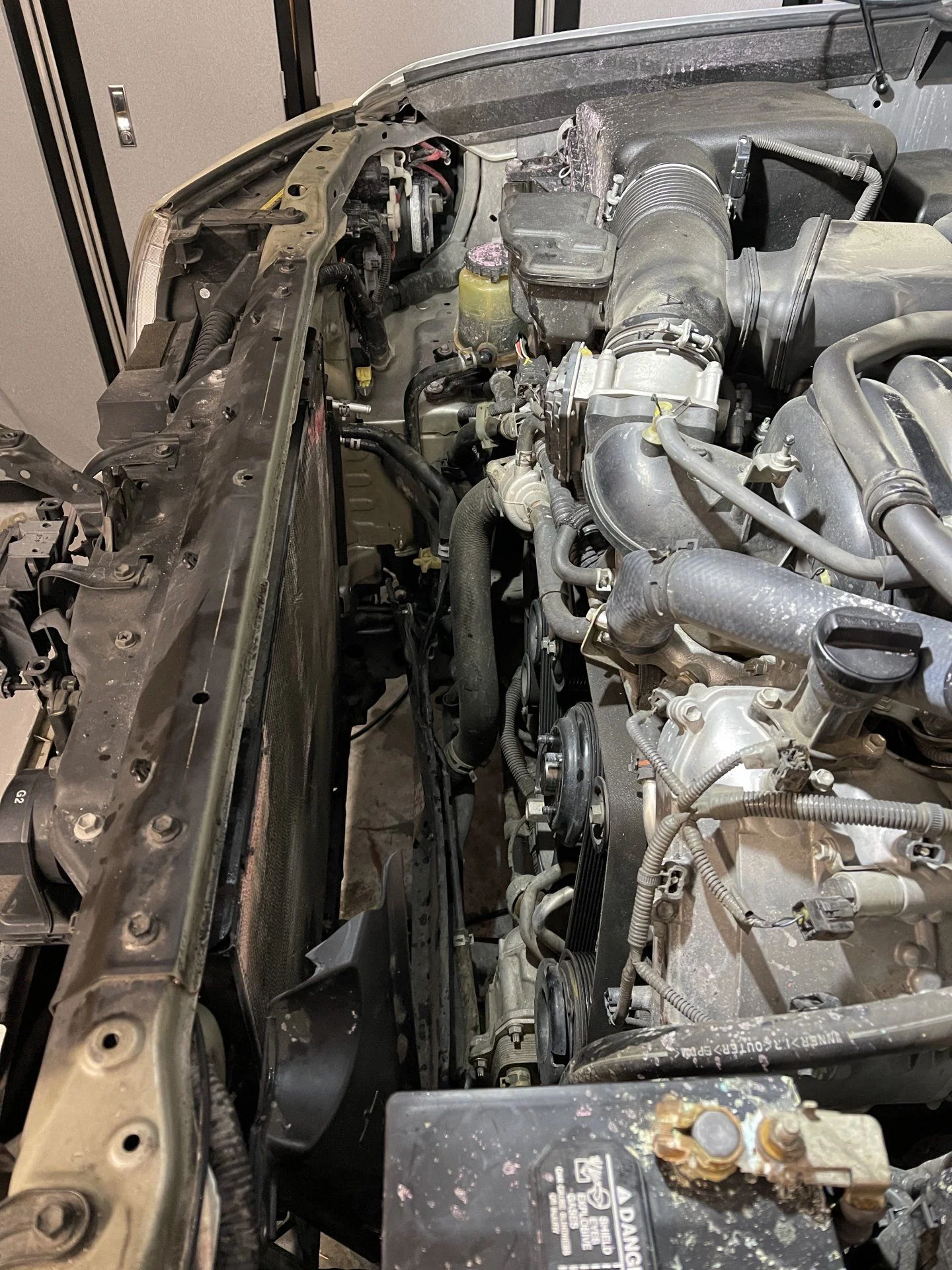

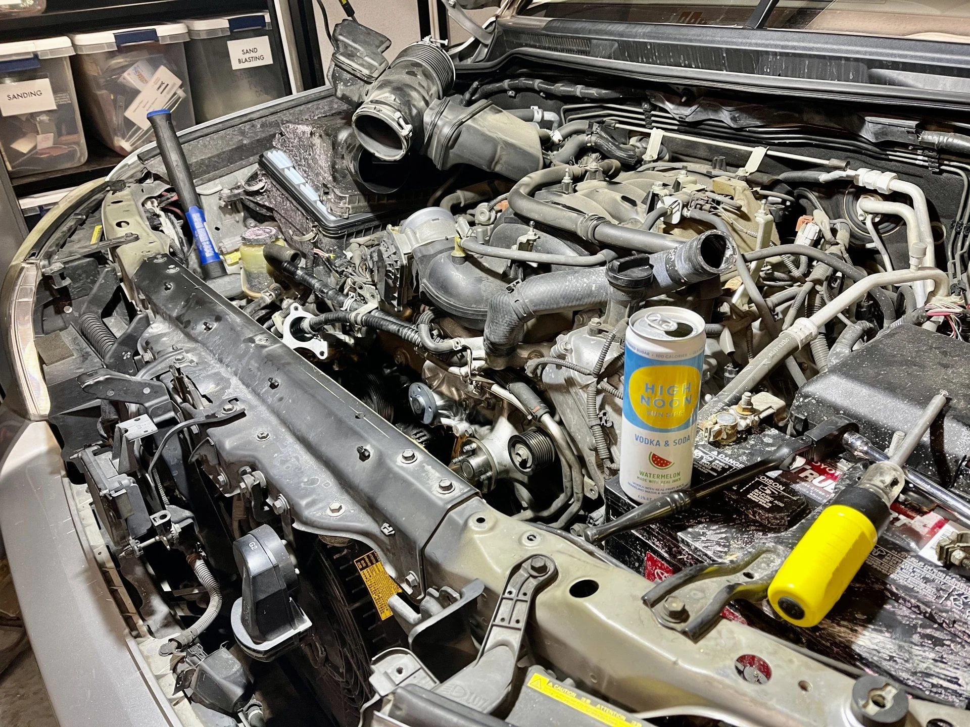

The radiator had the typical fault - hairline crack that had sprayed coolant in the entire engine bay. I'm glad I had service scheduled because I hadn't noticed. Ordering the radiator, water pump and tensioner pulley was all I had on my list. And that's when it became more involved.
My Mistakes:
1. Underestimating the time it would take me. Big time.
2. Believing I had all the right tools. (I did not - I do now)
3. Broke the fan shroud trying to yank it out with the radiator.

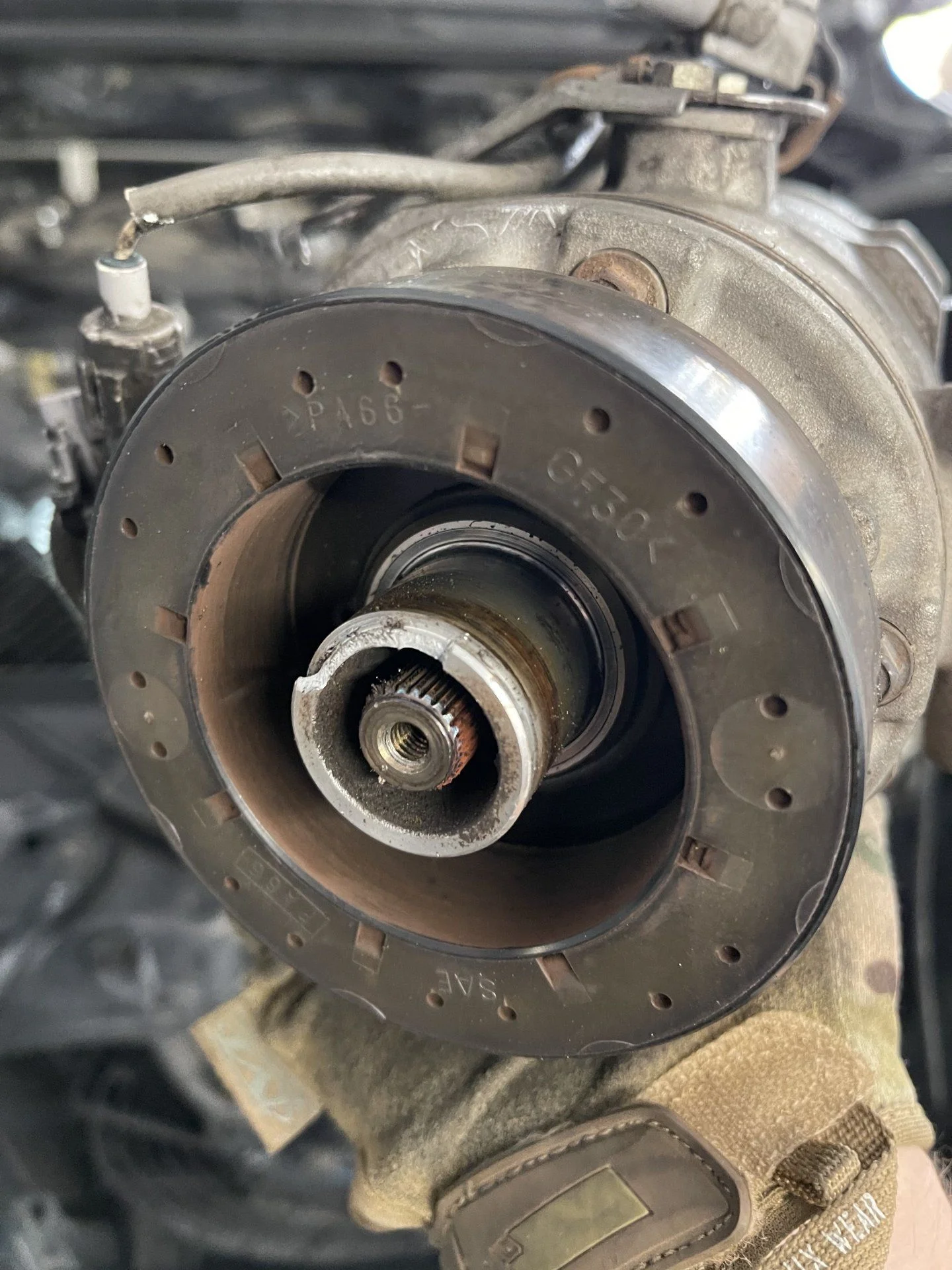

4. While trying to get to the water pump - I was trying to loosen the metal oil hoses - there is a small bolt that is hard to get to next to the AC Compressor. While trying to loosen it, I decided to tryand get the pulley off - and didn't have pin pliers. I tried to yank the ring out and snapped off the end of the nose of the compressor. No way to fix it. So new compressor, new freon charge for a stupid mistake.

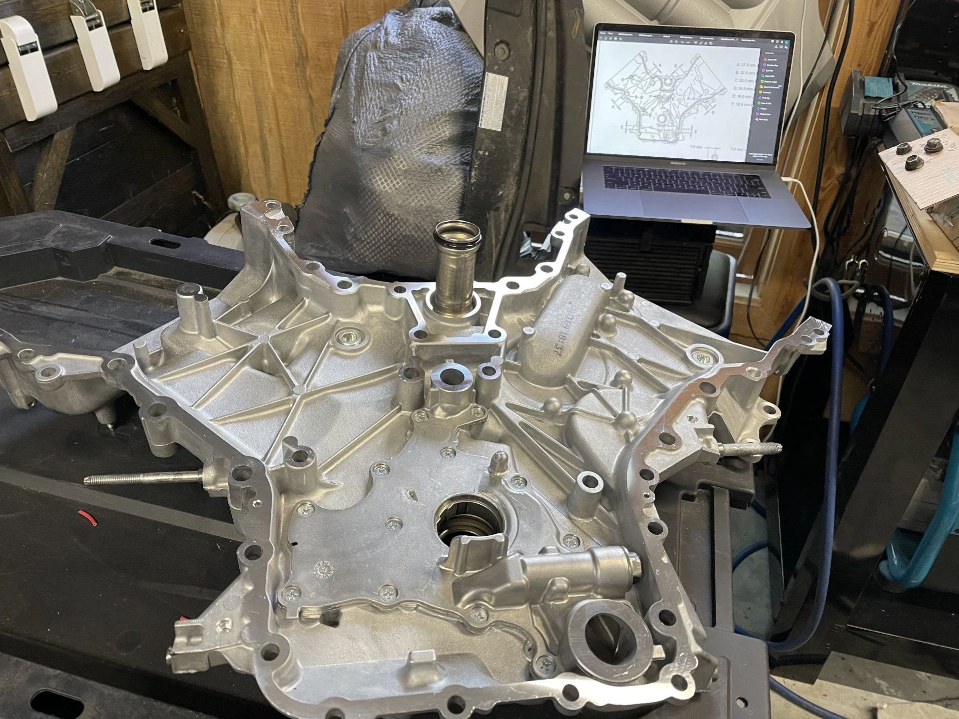

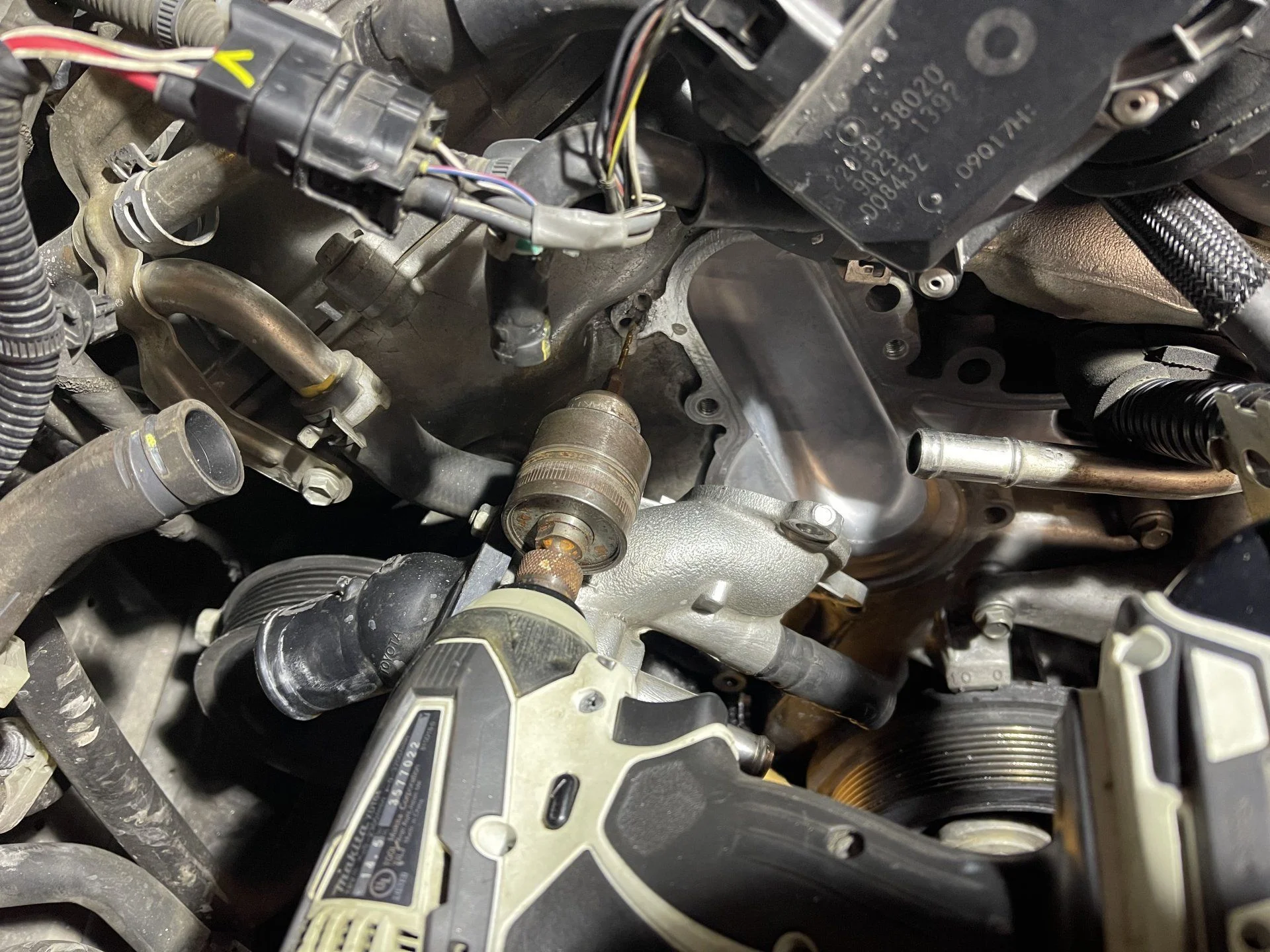

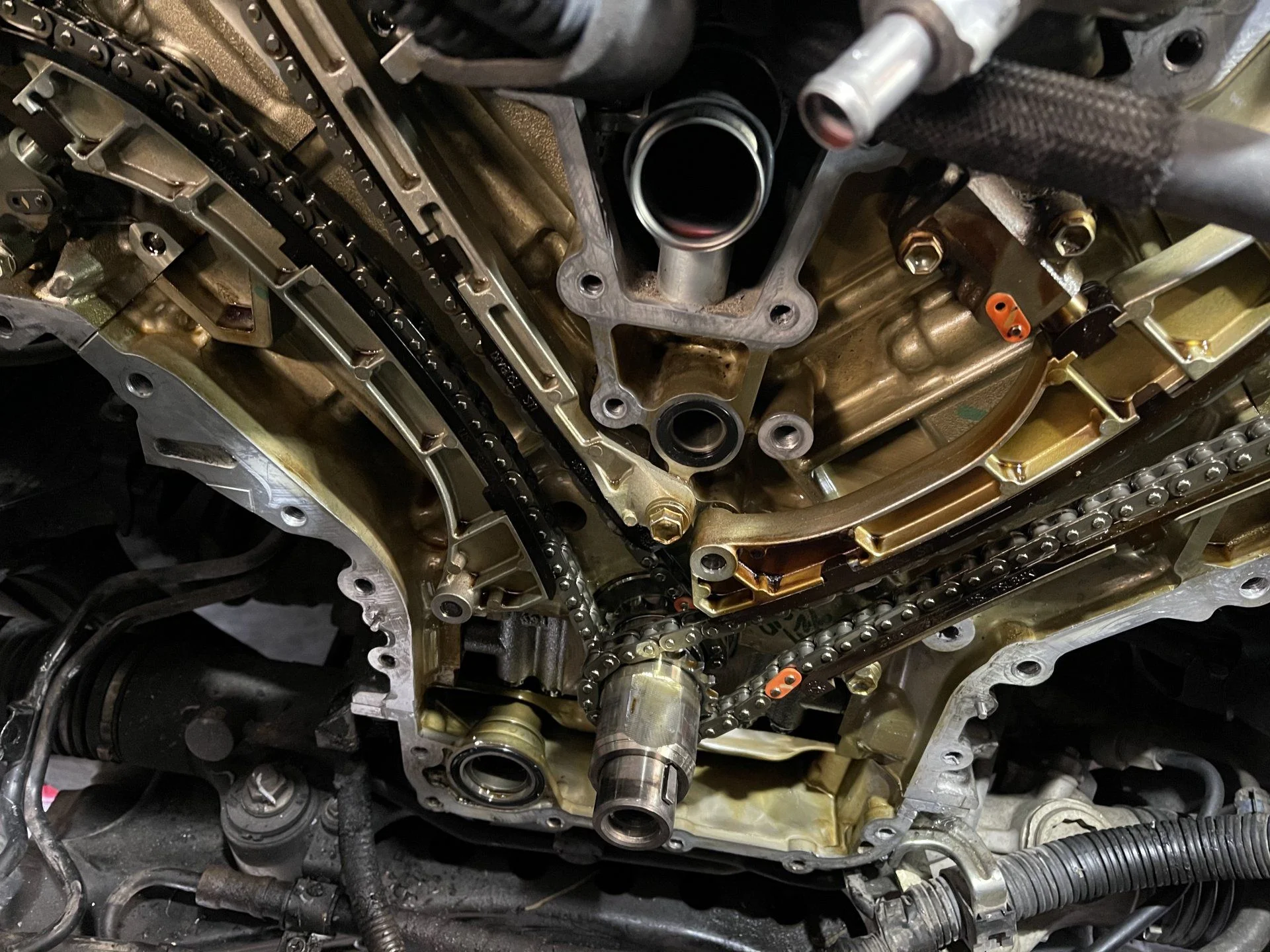

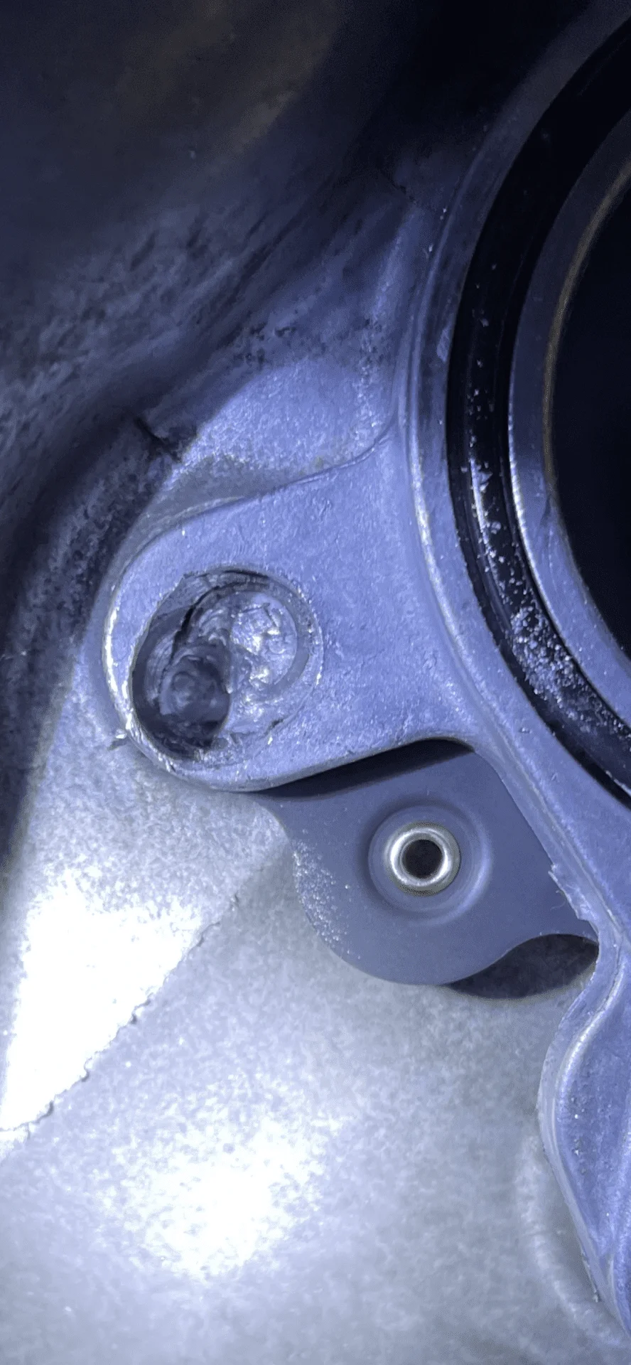

5. While installing the water pump, I thought I had the torque wrench set properly (first time using a torque wrench). I did not. I snapped a flange bolt off inside the timing chain cover - one of the 3 bolts on the water housing inlet on the water pump. Extraction attempts didn't work after HOURS of trying. The hardened steel bolt next to the soft aluminum was very difficult to work with. I ended up slipping the bit past the broken bolt and drilling a hole into the timing chain cover through to the timing chain area. Not knowing what to do, I decided to patch the area with metal filler and seal with RTV. Have one less bolt and hope for the best. I reassembled everything. The truck started up after a few sputters....and then was driving ok I thought. Drove 7 miles watching the temp gauge. Then it climbed to the red level and I stopped and saw A LOT of coolant leaking out from the water pump area. Crap. Limped home to the garage. Reviewed the FSM in detail and a lot of Youtube videos. Rather than have it towed to someone who knows what they are doing - I doubled down. Ordered a new Timing chain cover, all the seals, etc. Bought the right tools, studied a bunch and went to work.
6. Stripped a bolt hole in the NEW timing chain cover when I reinstalled some new bolts in the water housing inlet - with air ratchet. Only meant to get it close and then use torque wrench but got too close! It went soft and just turned. Pulled out bolt and it has aluminum on the threads. CRUD. So I drilled and tapped the hole and used a helicoil with red threadlocker and it worked perfectly. No issue getting to torque spec.

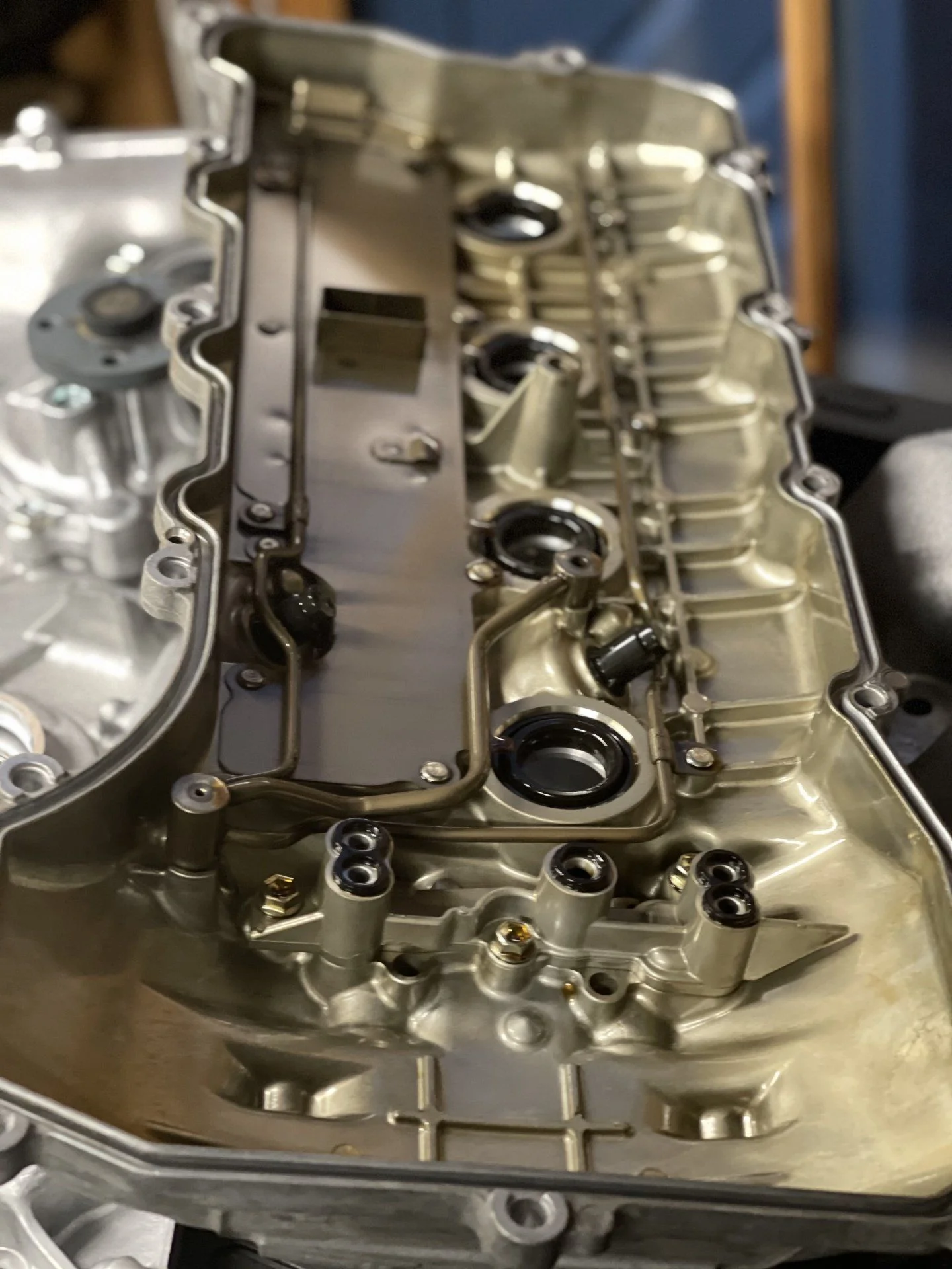

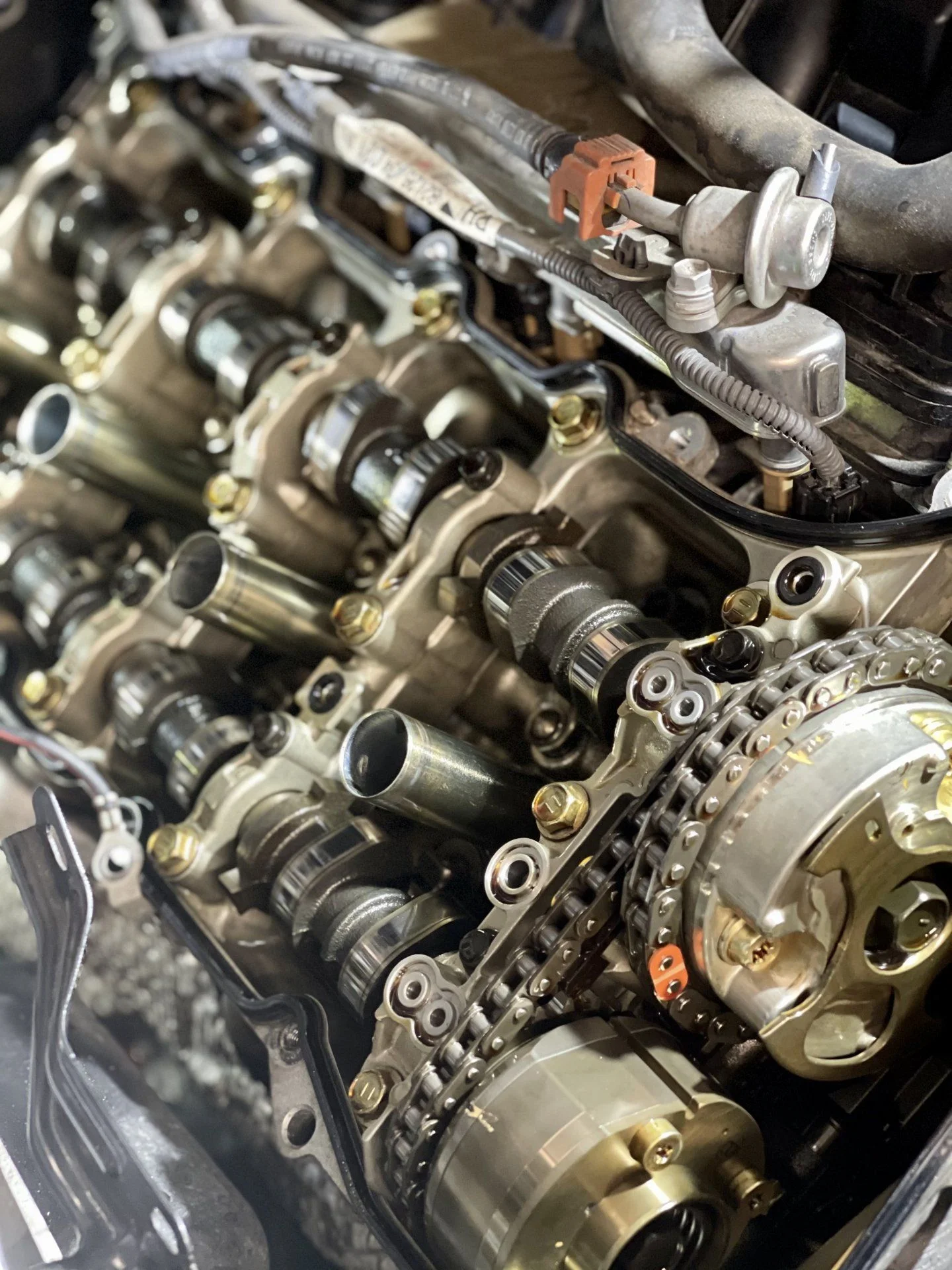

8. When reinstalling the valve cover gaskets I did not set them with sealant - this is not done at factory but some recommend it. The gasket sits inside a groove in the cover. While reinstalling one of them - I must not have seen it but the gasket came loose in the back out of sight. When tightening the bolts - the gasket was cut in the rear. Not knowing this - I got everything put together - car started fine - major oil leak from rear of engine cover. I saw my mistake, ordered all new seals and gaskets, and set and installed properly.

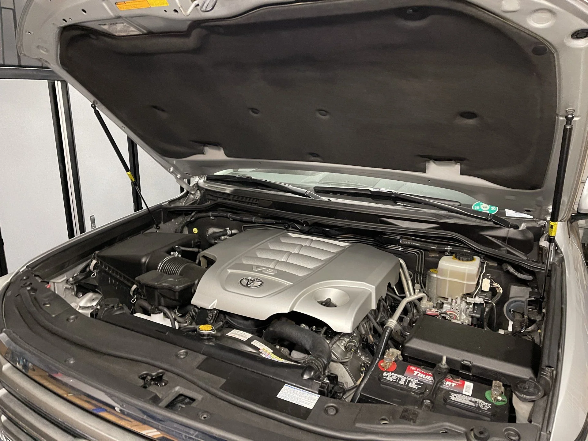

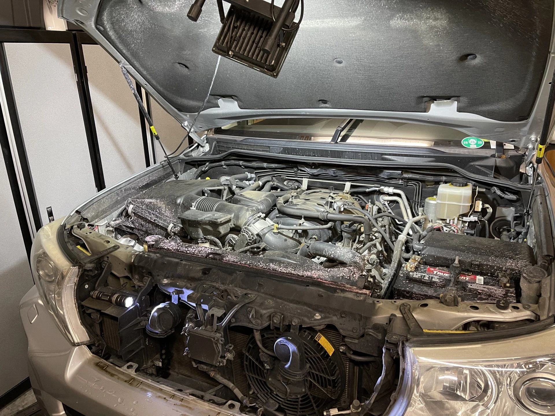

Fully detailed and degreased the engine compartment. Have about 100 miles in and the truck is running as good as ever. Level temperatures, coolant and oil levels, and no error lights. It was a big job, made much bigger from my lack of experience and 'bull in a china shop" way of doing things sometimes.
