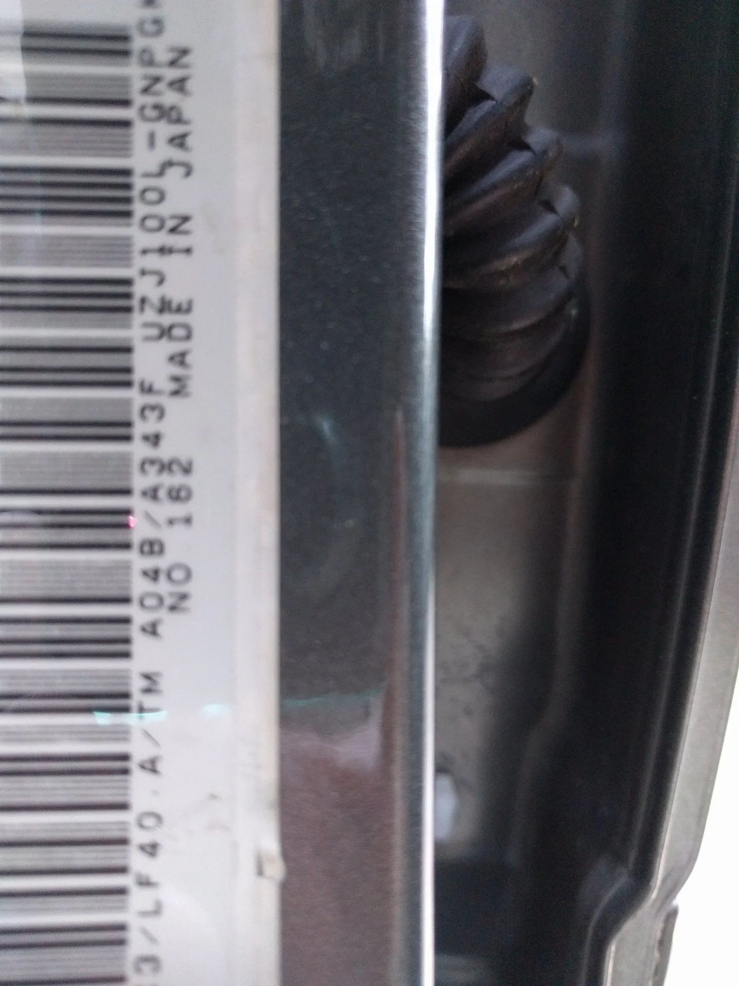

Trying to know if my 1999 LC 100 has LSD or not.
- Jacked the car, put in neutral and tried to rotate one tyre. The other tyre did not move b/c it is a 4wd all time.
- On the plate where vin # tans/axle details are =>
Have the following:
Trans/Axle: A442F A04B
Did some searches 4 means 4.56R&P
LC ENGINEERING Differential Tech
A means two pinion open Diff.
Can someone help with above and let me know what letter would mean if there is an LSD or not ?

Apparently I was all sorts of wrong. My 98 US LX has your same door tag, A04B, the rear is labeled LSD and I thought all 98-02 US trucks were 4.30 geared.
Original:
Get in some dirt and lay into it.
You are right, the second A would mean 2 pinion open, not LSD.
First digit: A=7.5" ring gear
Second/third: 04=4.56 ratio
Fourth: B=4 pinion Open=not LSD
Alternative fourth: C=2 pinion LSD
PS. Where are you and where is the truck from?

Hi There
Truck is overseas in Lebanon. We bought it used..... not sure if it came used from US or GCC spec.
This LC 100 has strangely an AHC system.
Does the axle A04B => Seems B stands for 4 pinion open diff.

OK if not US spec....it could have anything in it.
But Toyota would use one universal code for axle ratio....
Is letter "C" ending means LSD ?
Can't say definitively what Toyota used for Axle Codes. My '99 LX470 has 4.30 gears is LSD and has a code of A04B

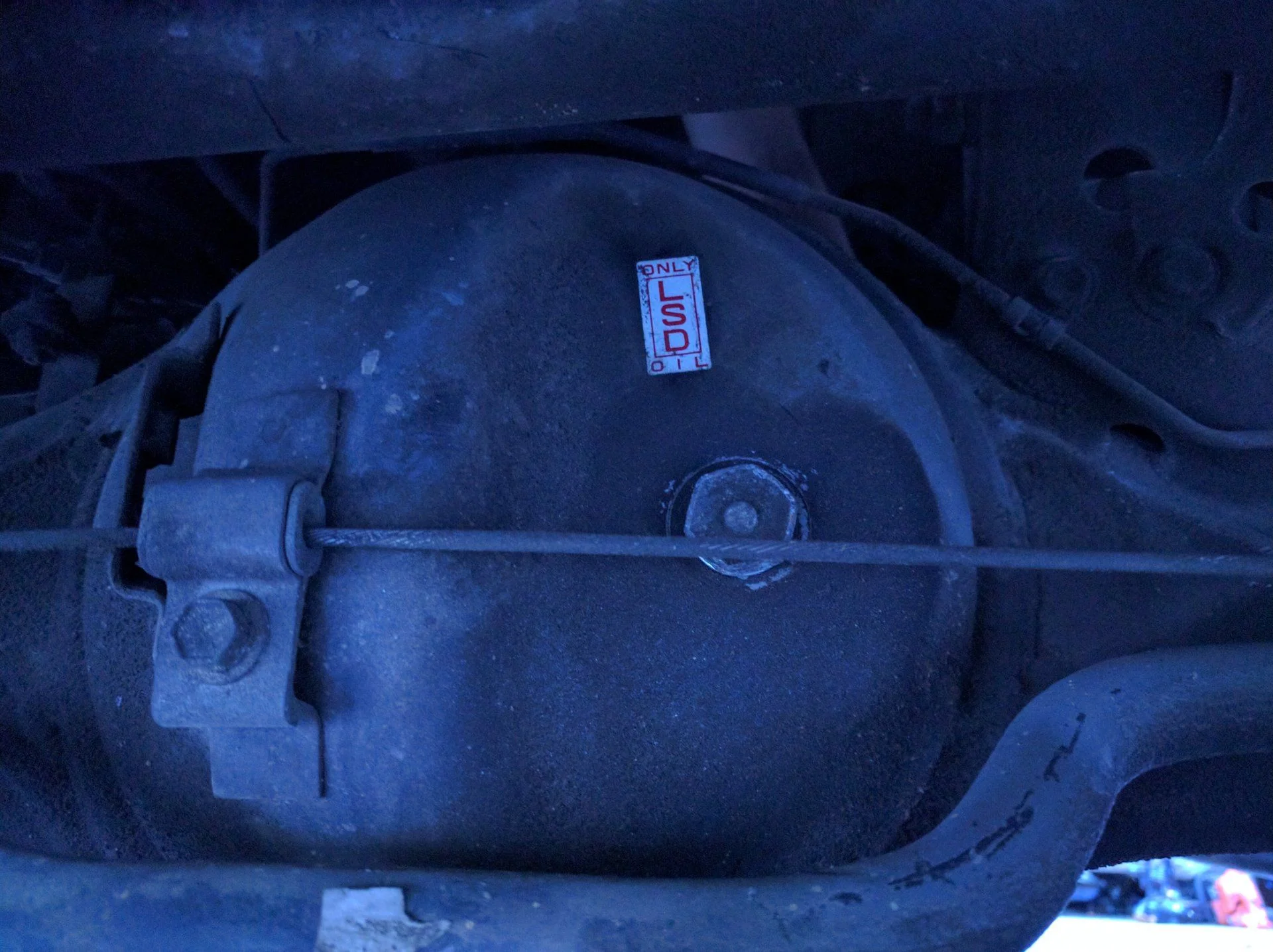

If the vehicle is drive-able....I'd just find a place with a soft surface and 'floor it'. IF you have a (working) LSD you'll have your answer (both tires will spin).
Hey
Was able to find that " LSD Oil" sticker on the rear diff....so I have an LSD despite axle code being A04B.
Looking to change oil in the diffs:
Found Castrol Syntrax Limited Slip 75W-140 => Is this OK or 80W90 needed for limited slip ?
Also truck diff gear oil has never been changed. I am running 285 75 16 BFG KO2( older model date 2008 but still OK)....on deceleration I do hear slight hum/wind noise.... could this be from the tyres ?
Some people reported diff noise after gear oil change => Any opinions ?
